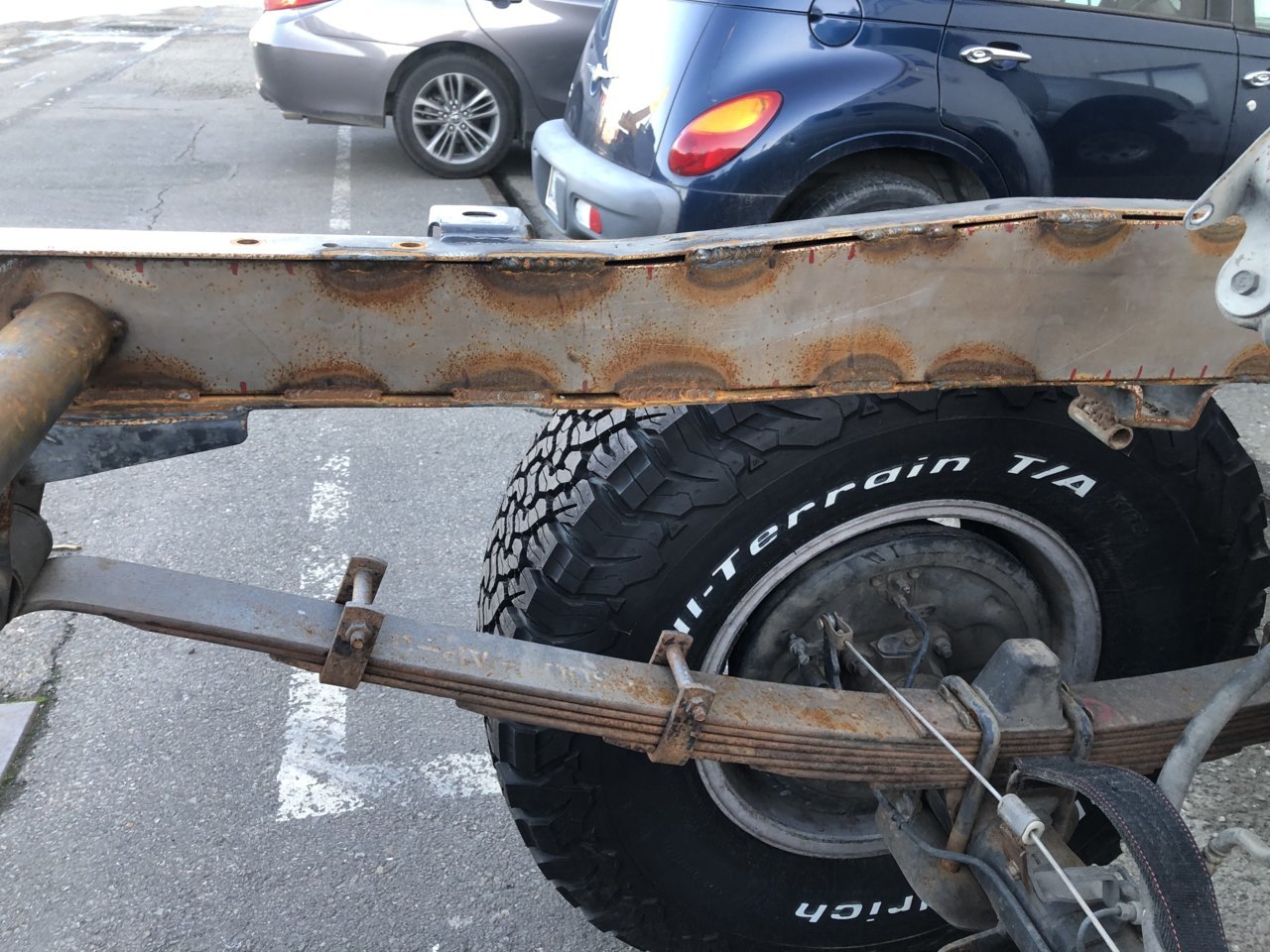

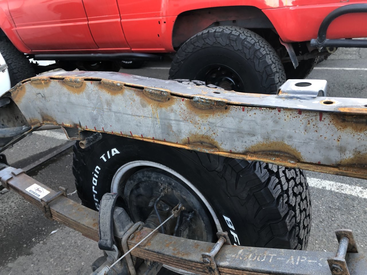

    I'm just an engineer and a hack welder, but two immediate comments:
    1) You need drains in that frame boxing. Otherwise it will fill with water/mud and rot from the inside. There is a reason toyota made these frame "C" channel instead of boxed. Look at the way rock rings have drains to get an idea of what I'm talking about.
    2) That's not a problem now, but without cleaning it all off, then treating with a rust converter, then priming and painting it will be a total clusterfuck in a few years.
    Bonus thought: someone is going to have a shitty afternoon with a sand blaster making this right.

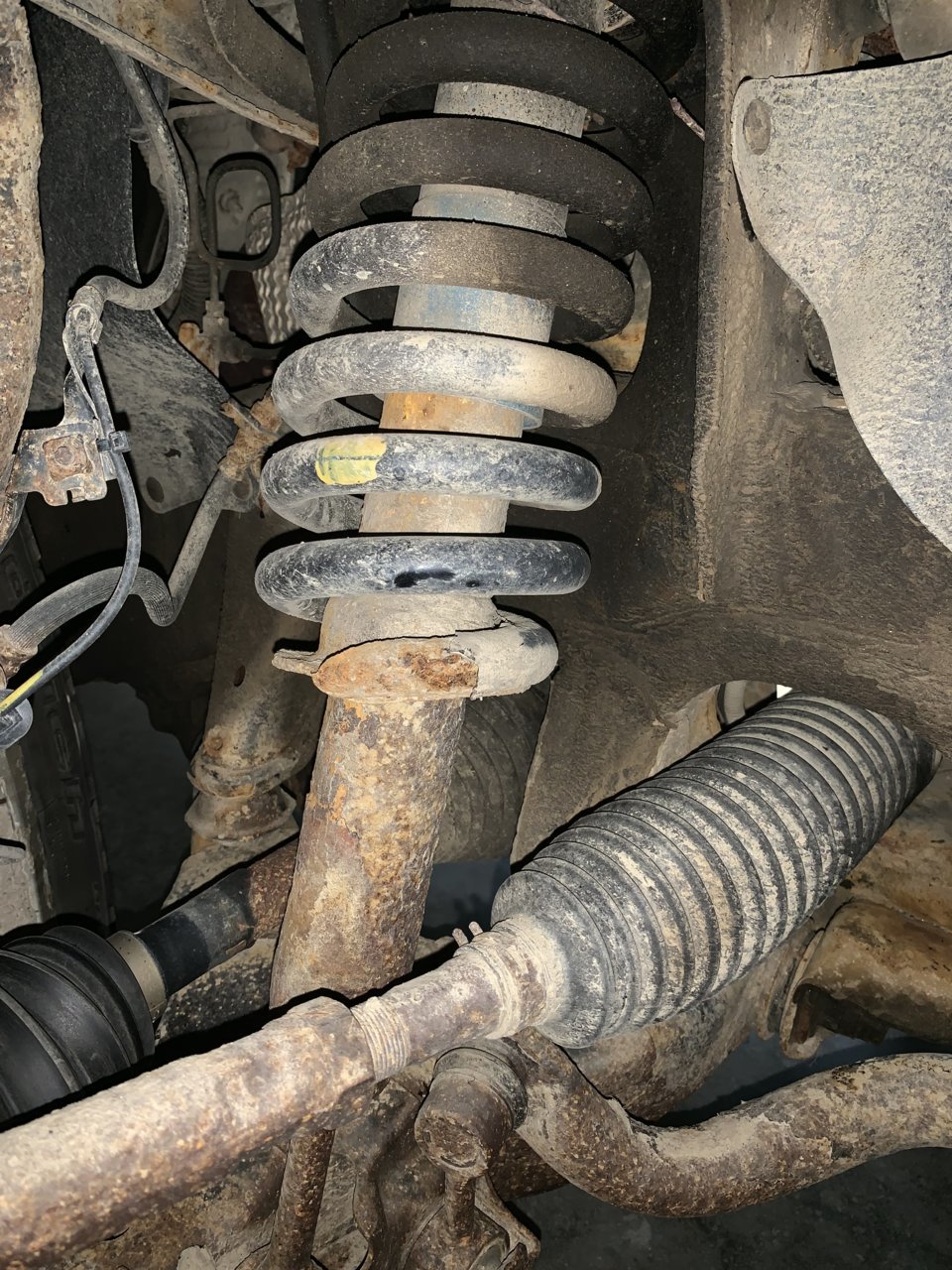

    You're most likely just going to have to to finish the welding after wire wheeling it - you want to see real rust here's some real rust haha - 08 springs on a truck in Maine. I almost said the stealership was telling a tall tale when my dad told me they told him the coilovers "broke"
    Even coastal California doesn't have significant issues. My truck was one of the worst CA trucks I ever came across (from Sac). Nothing like the rust belt thankfully. That said, being preventative is always smart of course.
