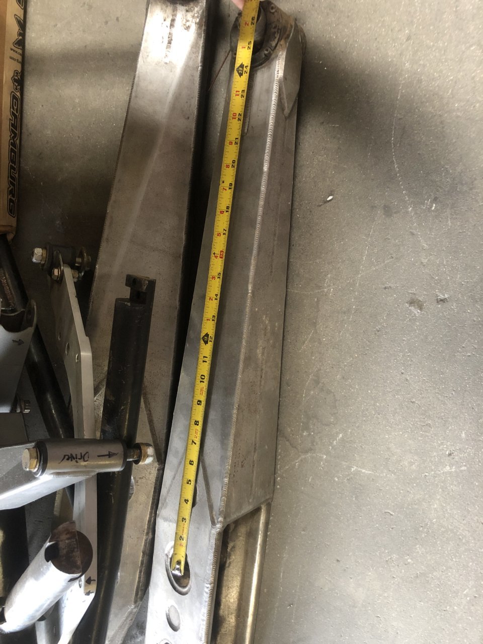

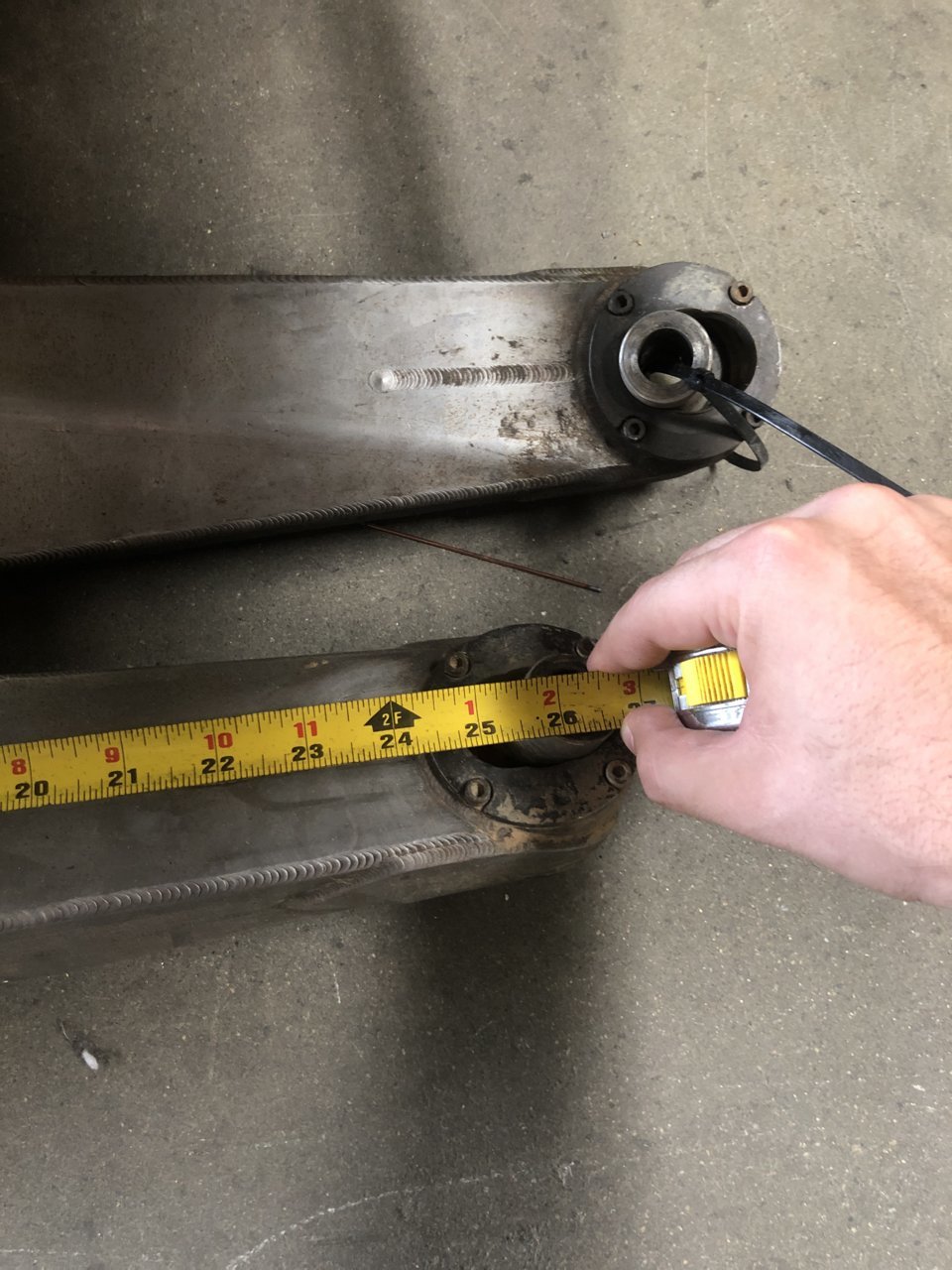

    How long are those?

    48”

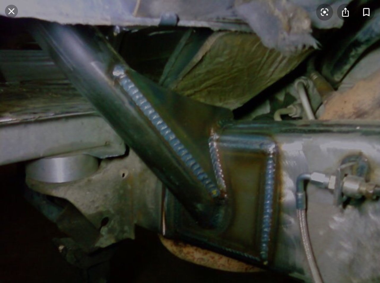

    Ok, so to whomever has their Tacoma roll caged per score/bitd specs.
    How does the cage weld to the frame?
    Caboose117 likes this.

    Mine isn’t race spec, but I welded 3/16” plate to the frame. Then butt welded the cage to that plate. Last I added a gusset from the tube to the frame.
    Not mine, but I went with this approach.

    Seen it, racedezert I think.

    Yup yup, that pic been around. Most trucks I’ve seen done like this.
