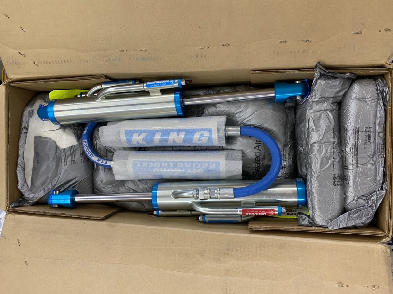

    Now how the hell did that get there.

    those front or rears?

    Front. Already have rears.
