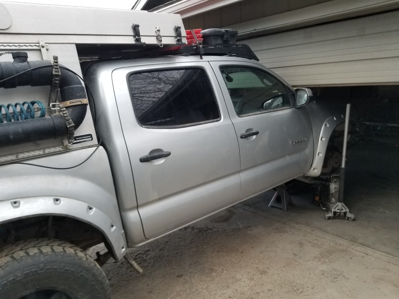

    @excorcist you could just drill out the taper on the steering knuckle and use a 5/8 bolt with regular misalignment spacers from kartek.

    Shouldn’t be hitting. What are your alignment specs?

    I’d have them bump up the castor to closer to 4.5 and see if that clears it.

    Yeah you were barely hitting if you couldn’t feel it when driving. More castor will also benefit you off road and help the truck track straighter.

    Agree with all that expect price is not normal, that would mean the full kit (4 misalignments and 2 bolts) would be like $250. The $35 originally quoted does make sense.

    As far as misalignments go, they're so damn soft, its really easy to torque down a bolt too early and catch the lip of the misalignment. I think Chris at bbm made me one for $20 when I was in a bind but Im not sure if he's still running his shop.

    Mine rubs barely on just one side with a TC +2 kit, i think my caster numbers are like 3.9 and 4.1 or something along those lines. the 3.9 side is the one that rubs. Other side seems fine but when i redo the alignment i will probably bump up to 4.5
