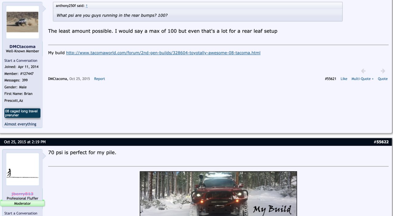

    What's the usual PSI for bumpstops?

    150 and adjust from there

    Bump stops are just an air shock. You can adjust pressure significantly to "tune" the harshness and keep the function of the shock. 150-200 PSI is what comes standard for most manufacturers but I've seen as low as 50-100psi for certain applications.

    Yep I think I’m around 70-80 after adjusting it a few times
