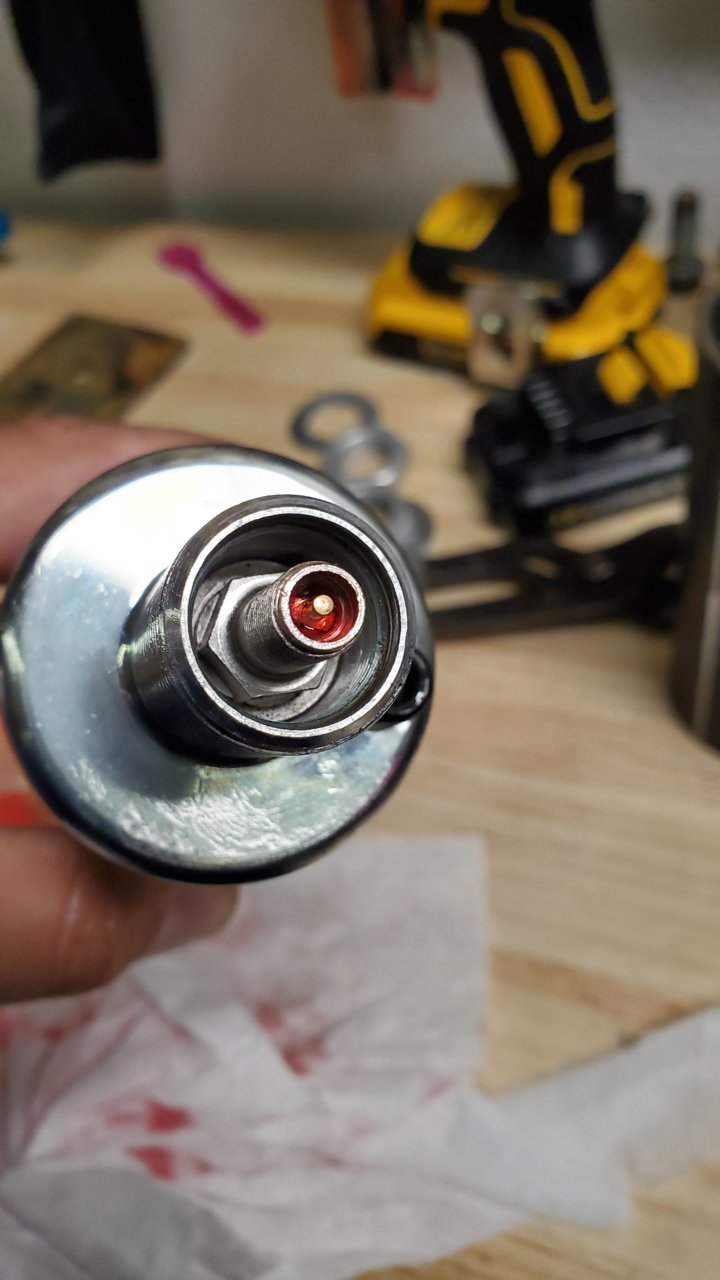

    Should I mock and tac the can mounts now or wait until I get the Coilovers?

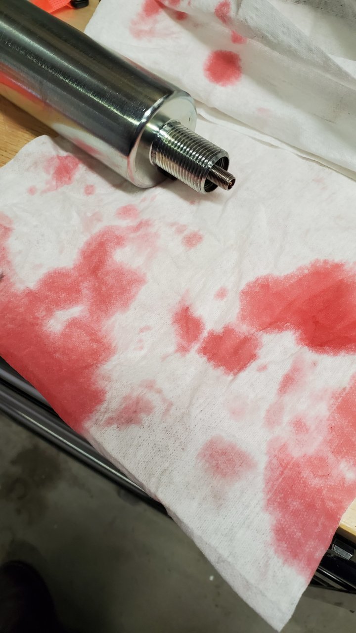

    Is this normal?

    yes afaik I had a little oil come out.

    I was decompressing it and more fluid came out.

    Hmmm you weren't holding the valve open when pressing in the shaft?

    They are emulsion shocks so the nitrogen and fluid are not separated. If your schrader valve core is defective that would explain your low nitrogen pressures. You'll need to open up and top off with fluid now though.

    No

    Seems like you could have a leaky valve then. I had a little come out when letting nitrogen out but nothing should come out with the valve closed. What happens if you cycle the shaft with the whole thing turned upside down? You can just fill it with any compressed air to test the valve also.

    Valve doesn't leak, only when I released nitrogen.
    Nothing happens when cycling it. No leak.

    Wait I’m confused - did the oil come out when you held down the valve piston with your finger and compressed the shaft? It now sounds like what @desertjunkie760 and I were saying that when you let nitrogen out oil will come out also unless you’re careful to just let the nitrogen out slowly.
