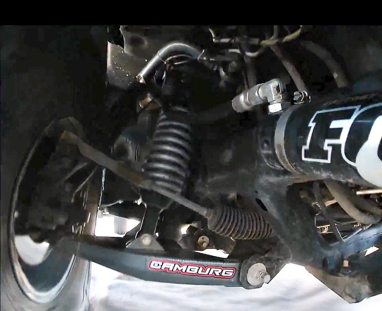

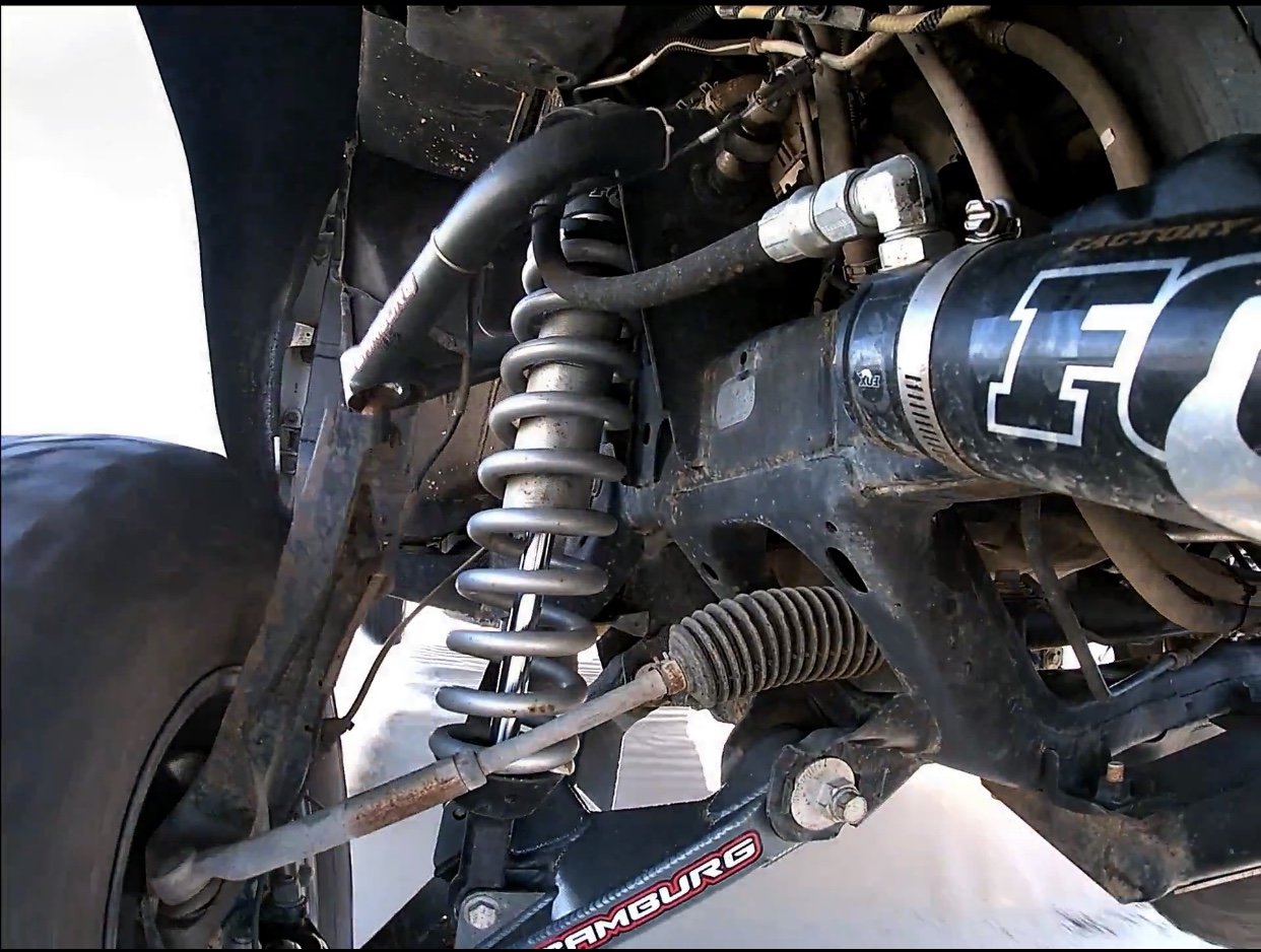

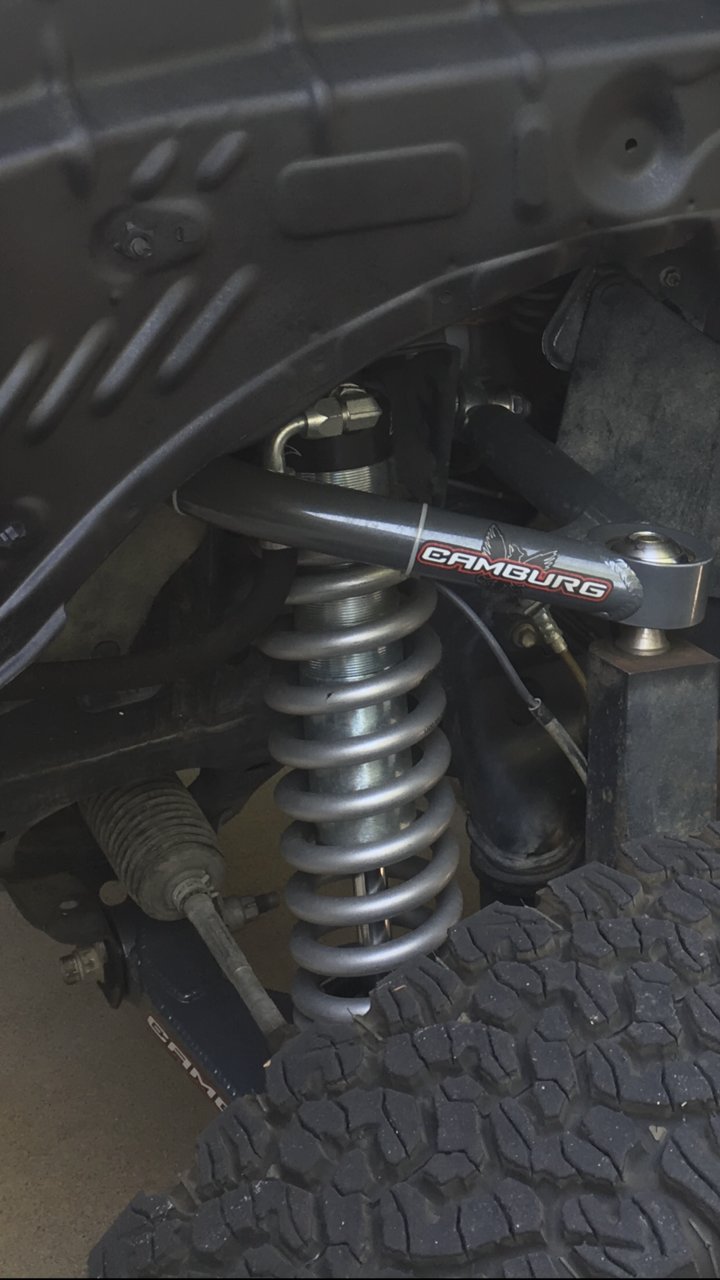

    @99GC8 & others:
    Here’s what my camburg kit looks like compressed at bump, drooped out, and at ride height.
    Fox’s, and I got them from camburg directly, so they should be a 16” 600lb spring.
    I have almost no preload on them though, as I have spindles that provide most all my front height.
    BA317181-6BE4-480D-9E11-948451F0A5E2.jpg C2B5386B-66D1-4177-9166-65A308631146.jpg 74579BAC-6C5E-44CA-BABB-82384272251C.jpg
