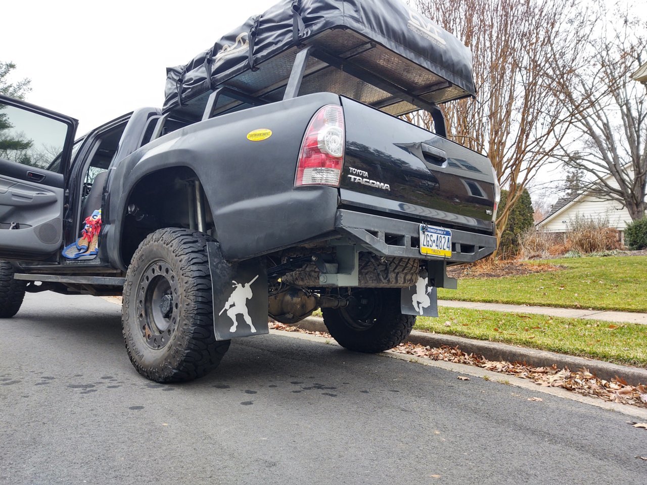

    I had someone asking about the Ford leafs. Are the raptor leafs 3" wide like the normal faeries??
    This raptor leaf set up is interesting. I think there is some advantages staying SOA vs SUA especially in bump but I could be wrong? What did that shop do for shackles and set up to get the #s they are pushing?
  9. Apr 23, 2020 at 7:01 AM
    Arcticelf
    Arcticelf Well-Known Member
    Jul 18, 2015
    #159735
    7,662
    Gladiator
    The leaf pack is 3", about 3&3/8 with bushings, standard Ford.
    The SOA pack has less bump travel, but more droop travel (for the same total travel number) but it also has better ground clearance. And I could get a Camburg Racing shackle for it, so all I had to do was build a custom shackle hanger.

  12. Apr 23, 2020 at 7:25 AM
    Arcticelf
    Jul 18, 2015
    #159735
    7,662
    Gladiator
    I had to move the shackle hanger forward after I took this picture, but you get the idea.
