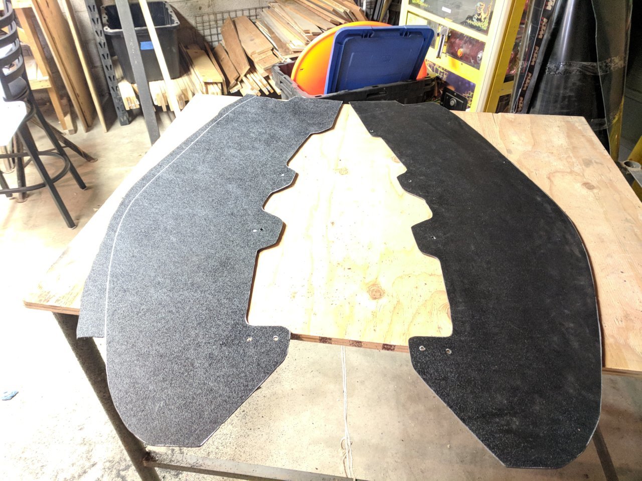

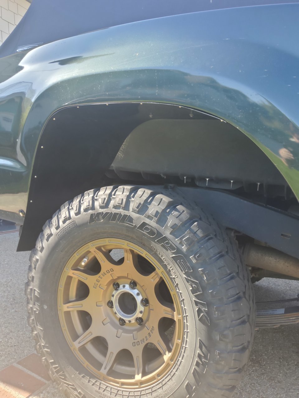

    They're taking for ever, but finally making fender liners20200430_161553.jpg 20200430_161602.jpg

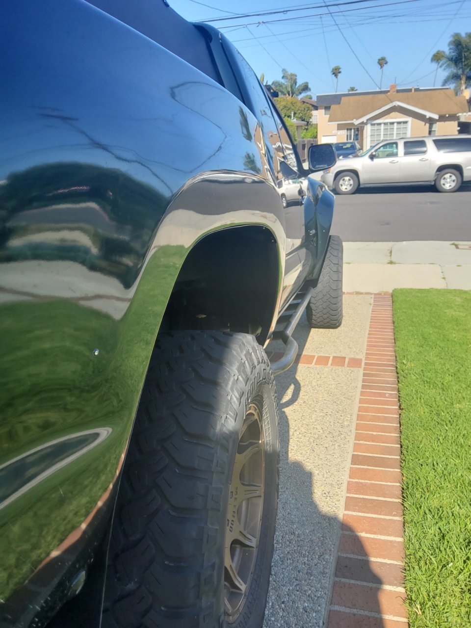

    Does your tire not stuff up into the fender? Looks like those are straight at the fender line and won’t allow the tire to tuck.

    From what I can tell they'll clear. Going to find a ramp or something to really flex it. If it rubs I'll use a heat gun to deflect it more up

    Gotcha. Didn’t want you to go hit a jump or something and then rip off and ruin your hard work.

    Appreciated. I'm going to try flexing it with a jack, but I know leaf springs kind of act as their own torsion bar.

    You could measure off of your bump to get full bump height and then from the top of the axle to the top of the tire. Adding a bit of wiggle room helps since stuff can flex.

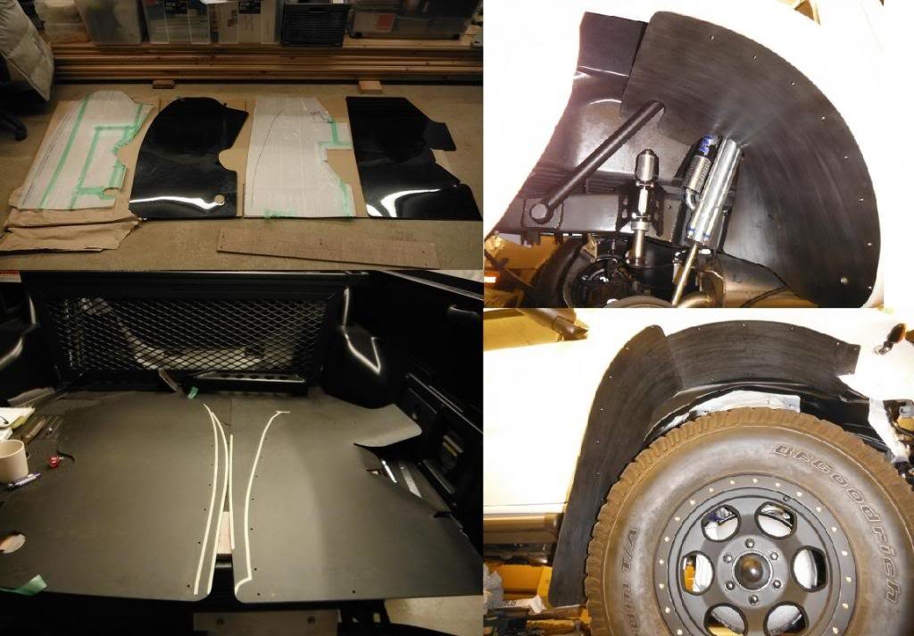

    I ordered plastic from McMasterCarr, and have just been slowly trimming them to what I think will be the best fit, and just started mounting them. It's definitely a slow process to make it right and look good. Seems like every corner is different too. Cant even mirror left and right due to subtle glass differences.

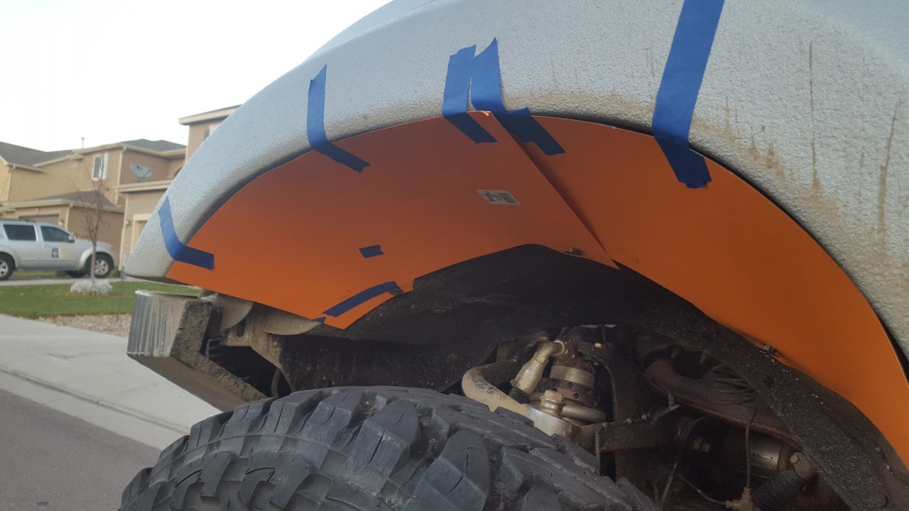

    I hear ya. My front fenders are off by about 1" between each side. I found a local plastics supply place and bought a 4'x8'x.090" of ABS. Cost like $50 when I did this 4 years ago. I also bought some poster board and made templates first. I used a lot of painters tape to get the shape I wanted. For the fronts I ended up with the following shapes. I will use the same process for whenever I do the rears. I do need to check how much flex I have in the rear. I might have to change how I make these.

    My rears are definitely going faster than my fronts. Less weird curves. I've been using the cardboard that the plastic shipped in. Crazy you got that detailed with the relief cuts but I'm sure it's super clean
