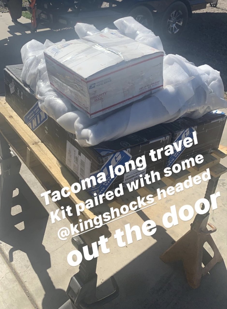

  18. May 6, 2020 at 2:03 AM
    m00seNUckLEz
    m00seNUckLEz tAc0 aFiCi0nAd0
    Dec 20, 2015
    #172698
    858
    Fresno, CA
    Under Construction
    Such an exciting feeling to see your suspension has been shipped!
