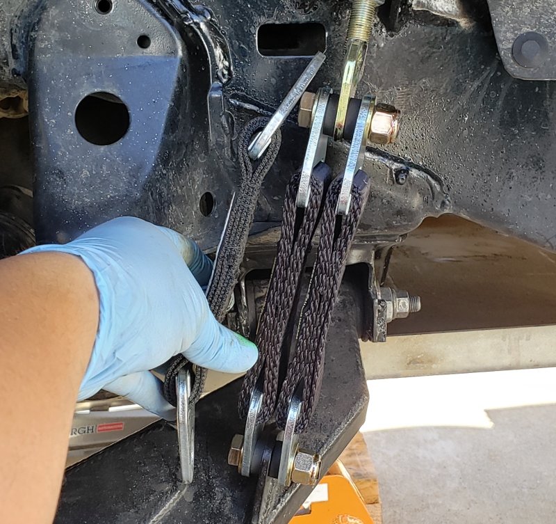

    If you'd like to minimize stretch, especially for a 20", I always recommend trail gear rock assault 6-ply. Had two sets of them after changing suspension and still reliable. Then I went to double. Most likely will snap the clevis so need to change to a bracket style mount.
    Here's a set of straps that came in a kit, holding the 4 ply vs 6 ply.

    Where did you get those spacers?

    Trail Gear actually supplies them in their kit. 4 pieces per strap. Otherwise, hit up mcfaddendale industrial hardware. They should have similar collar spacers.

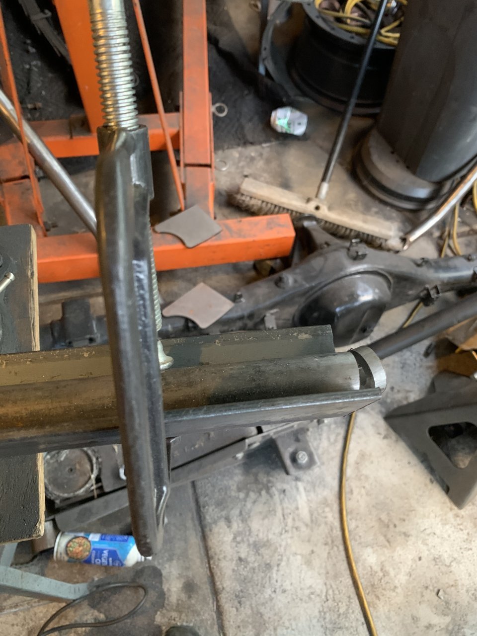

    Right on - there’s one a few minutes away in Anaheim. I looked all over on McMaster Carr and other places on line but couldn’t find any reasonably priced ones so I made my own out of some tube. It wasn’t the easiest thing with just a grinder but eventually I got some passable results.

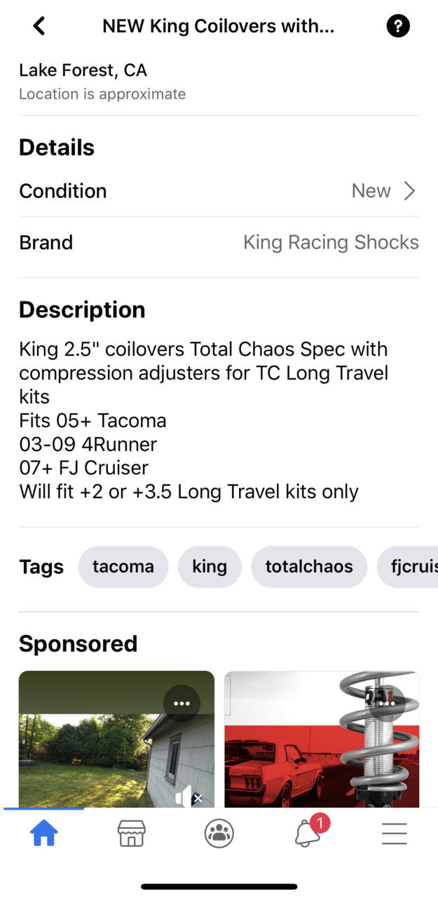

    question: can these be used on a first gen with a LT kit?

    kinda even more dumb question but can’t i just take the top plate off and now it’s a normal king shock? if that makes sense lol

    I'd look for standard 8" coilovers - by the time you swap out rod ends and springs you're not gonna save any money over a used set of standard 8" coilovers or buying a brand new pair.

    TC has a custom spec for their kit so these are not the same as a standard 8” shock. Not saying they won’t work, but I agree with @Dalandser in saying it won’t be cost effective for you to try and make these fit on your truck.

    This. I tried making standard 2.5x8’s work on a TC kit and it was more expensive than worth it. Just buy the TC spec’d coilovers, easier in the long run.

    yeah most likely going to do that, i have a buddy who’s sponsored by king and can save me a couple hundred, i was just hoping to see if i could find a pair that doesn’t have a 2 month lead time. I want to hurry up and put my LT kit on lol
