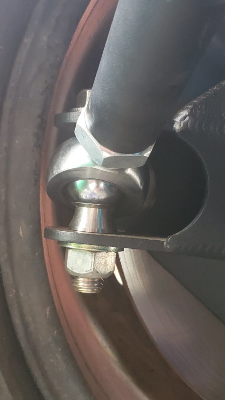

    If you like your settings as-is, you match the cams as best as you can to the provided tabs. Provided that your bushings are in good condition, nothing is bent or out of place, my assumption is that specific settings will allow similar results for the same model vehicle. I went with recommended settings and it was spot on. Firestone did mine and I just told them to adjust toe which is the only thing left. No issues.
