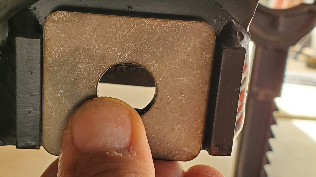

    The trick is welding the correct cams. I only did one per mounting point so I can still pull it apart

    This is how I did mine.
