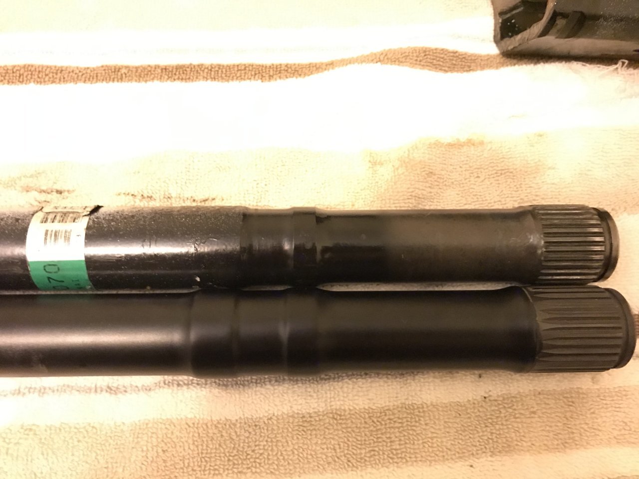

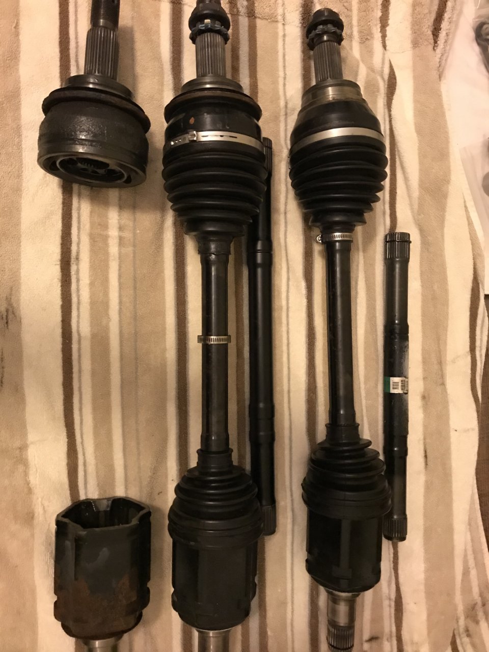

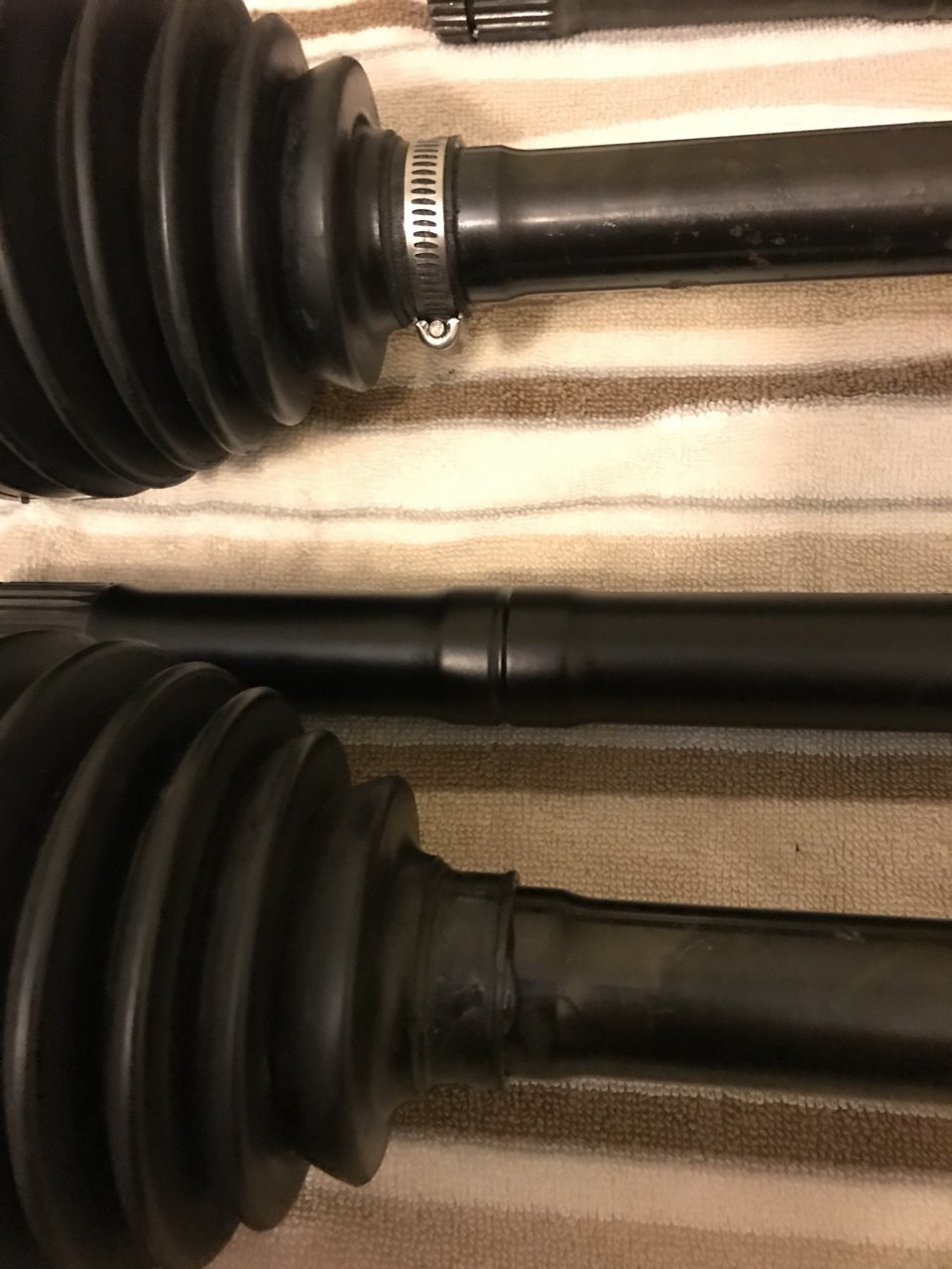

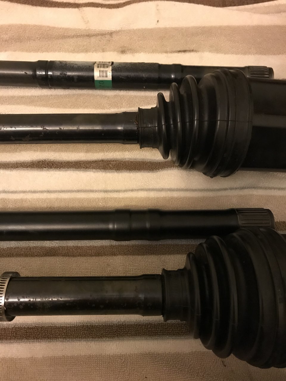

    I noticed there was a difference in locating grooves for the boots of the camburg and TC extended axle shafts. TC assembled and camburg laying next to it. The camburg matched the OEM locations exactly and TC is closer to the end of the shaft for the differential input side. Has anyone experienced more torn boots over the other?? Now I'm considering just holding on to the extra set of shafts instead of selling them.

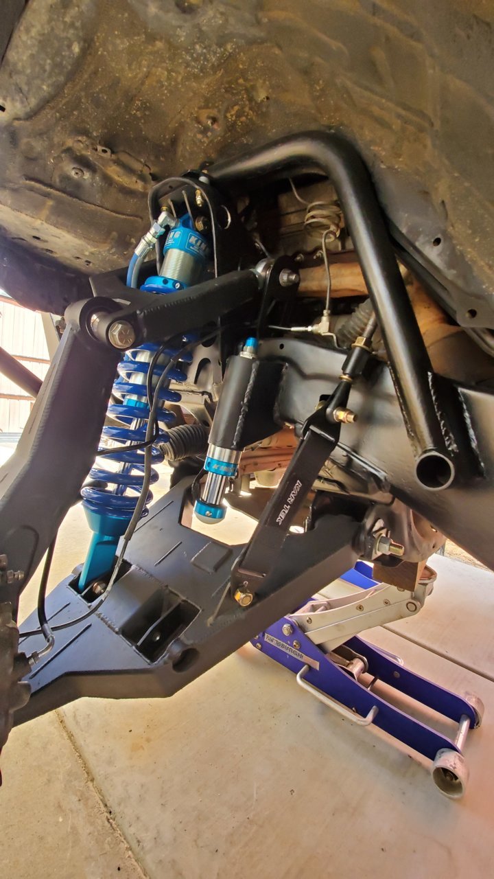

    They were charged. 150 psi per my tool. Went with 170. Bumps at 150. Will tune from there.
    Taking it out to Johnson Valley soon.

    Looks good just secure the cables to spindle. Dont use Zip ties lol. Use a screw on holder.

    There's nowhere to screw on the spindle. Unless I grind and weld.
