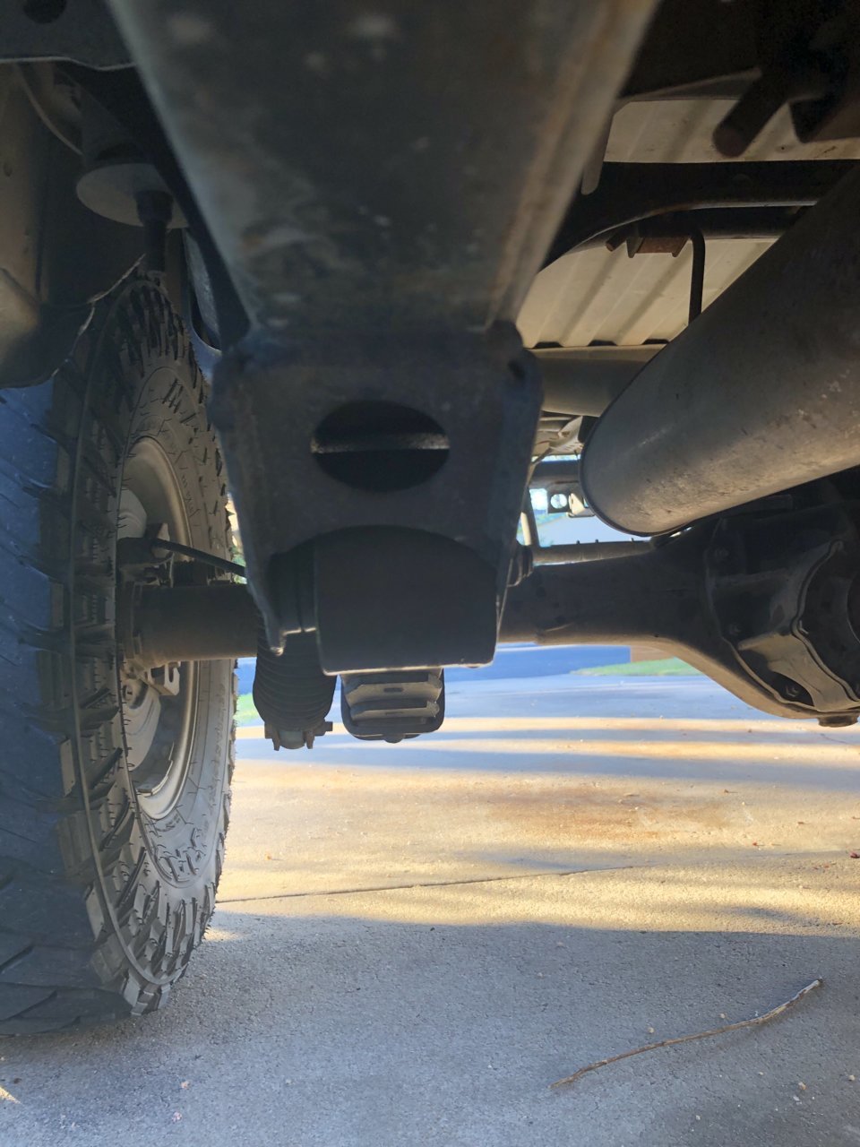

    How do you mean you bent them? One side or both - you mean limit strap or weld them on in a different location? You could just make overlays for TC ones.

    They seem bent out from a hard hit or something. Deavers slightly rubbing on the mount too. Scratching my head, both sides.

    I just went with ruffstuff sua kit and JD Fab hangers. Id mount the limit strap further up the frame to give you more surface to weld to. You might try to straighten as much as you can then weld gussets to it.
    Did you box your frame? The frames on these frames are stupid thin

    Hmmm your spring seems to have wandered inboard too - not sure if it happens to most guys since nothing has changed since my truck's had the springs installed and been sitting. That's pretty bent - it almost looks like it took a rock hit, but if it's identical on both sides, probably not likely. I agree, I'd try to bang the hanger back straight and reinforce with overlays for sure.

    Looks like a bad bushing

    it’s identical on both sides which is why I’ve been scratching my head. Could the wandering be mostly from the bushing?
    I’m gonna drop the leafs this weekend and do some measuring. Likely just plate over it once it’s straight. Would like to tie them further up the frame anyway.

    You'll have to keep your axle roughly in the same location though unless you want to extend your ds - you'll probably find clues once you take the springs off too.

    Are your shocks mounted outboard up top too? looks like the leafs are way inboard on the axle
