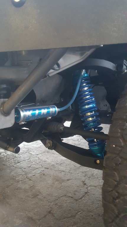

    Who out there knows of other companies that make shock mounts like the giant ones below...

    Any reason they're not working? LSK, TNT Fab, BTF would be able to make them among many other places... :notsure:

    TNT Fab on Instagram - he'll make them on any truck with a core to build from. Here's one for a 1st gen Tundra which is almost identical (but not exact) as ours - you'd just have to make a mount.

    Just seeing what other options are, found some that are already cut from oddball. Just surprised theres not more out there.
