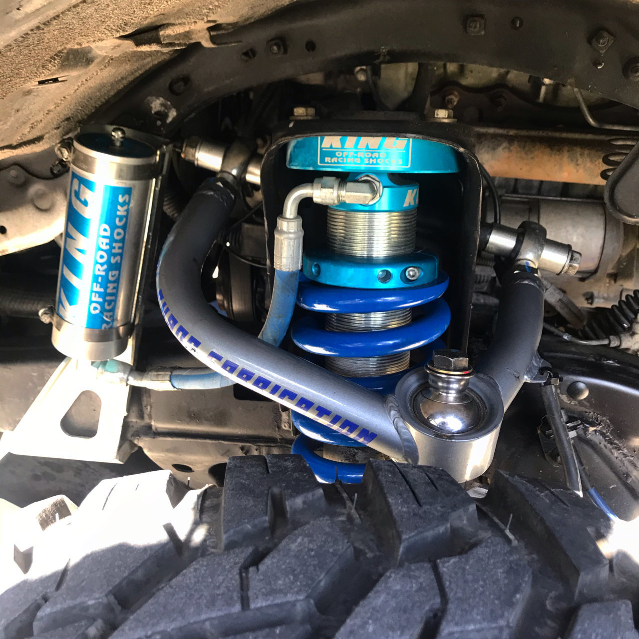

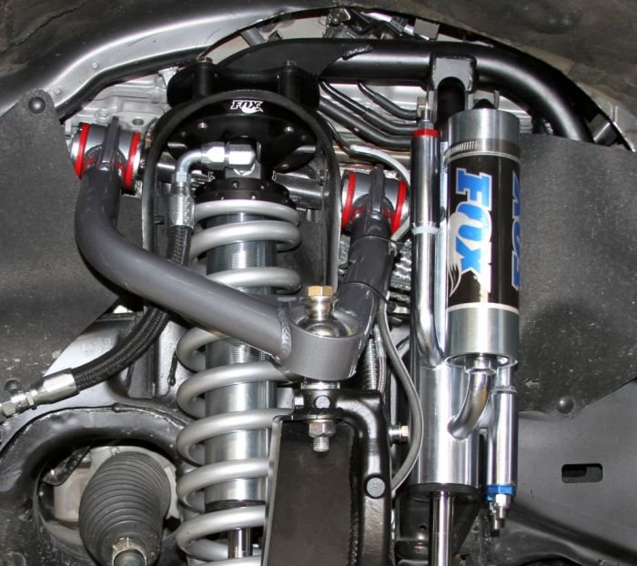

    https://www.chaosfab.com/accessories/2005-2015-Tacoma-Dual-Shock-Hoop-Kit-86610
    Few pics here - I’m assuming the only difference between the hoop for the regular kit and the other kits is shock placement.
    This might be from a 4Runner - strange that most google image search results comes from 1st gens / 3rd gen 4runners.

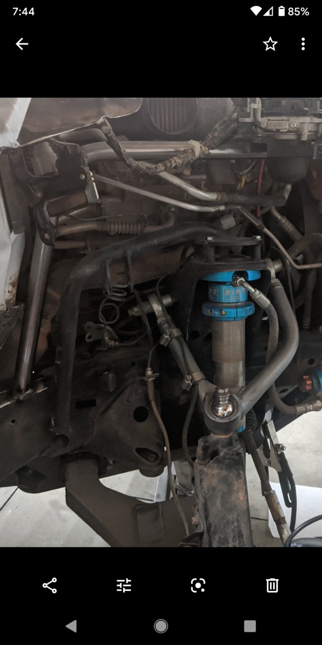

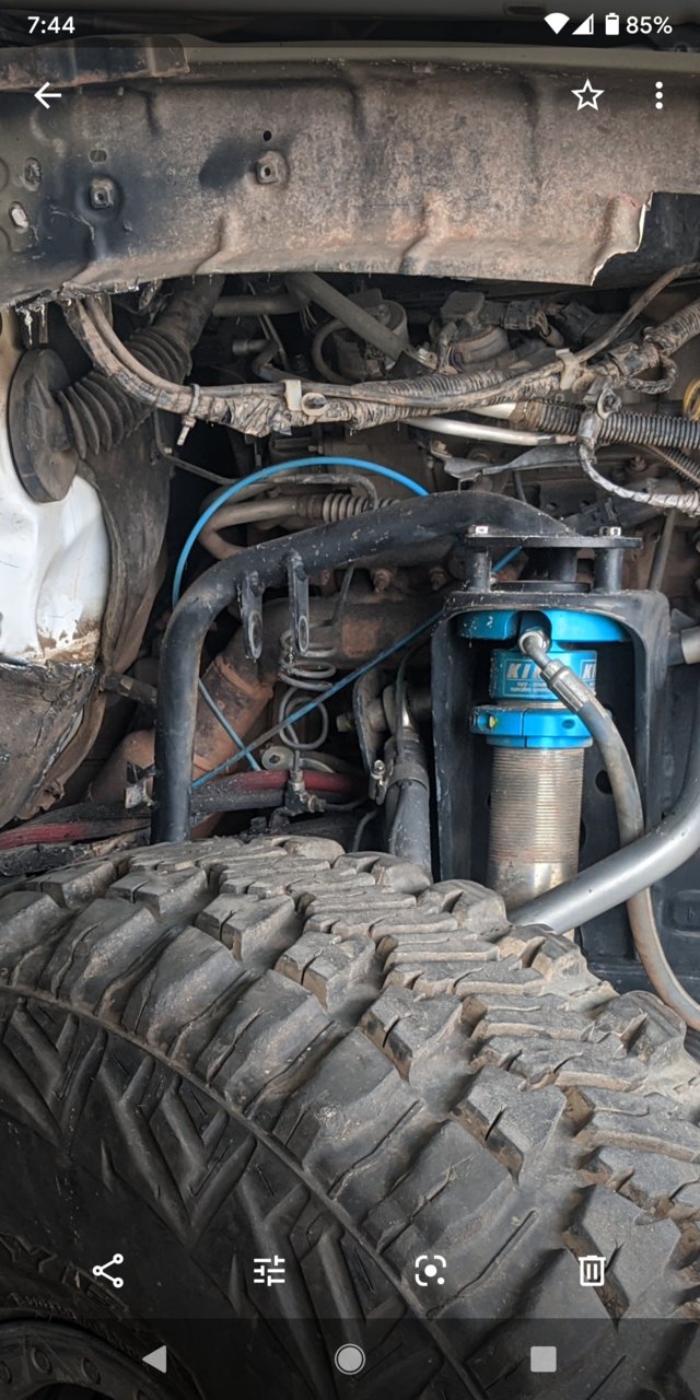

    Are you looking for a specific detail? Install is straight forward, but if you've got access to a tube bender and a free weekend you could save a lot of money. You still have to verify the fit before welding everything, so all buying the kit does is it saves trial and error part if you start from scratch.

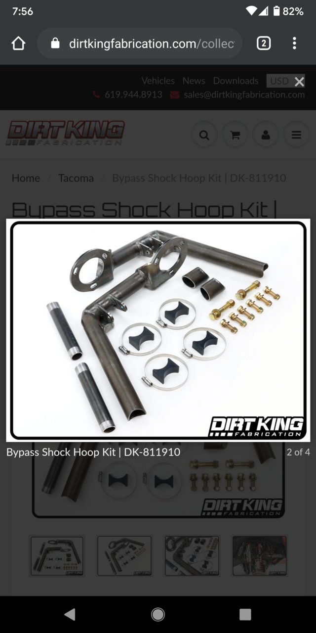

    Socal
    I think the dirt designs top plates are superior to everything else I've seen, secondary mount and a crossover mount built into a single package.
    Dirt king had a generic set up that welds to a piece of bolted to the top of the tower, that might be the easiest set up to copy if someone was starting from scratch.
    Edit:
    Looks like it's not angle, but this might be easier to make than TCs version

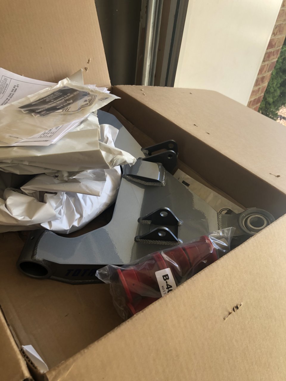

    Thanks for the pictures. I was just looking for this. Im not doing LT, but dual shock MT - eventually. Just did the double shear UCA gussets.
    Was planning on the TC because everything is measured for their stuff already. Ill be putting these on today hopefully. (Whats good about mid travel, is I can do it in stages :cool:)

    The tc shock tabs only come tacked in place so you can cycle the suspension and check their placement. Make sure do check things before you just weld the tabs where they come and it’s not guaranteed to be in the right spot
