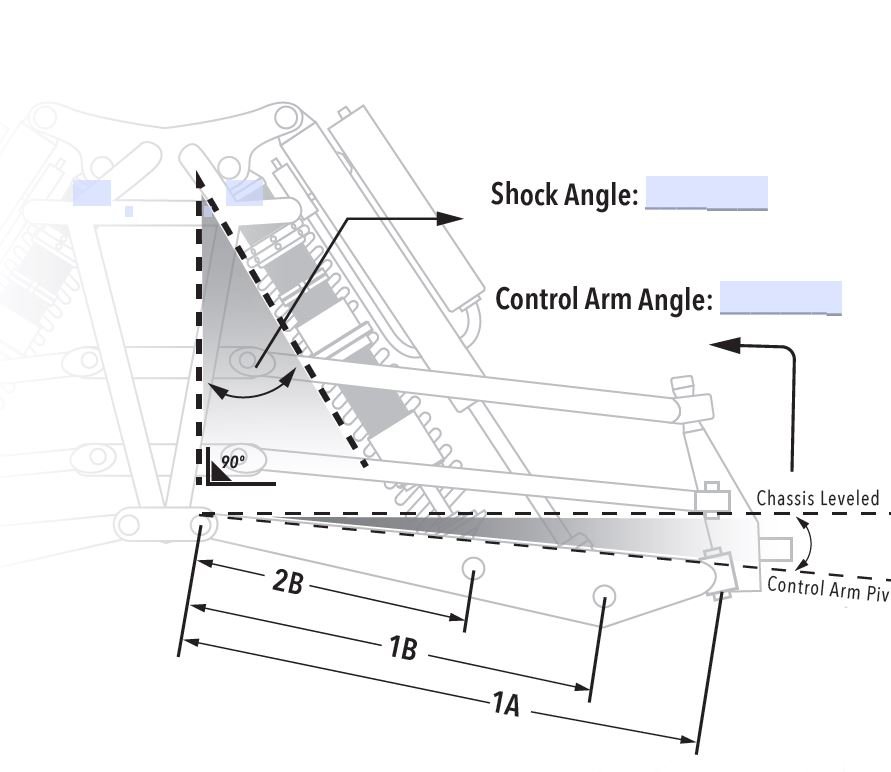

    Finally about to pull the trigger on front coilovers, going with custom ADS coilovers valved to Dirt King’s specs for their kit. Question about springs, do you guys think the 16x600 and a little preload will be enough for full skids/sliders/full plate steel bumper? I know the 600lb is usually plenty enough for 2nd gens, but most I see are running tube bumpers. I have the option of 650lb with the eibach springs, since I know we’ve been over the fact that 700s are overkill.
    Edit: I'm leaning towards the 600lb so the shim stack can do its job, just don't wanna go crazy on preloading them.

    Yeah I know my reference point for stock travel, I'm currently on 700lb springs with stock arms. But that whole reference point goes out the window with the new geometry and an 8" coilover. That's where I need to gain some perspective. I don't plan on adding a winch, especially without reinforcing the stock frame mounts for the bumper.

    Exactly, with some simple math you can figure out the approximate percentage force difference required to achieve your desired ride height (at various points in the suspension cycle). Not sure where DK's shock pivot is at, but obviously with the shock pivot pushed out further you will need more preload with the 600. Or Ryan at Accutune has worked with DK LT setups. He could tell you what route to go.
