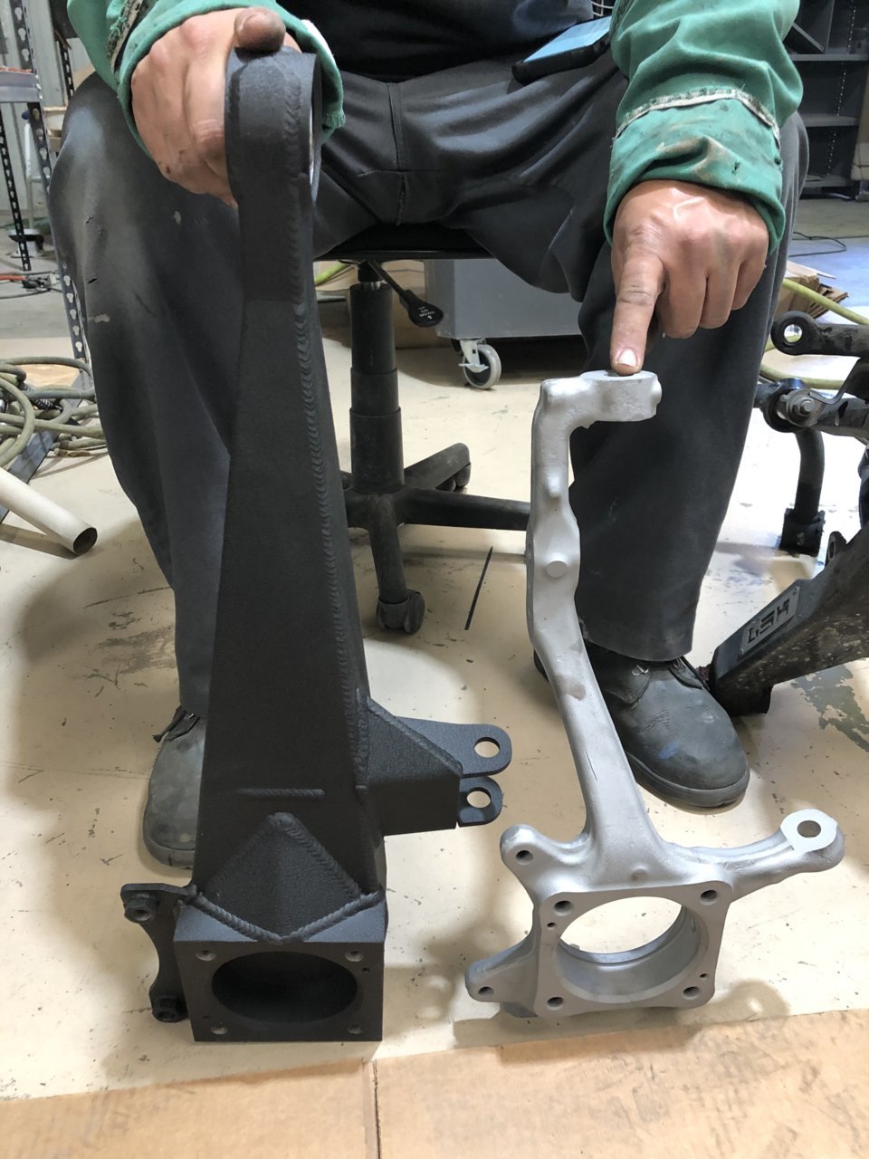

  4. Jun 12, 2020 at 7:11 PM
    superman2481
    superman2481 Well-Known Member
    Apr 5, 2012
    #76364
    424
    How much lift are those spindles?
    m00seNUckLEz[QUOTED] likes this.
  5. Jun 13, 2020 at 2:01 PM
    Anthony250
    Anthony250 Ex Fabricator
    Sep 29, 2010
    #44016
    3,775
    Anthony
    Rialto CA
    99 Tacoma LT Prerunner
    LSK Race Kit, King Shocks, Methods, Glassworks, Baja Designs, Built by myself.
    Those arnt probably lift spindles, those are for a long travel kit.
    m00seNUckLEz likes this.
  6. Jun 13, 2020 at 2:40 PM
    4Running Daily
    4Running Daily Long Live ZS
    Mar 25, 2012
    #75625
    8,702
    Connor
    Tempe/San Diego
    1996 Toyota 4Runner
    They’re for sure both. That’s a long ass spindle to have the lower Uniball still below the hub and not in line with it.
    m00seNUckLEz and Arcticelf like this.
  7. Jun 13, 2020 at 9:54 PM
    superman2481
    Apr 5, 2012
    #76364
    424
    Yeah I get that but I’m running 4” maxTrac right now with my camburg kit but switching it out for the bolt on LSK kit but you it’s hard to believe that big ass spindle is the same as his factory spindle on the right
  8. Jun 13, 2020 at 10:20 PM
    m00seNUckLEz
    m00seNUckLEz tAc0 aFiCi0nAd0
    Dec 20, 2015
    #172698
    858
    Fresno, CA
    Under Construction
    These will provide some lift, I forgot how much. The uni-ball sits behind the hub as a Maxtrac spindle does. Also, I have completely different shock and UCA mounts.
  9. Jun 13, 2020 at 10:29 PM
    m00seNUckLEz
    Dec 20, 2015
    #172698
    858
    Fresno, CA
    Under Construction
    You know you're going to lose your lift when you put on that LSK kit, right? it's not compatible with that Mactrac spindle.
  10. Jun 13, 2020 at 10:35 PM
    superman2481
    Apr 5, 2012
    #76364
    424
    Yeah these are 2.5” lift and it comes with fabricated spindles so getting rid of the maxTrac 39B42D3C-B6E3-4030-AF31-9B060E8770FF.jpg

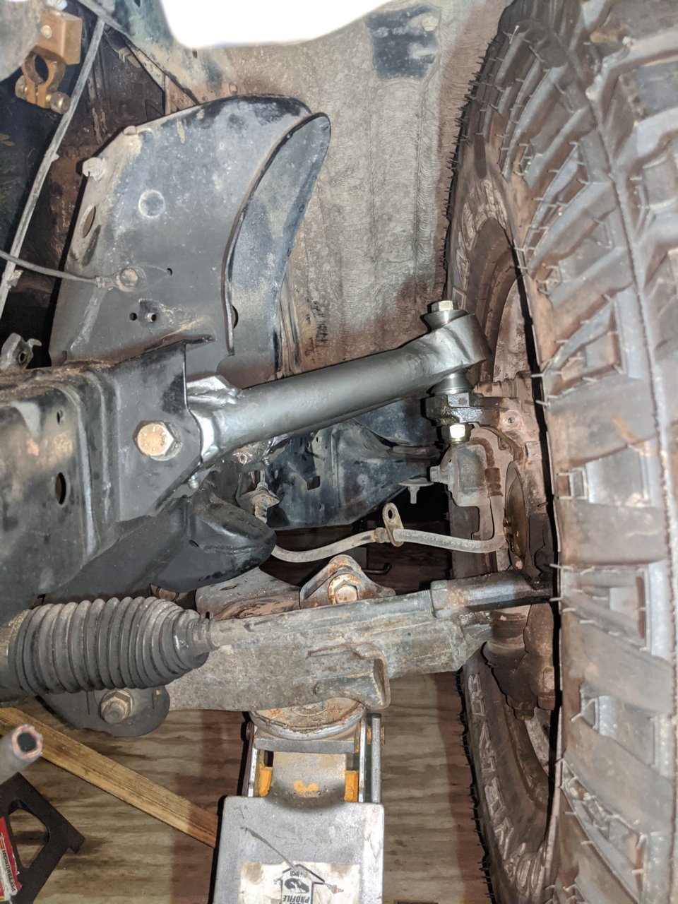

  15. Jun 17, 2020 at 8:33 AM
    5 Lug Fury
    5 Lug Fury Well-Known Member
    Nov 21, 2014
    #142831
    3,077
    Kenny
    Knoxville, TN
    V8 Solid axle swapped 5 lug
    Got a lot of stuff lol
    Are there any differences between the high angle miss alignment spacers for uniballs out there? I'm working on my mid travel arms and I think I can squeeze some more travel out if switch to high angle but wasn't sure which set to get.
  16. Jun 17, 2020 at 8:38 AM
    Adventure4x4
    Adventure4x4 Well-Known Member
    Feb 12, 2016
    #177931
    1,388
    Adam
    San Antonio, TX
    2013 TRD off road MT
    Not sure if you have yet, but make sure your coilover doesn't bottom at full jounce as well.
  17. Jun 17, 2020 at 8:43 AM
    5 Lug Fury
    Nov 21, 2014
    #142831
    3,077
    Kenny
    Knoxville, TN
    I'm actually going to remake the arms and this time the shocks will be mounted to I can check for clearance and binding
  18. Jun 17, 2020 at 8:48 AM
    Anthony250
    Sep 29, 2010
    #44016
    3,775
    Anthony
    Rialto CA
    Depends on your uniball cup, if its like the total chaos cup they have some special shaped misalignment spacer for them, and if its a standard cup they just have a simple taper and you use standard misalignments.
    Like so , https://www.kartek.com/parts/17-4-s...r-1-heim-or-uniball-for-34-bolt-2-34-stk.html

  20. Jun 17, 2020 at 9:08 AM
    anthony250f
    anthony250f Well-Known Member
    Feb 18, 2012
    #73066
    16,771
    Anthony
    San Diego, CA
    2008 dcsb trd offroad 4wd
    I had both on a 1st gen. 12” over the frame was much better.
