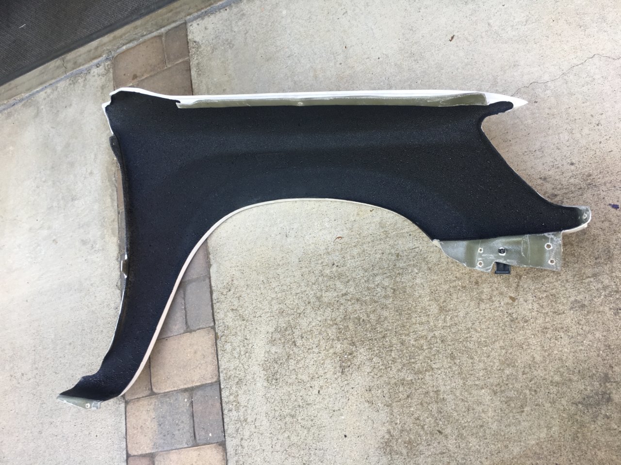

    Used raptor liner adhesion promoter and then coated all the insides of my fenders.

    Ive done it with spray on raptor liner. The stuff is good. I did it to my new bedsides. Pressure washer was starting to remove it after a year but it was up close spraying to remove mud. It does help agianst spider cracking paint.
