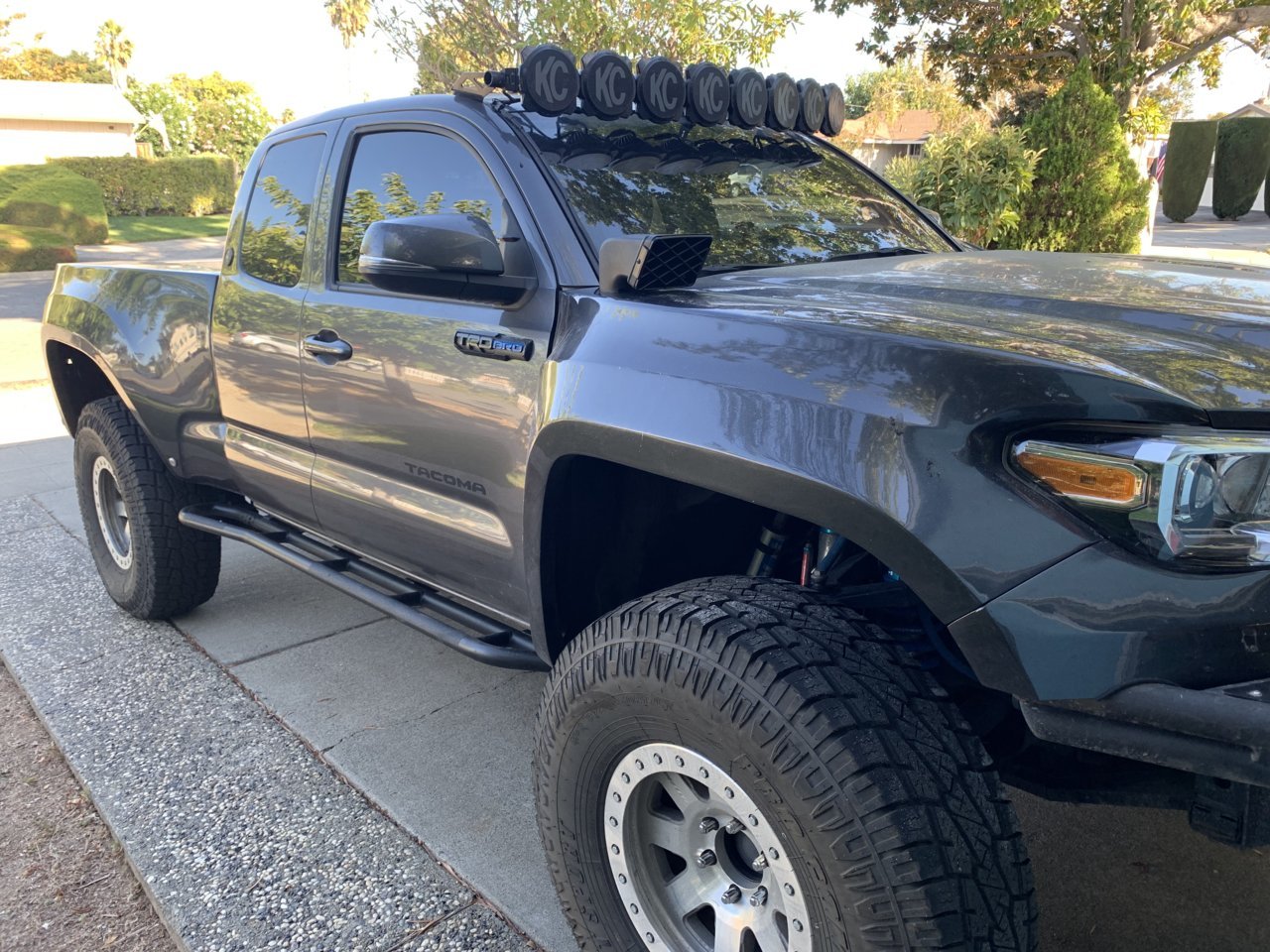

    This is what mine looks like. I eventually am going to make a smaller snorkel head but for off the shelf this is really all I could find.

    As much as I hate the look of snorkels this actually doesn’t look half bad. Especially if you did some sort of custom and slightly smaller head for it

    I think it’s more of the non giant tube running up the a-pillar that I like. Saving the idea for later as I have been messing with my intake setup and still slightly concerned about heat and water ingestion

    WoW! seriously clean work bro, I don’t even want to know how many times you had to pull the fender off ....cut...sand...fender back on etc to het it that clean !

    Thanks. I agree, especially on third gens, snorkels look kind of dumb. Mine was super easy. It’s just a snorkel head, two silicone couplers, and a straight piece of tube.
    Once summer is over I’m going to try something else because I don’t really like the look of that snorkel head. Probably some sort of scoop instead.
    I almost picked up one of those hummer snorkel heads but they were either too expensive or too big. I can’t remember.

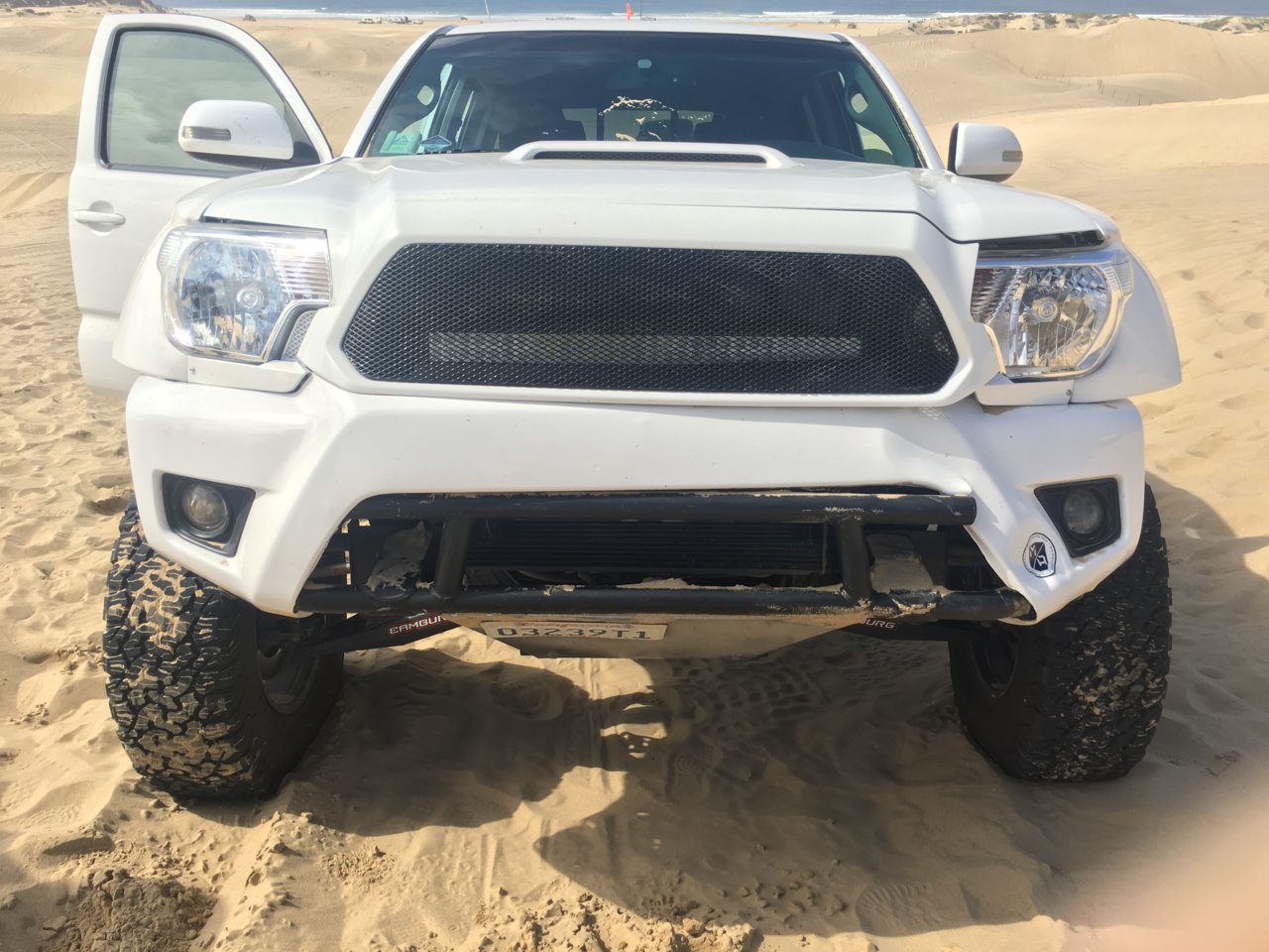

    my experience with Pismo dunes and 2wd is exactly what @snowsk8air2 said. Pick the tops of dunes to stop at, or at least a larger flat area.
    I run 10psi rear and 12psi front, and haven’t had any issue with breaking the bead.
    Be wary of unexpected holes and other drop offs though ! I learned the hard way haha

    Truly dunes are a blast, the most fun I’ve had in my truck. But definitely gotta respect how they are formed and change all the time.
    & yes, had a local Fab shop replace the core support and inner fenders.

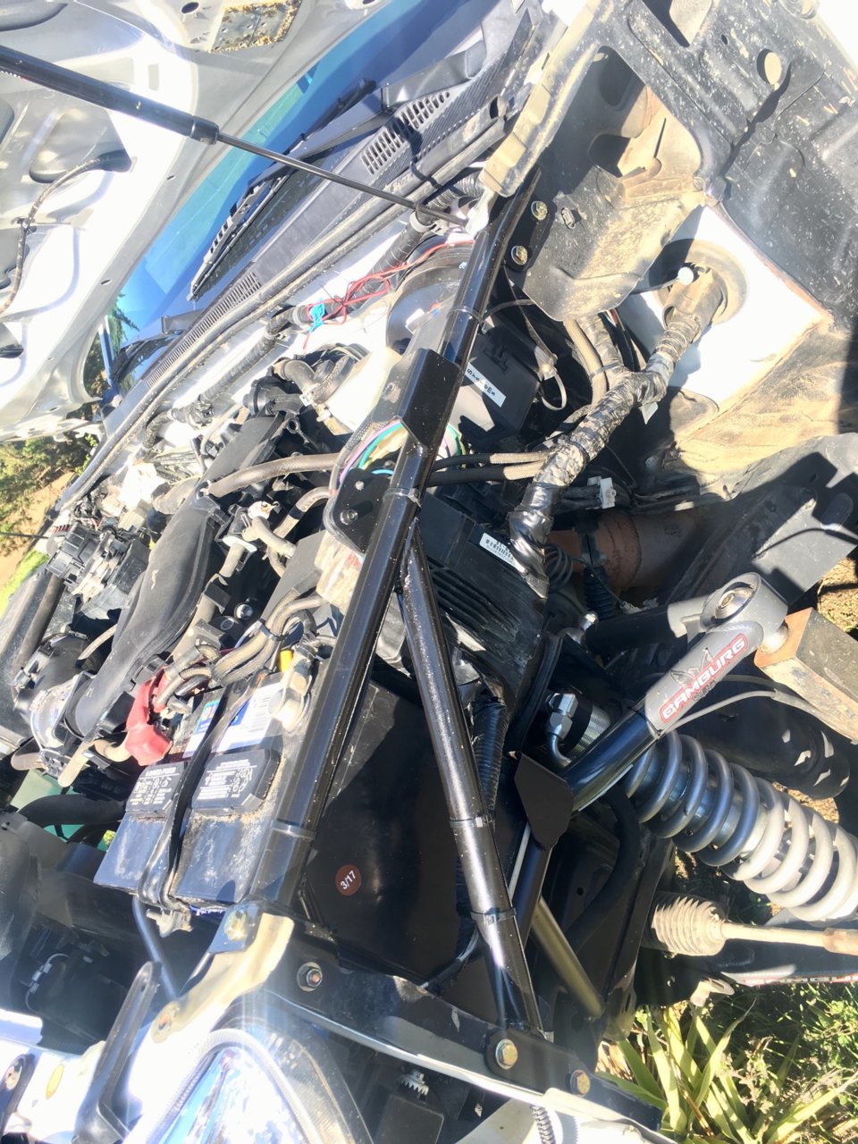

    @Adventure4x4 how did you figure out where and how much to cut?

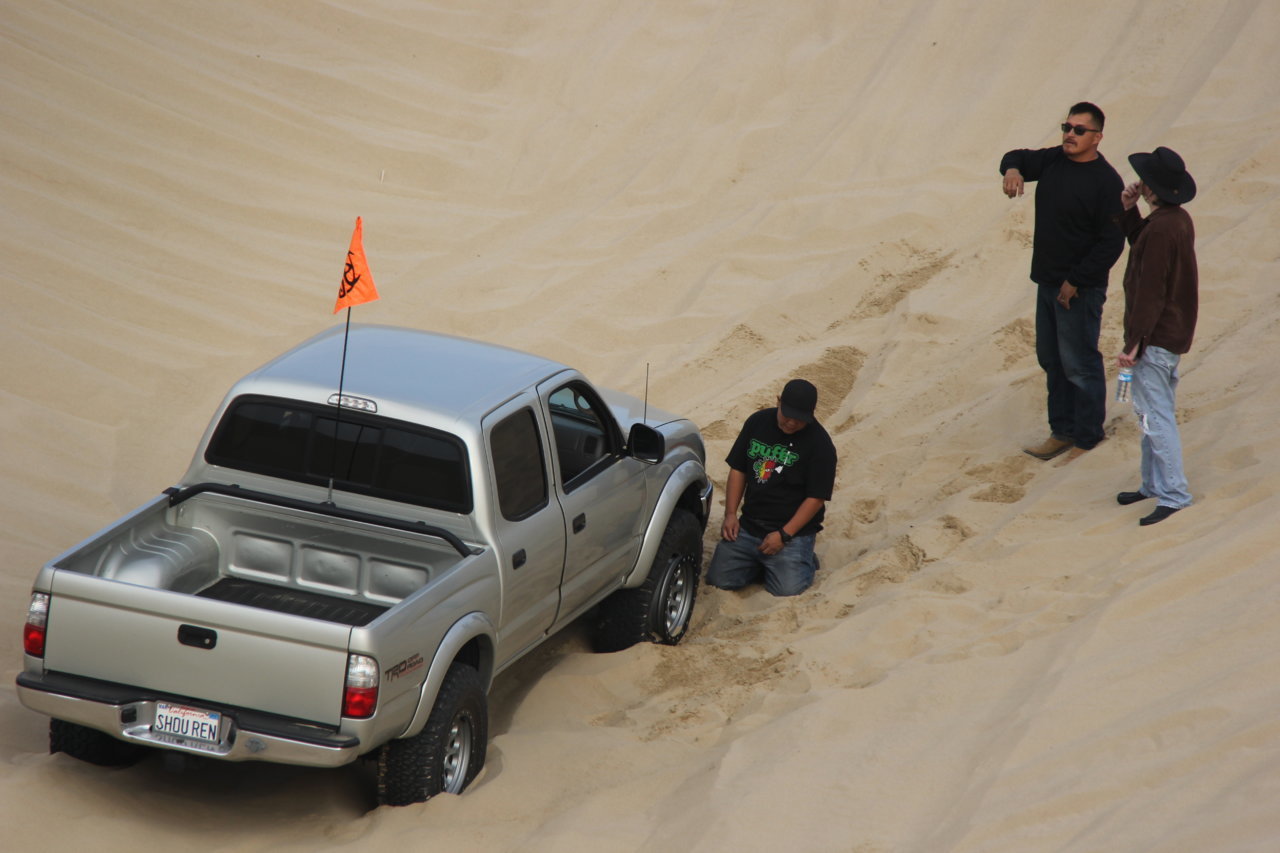

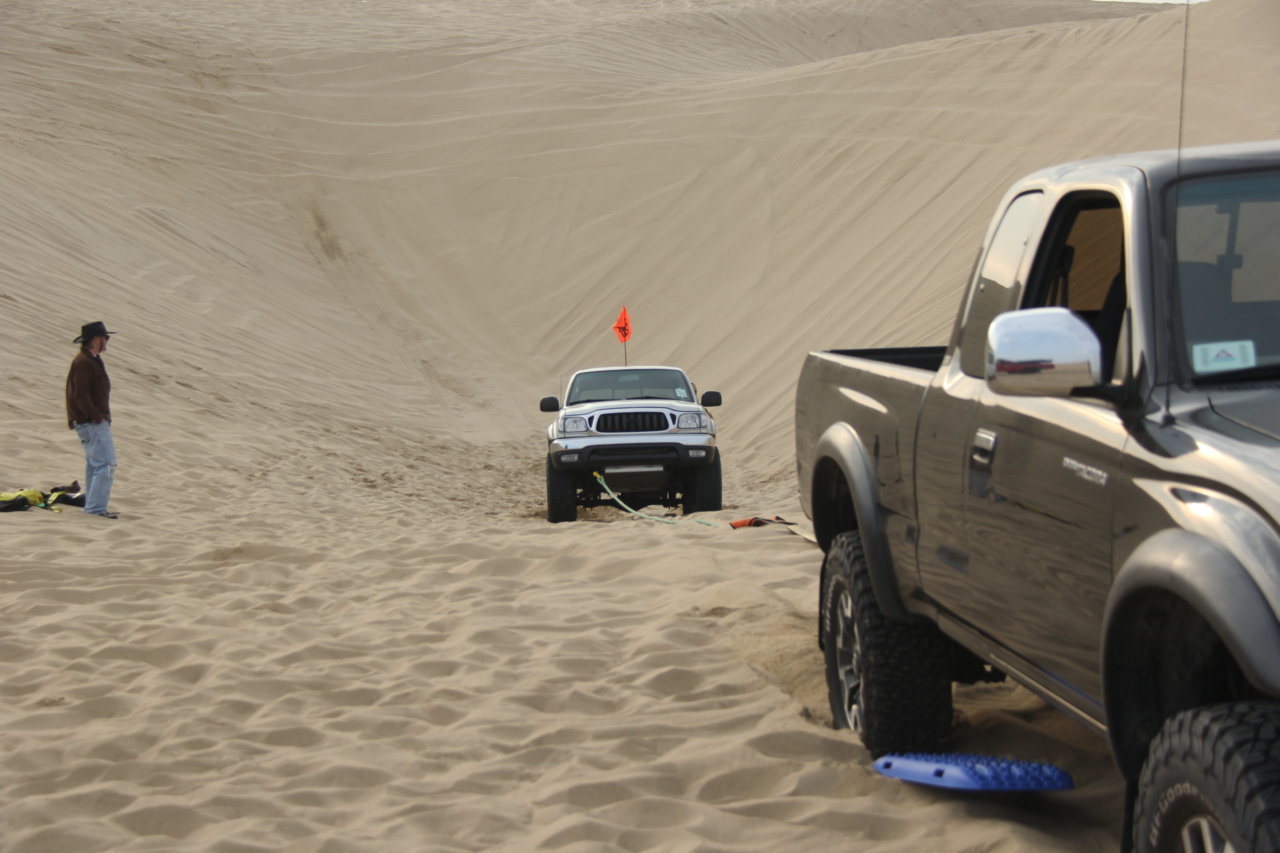

    Similar to @Sterling_vH111 we had a bead blow at the bottom of a bowl (instead of smashing the front) - ratchet strap around the tire and a compressor got it re-inflated and a snatch strap got him out.

    Think he wasn't too aired down. Hit the bottom of that bowl. Pictures flatten it out.

    That looks bad ass...killer job

    Yeah the ratchet strap was lucky for sure.

    I kind of had a basic idea of where it was going to sit. Essentially trim, check, trim, check, and so on haha. Very time consuming.
