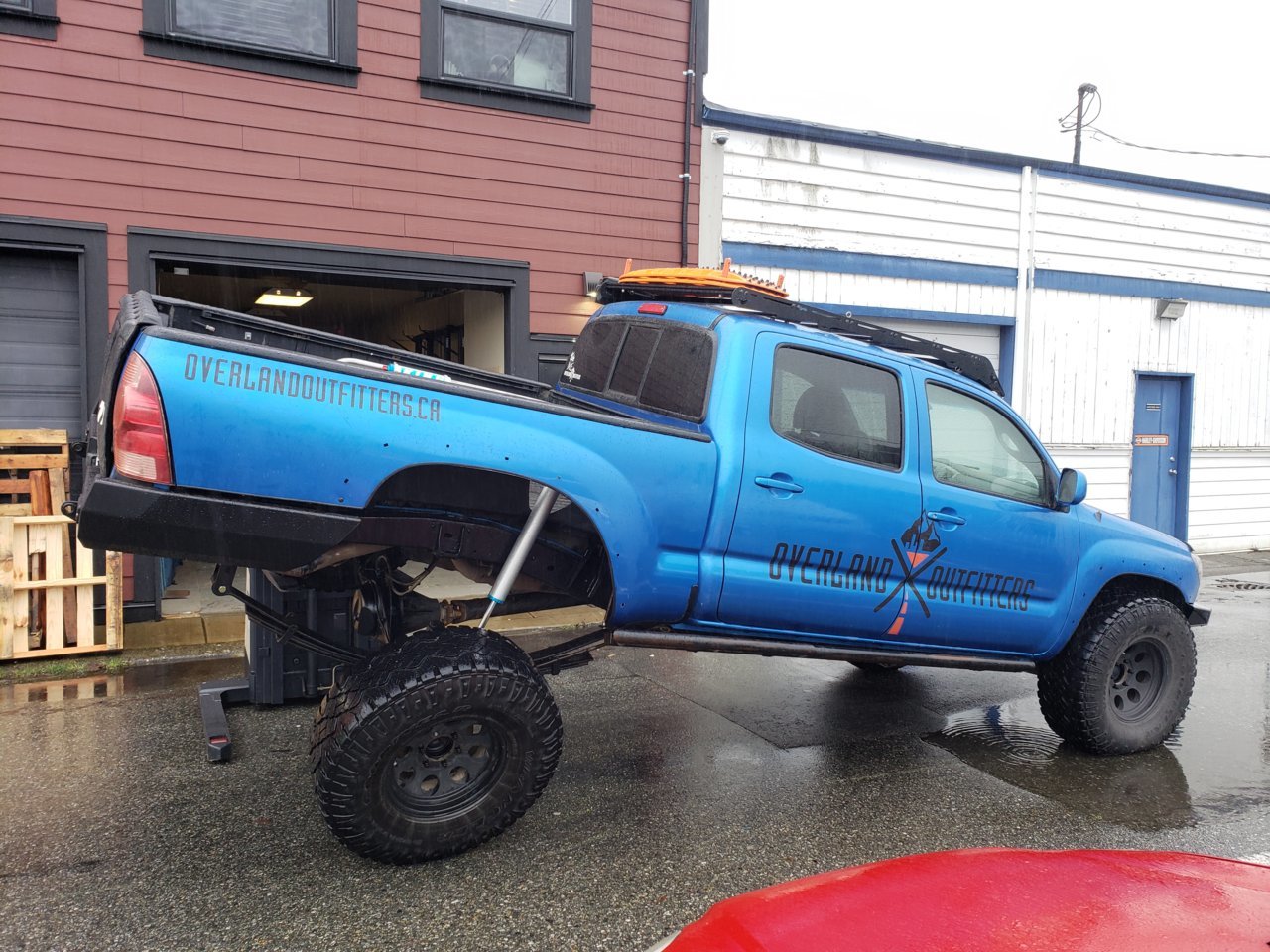

    Agreed it doesn’t seem like the trucks that have it are getting those real 19”+.
    Not to many videos of the kits in action yet either.
    This kinda heavy 3rd gen too a decent jump though
    https://www.instagram.com/p/B-RFMKBgPj7/?igshid=1cu7leqvyfmom
    I’d like for it to be a good system that could get the numbers they claim and keep a stock bed !

    links with un cut bed will get you 20” easily...

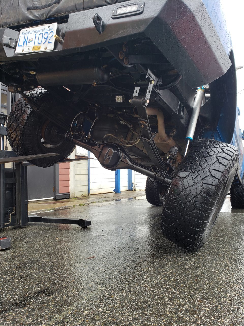

    Just wanted to re-iterate this post as I agree and add that all of the cantilever kits I've seen that actually get used crack and break. You can build a kit that would hold up, but from the pics I can see posted here, that kit is not it. I have nothing against Simmon's and dont want to talk badly, this is just my opinion
    Either way, links will be better every time, every where (except with maintenance). If you want to stay under the bed @Evenflow 's setup is pretty cool

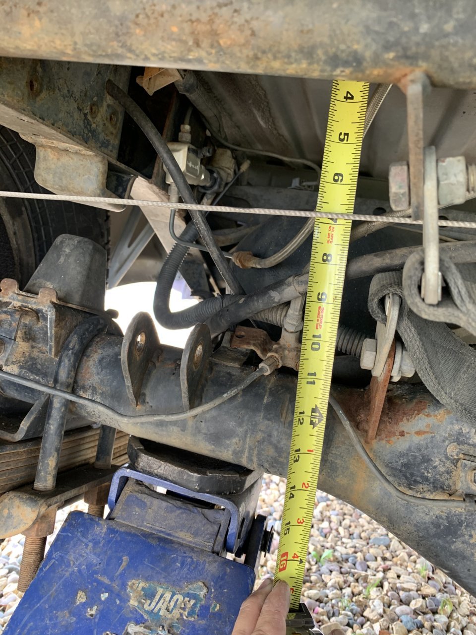

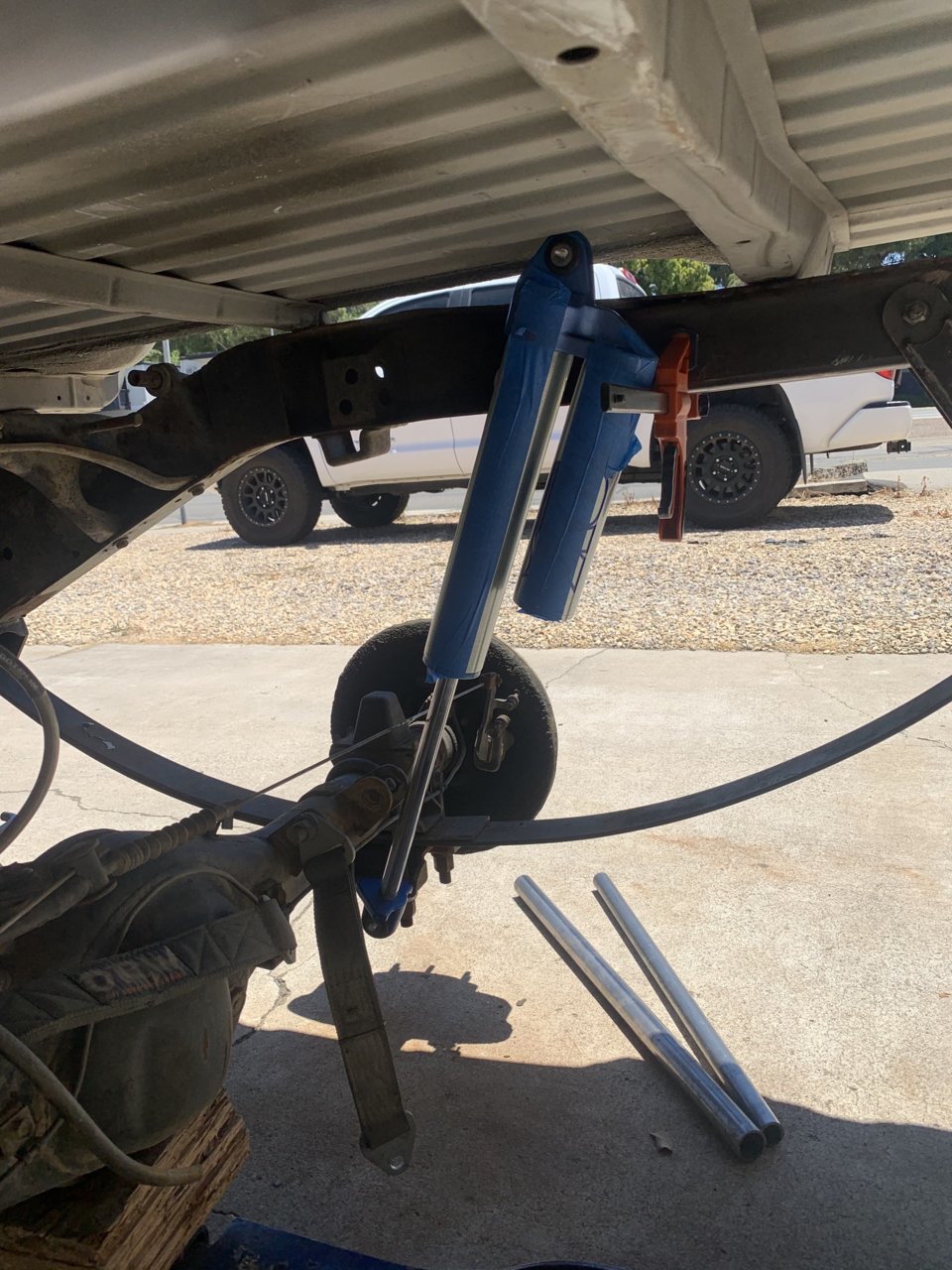

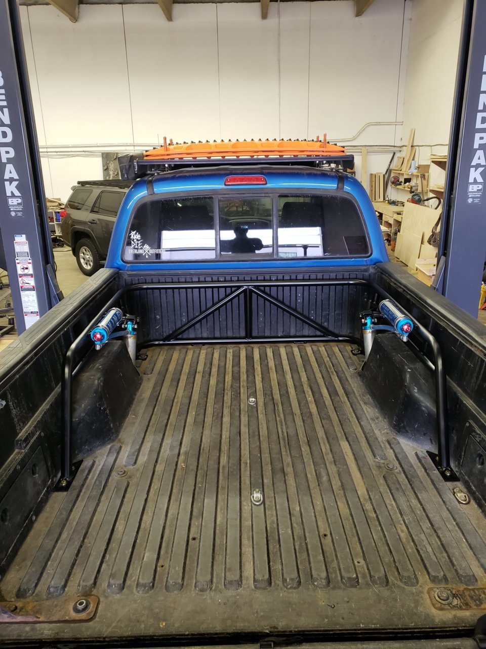

    I have a question for you guys who know way more about Lt than I currently do. I am getting JD fabs new front kit with the 934 axles, which is supposed to do around 13" of travel in the front. I currently run a 63 swap in the rear with 16" IBP kings through the bed that I built a custom bed cage for. Realistically I'm only getting around 12-14" of travel in the back which im pretty disappointed by. I'm around 4.5" of up travel with the rest as down travel. It rides great and flexes great, but I feel like I'm leaving a lot of travel and performance on the table. Any ideas how to get more up travel out of these leaves, or is there a Sua leaf spring that would fit the 63 swapped hangers? Obviously the leaves are wider than standard Tacoma ones.
    Really appreciate any help! I would love to get the full 16"+ in the rear to match up better with the JD fab kit that's going to go on.
