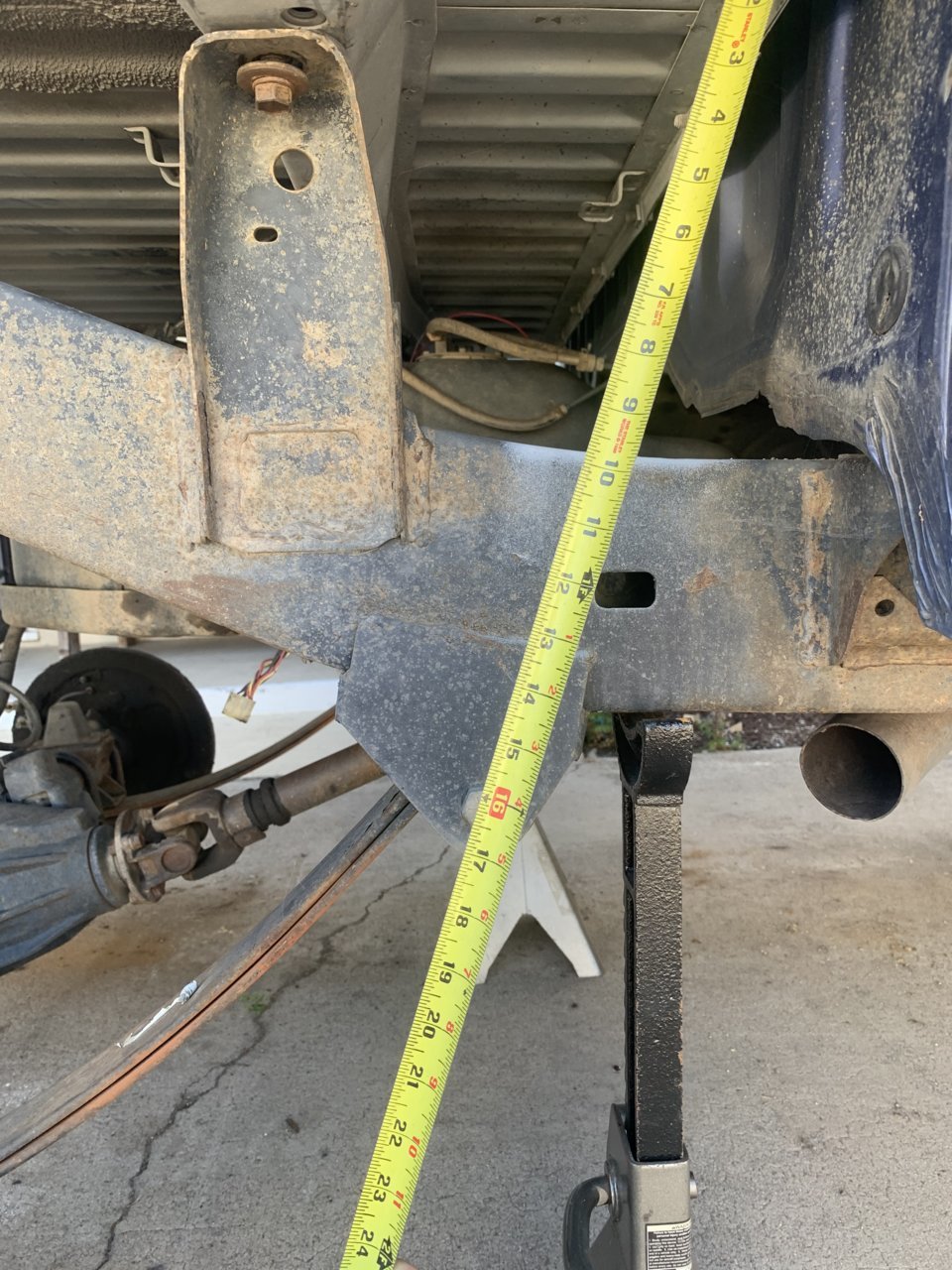

    I’ve picked up a pair of 2017 Fox Raptor shocks, they are 31” extended, 12.25” stroke, and 18.75”.
    3.0’s with a piggyback 2.5” reservoir.
    9 internal bypass zone that I’ve heard works pretty well!
    I got some DMZ lower tabs to mount them to the axle, but I decided on what to do for the upper mount.
    I’d love to do something like archive garage’s mount, but I doubt it’ll clear the reservoir and the 3.0.
    I think something like Total Chaos mounts will provide clearance.
    Will I be ok without a crossmember at the top of the hoop going through the bed ?
    Any ideas, recommendations, or pictures are appreciated !
