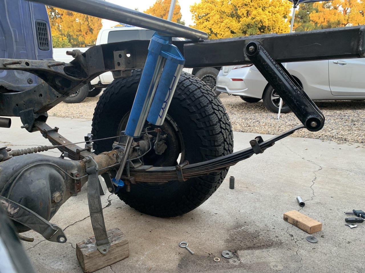

    meant to say behind not being lol... The top hat bolt in the back...

    Red loctite, a couple extensions and possibly a wobbly for your ratchet, take the lower shock bolt out and pull the shock body away from the shock tower so you can get your ratchet assembly behind the shock and tighten the nut from the top.

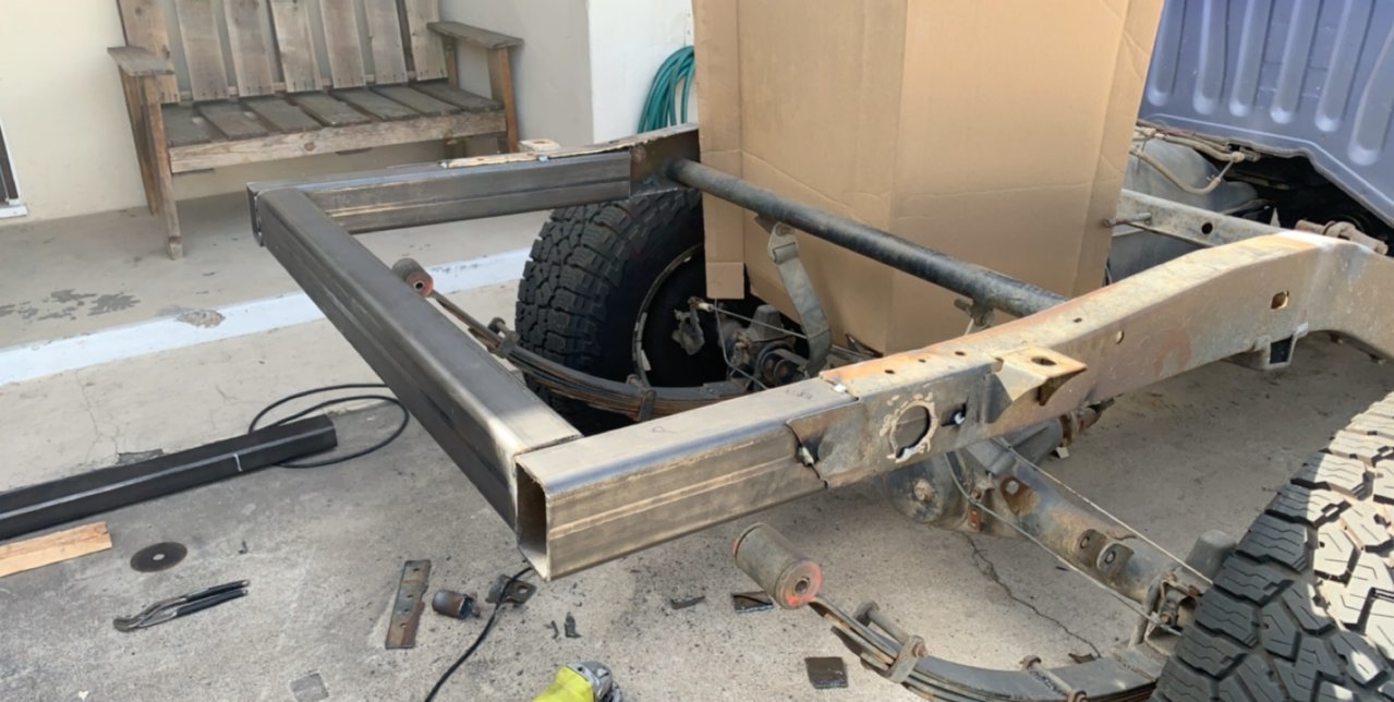

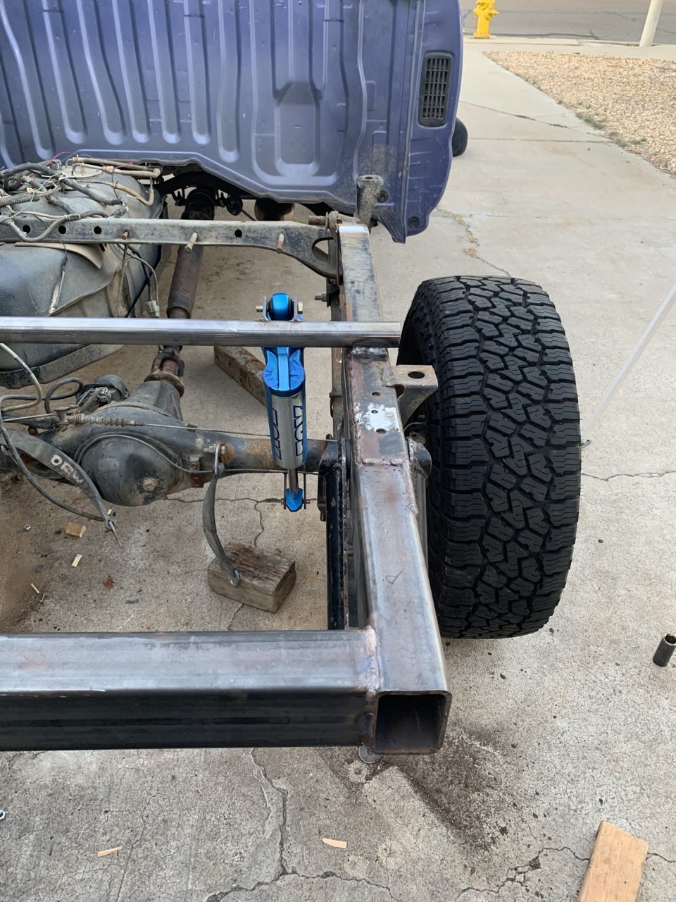

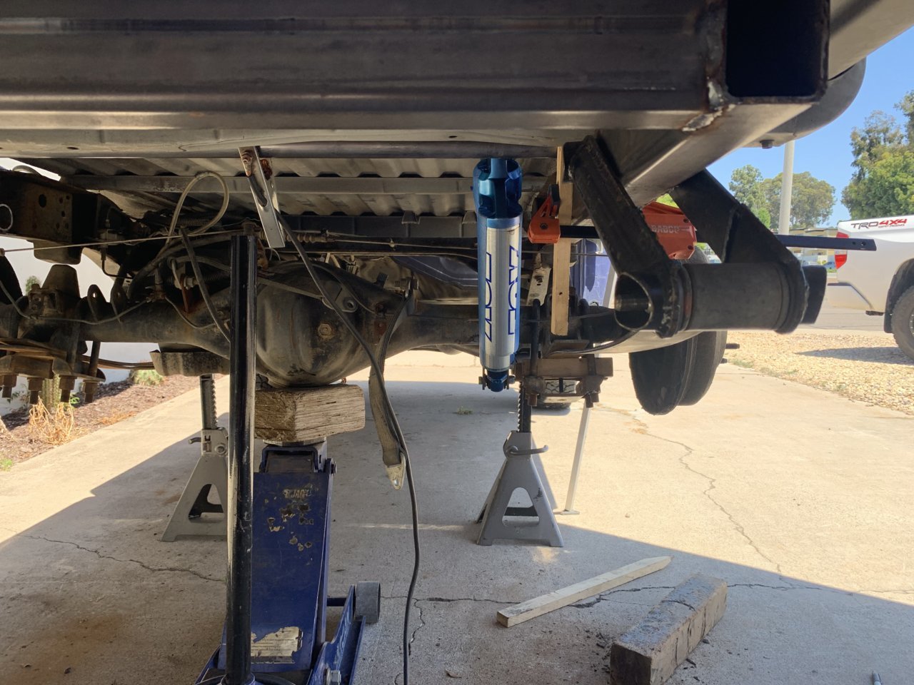

    Gen 1, so the 11.5" travel ones. Its all I could fit under the bed with a decent shock angle

    Nice. What springs are you using?
    And looks like you just kind of sleeved the frame with some tubing. that's pretty cool. What size?

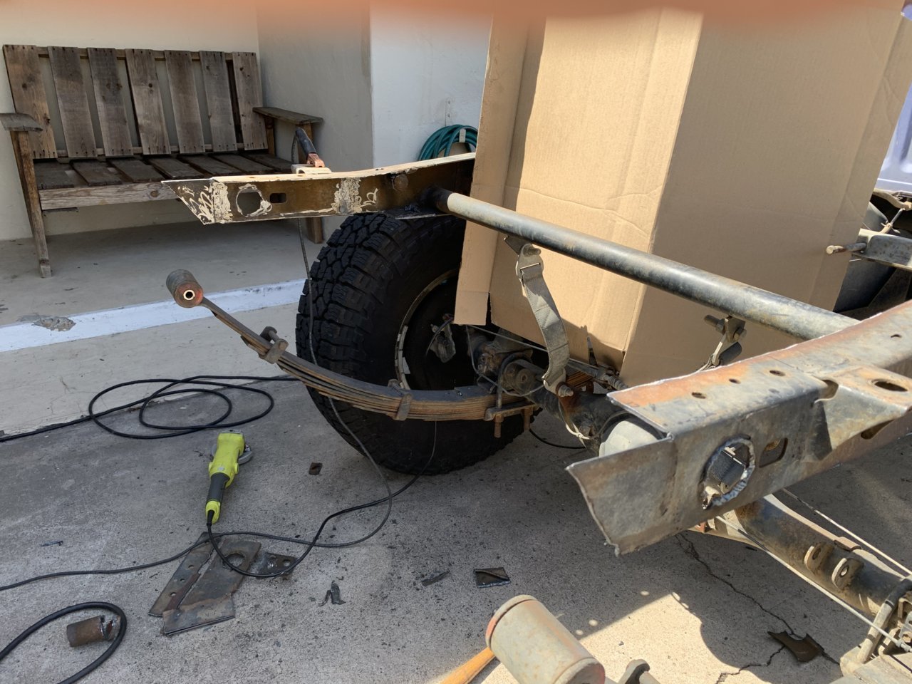

    More or less, yeah. I cut the "bottom" of the frame out for the length I was replacing, and then welded the "top" and "outboard" side of the frame to the new tubing which is 2.5"x3.5" .188 (closest I could find to stock frame size locally). The result was a heavier, beefier frame behind the axle to hopefully help work the leafs better...
    Cut 12" off the rear of the frame, and another 13" of the bottom to make room for the tubing
    Inserted 25" length of square tubing and welded to remaining frame rail
    This is correct, old F67, SUA, 12" shackles through the frame
    Also, I still have extra of the tubing in case anyone wants to do something similar. I have no use for the rest now haha
