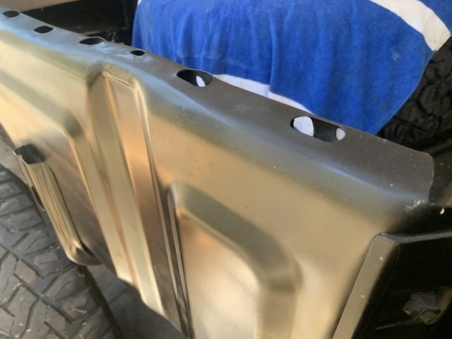

    Mainly wanted to see who drilled out the spot welds vs cutting out most the panel and leaving the spot welds

    Pm me Anthony did mine

    Yea i saw yours the panel was cut n spot welds were left

    You sure it was mine then?

    mare you installing bedsides on a 1st gen?

    Derp, didn’t see all the replies lol. They got you lined out it seems.
    It wasn’t hard. I did it with cut off wheel, drill, nail punch and a chisel :D
    a spot weld tool woulda been epic!

    Yeah the confusing part is there’s an inside skin on the bed rails that looked like I had left it from cutting but it’s the underneath part of the bed rail when you remove the exterior panels after spot drilling.

    I left the bed rail intake, cut it about 3” below bed rail and then separated spot welds at front and brake light areas.

    Maybe too late but a step bit made short work of the welds.

    I have a bunch of step bits, maybe ill try that

    I had cheap ones from harbor freight so ones with any semblance of quality should do the job no problem at all
