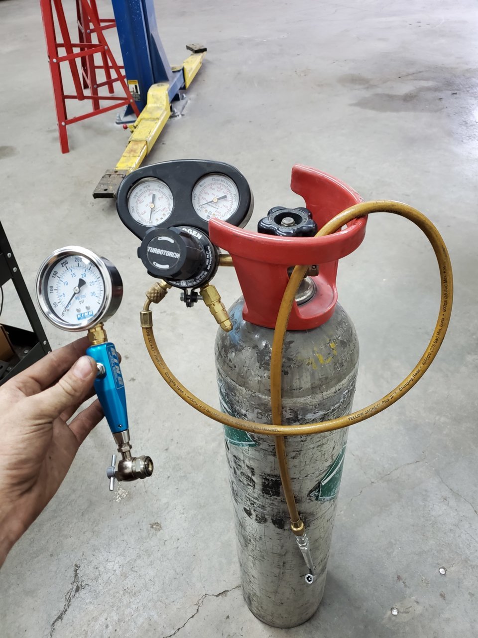

    This is my setup for nitrogen filling. Regulator doesn't matter too much if you have a good fill tool.

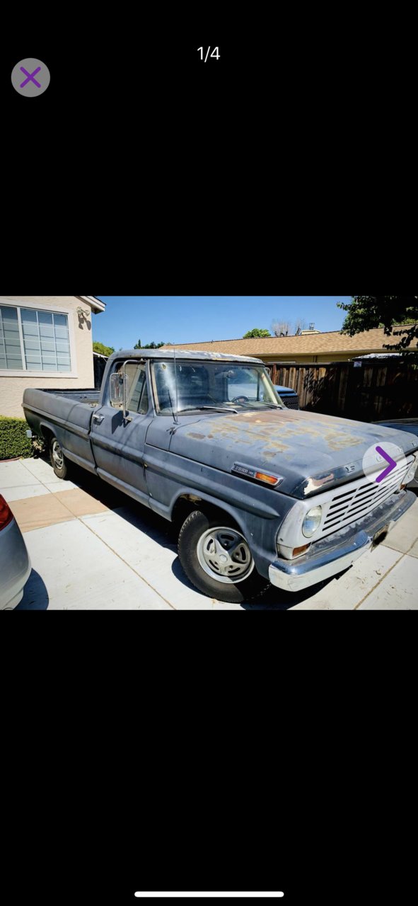

    If anyone’s looking for a brand new 96-04 camburg LT kit i’ll be listing mine soon for $2700. found a nice f100 for sale i’m going to build instead

    Let's see this F100! :drool:

    just need to sell this darn kit so i have the cash to get it :annoyed:
