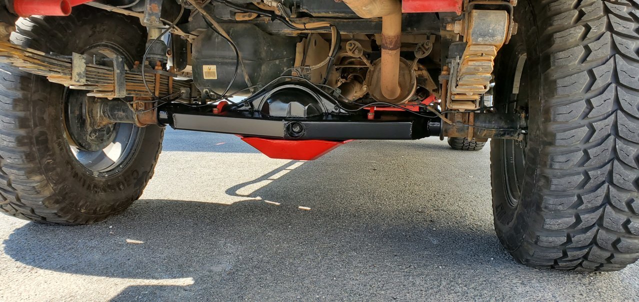

    You have any pics on one installed?

    Since you seen both trusses, Which truss setup do you prefer, dirt designs or ruff stuff?

    @Y2kbaja dirt designs makes a rear truss for out trucks.

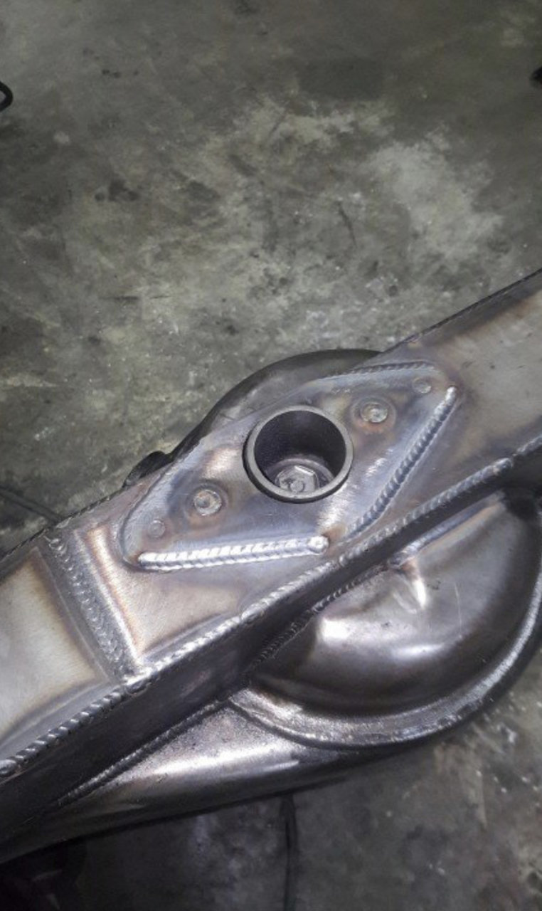

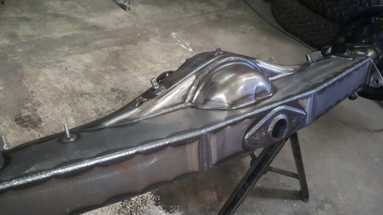

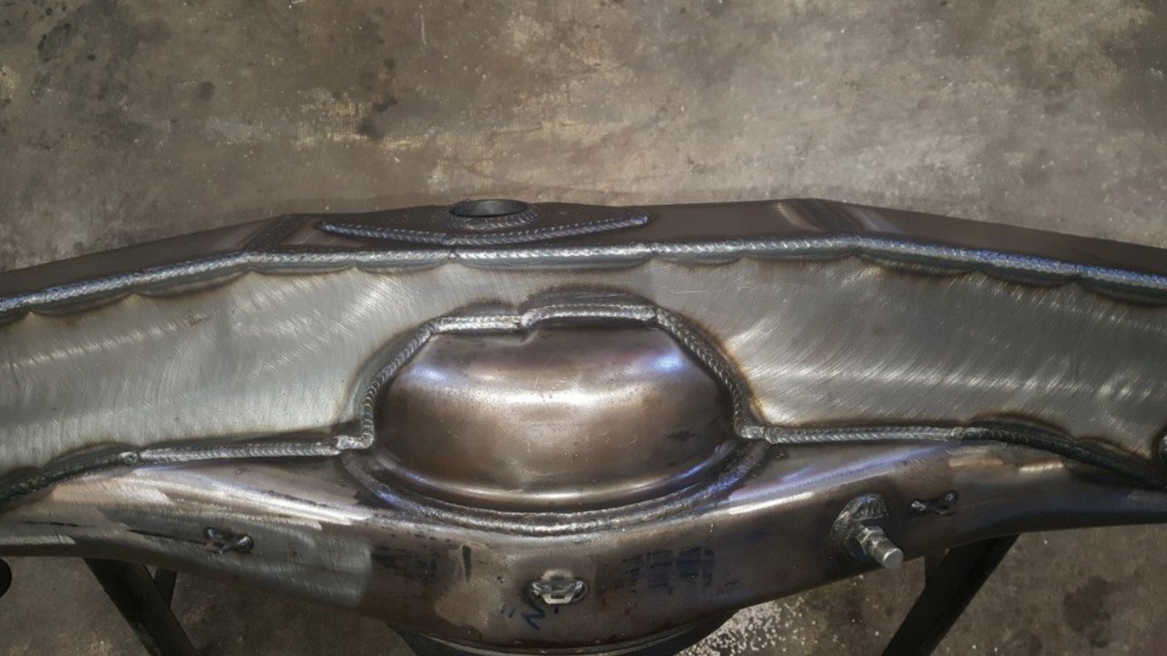

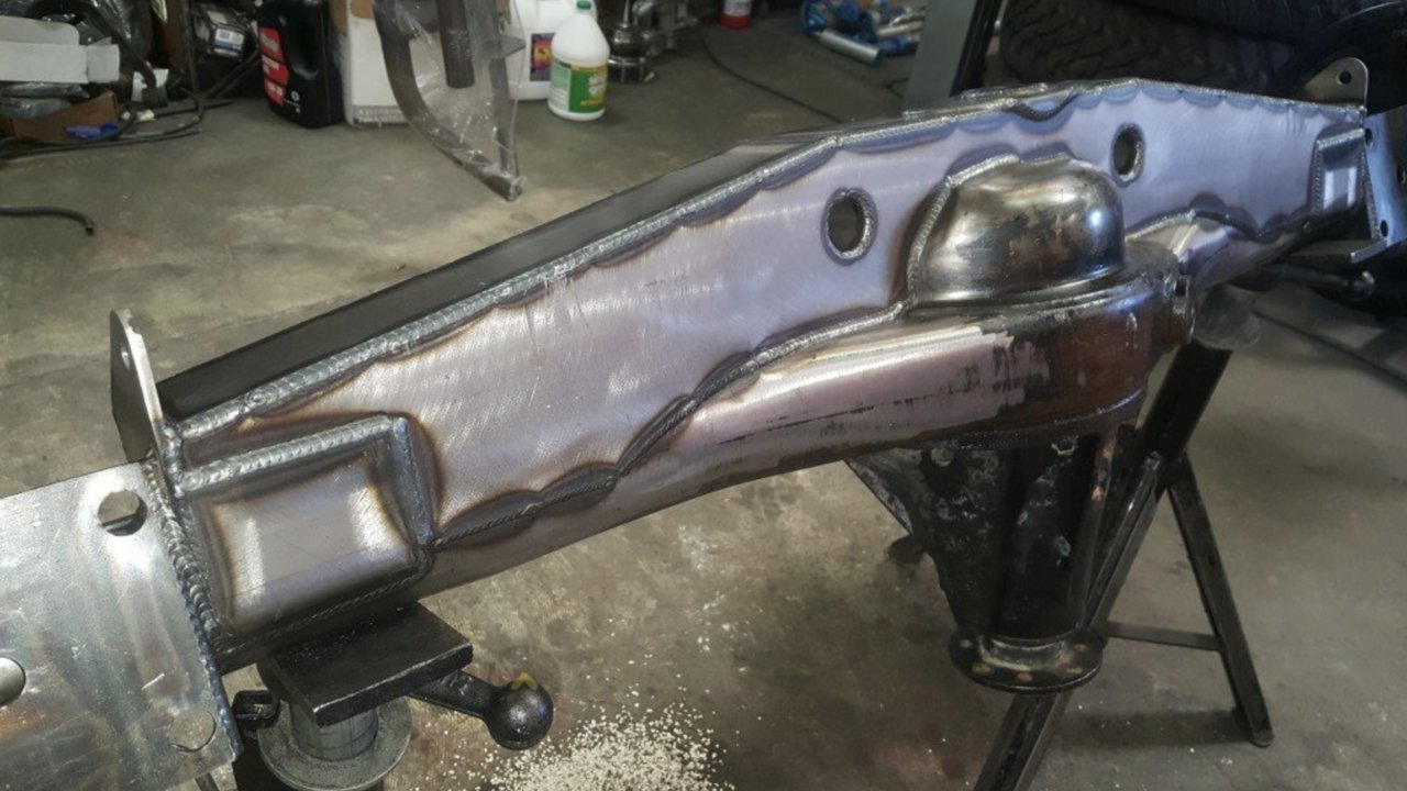

    I'm running the tundra 10.5 and my buddy is running the 9.5
    We got tired of bending housings and blowing gears. We're both running wheel adapters, stock calipers, and stock master cylinders, 1310 to 1350 adapter u-joints, and slid the carrier bearing forward to compensate for added depth.
    Running stock 4.30 gears from a 4wd tundra, I plan to swap in 5.29 gears and a LSD when I re-build it.
    Comes out to 88" with 37x13.50x17 w/ zero offset wheels.
    I want to get custom axles but they're kinda pricey. My buddy has over 1000 miles of baja pre-running on his adapters with no issue so far :anonymous:

    For my curiosity, Ya'll have any issues warping the housing doing that much welding on them? Are you building a jig, or is there another secret to it?

    It’s all @DTFtacoma work. I believe he did the slow and a little here and little there method.
