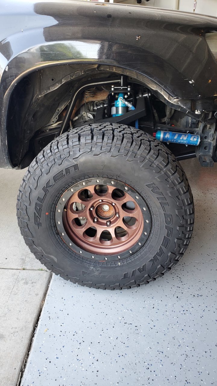

    I wish I paid $5000 for my truck... As for the Wilson’s, that particular rotor requires 17”. I saw one that was 6 piston that would work but as you said no mounting bracket.
    True, I wouldn’t mind switching to a 17” wheel and going with a 34” tire since that size is available. It’s just a hassle and I love my brushed copper ray10s, but they do come in 17” so it’s something to consider.

    Great discussion on brakes guys, I think I’ve made my decision to stay with a 16” wheel since I don’t plan on a rear disc conversion, if I did the wheel upgrade would make more sense. I’m thinking I’ll do the SOS 16”, 6-piston setup and upgrade the master cylinder and that should be enough. I’m only 33s so it isn’t so bad.
    In other news, someone just made a thread asking if they could pair an “LSK 3+ kit” with Rancho shocks.... I’ve seen everything now :rofl: Pretty sure LSK just makes the 4.5” over kit anyways.

    With 33’s yes you should stick to 16’s for more sidewall but if you ever jump up to 35’s the tire options for 17” are better and better priced.

    I definitely like the sidewall. After my falkens wear out, next tire I get is going to be a 295 for a 33.4, instead of with the 285, which is a 32.8. Tire price definitely "inflates" beyond that size. :evil: Seewhatididthar.
