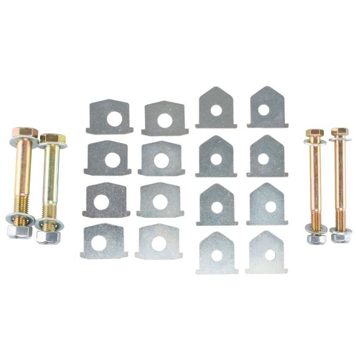

    I’ve got TC cam tab gussets and am going to be trying out these stop cams from Bison Offroad. Little less adjustment, but they won’t be able to rotate once installed.

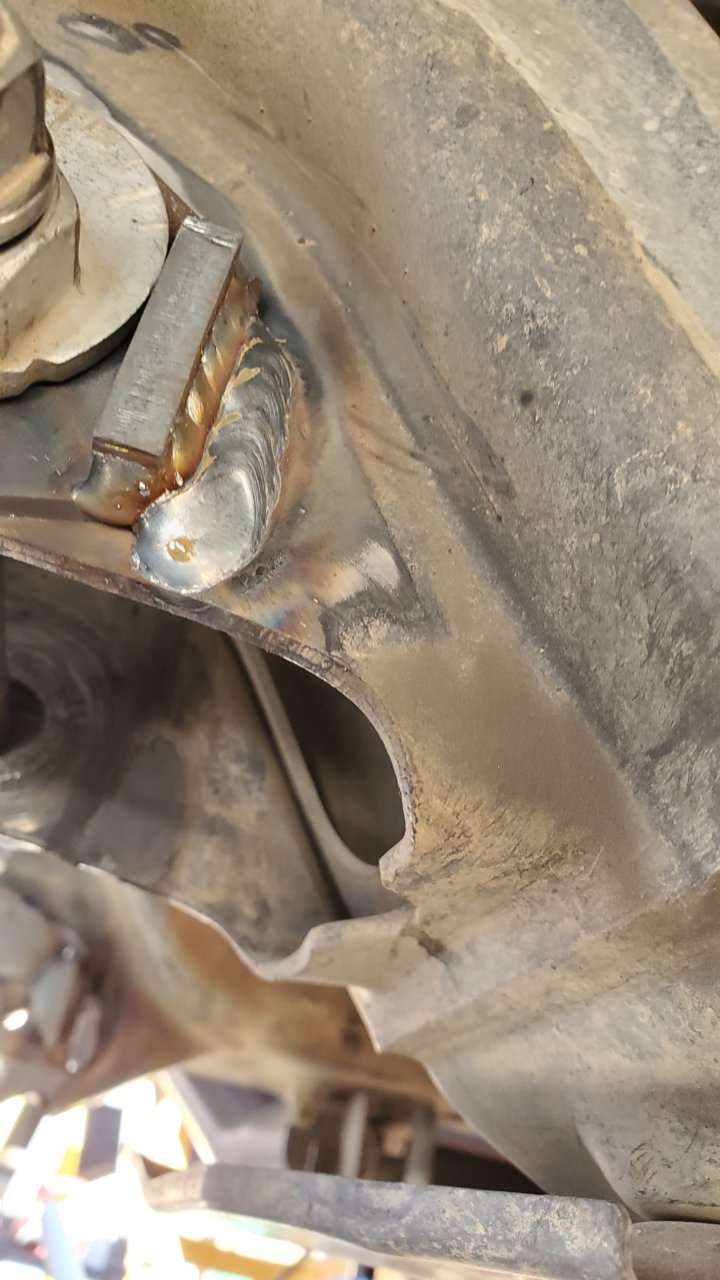

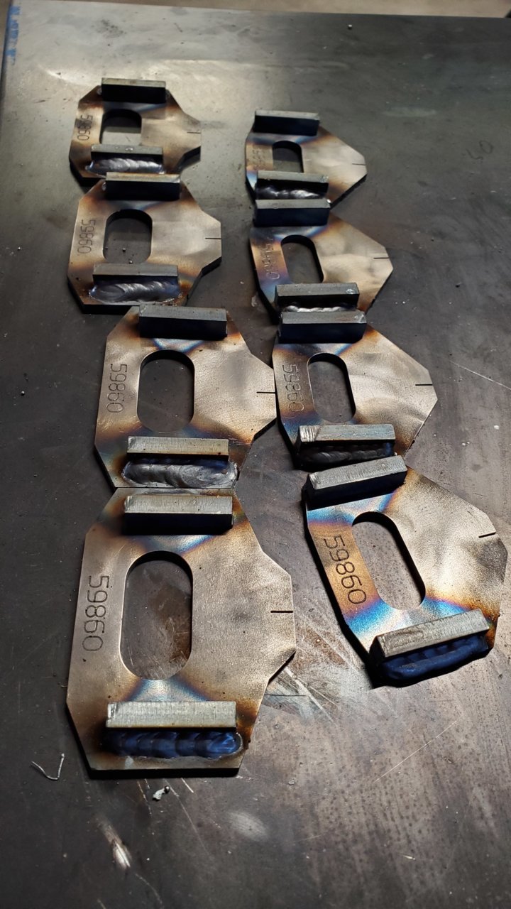

    Or you can just cut off all the LCA tabs and start over with new cam tabs that bolt in place when the alignment is done and the ability to move the lower almost 1 inch forward.

    What are you getting for before and after caster numbers - is that set bolt for the cam something you guys added after getting the kit?
    Airdog[QUOTED] likes this.

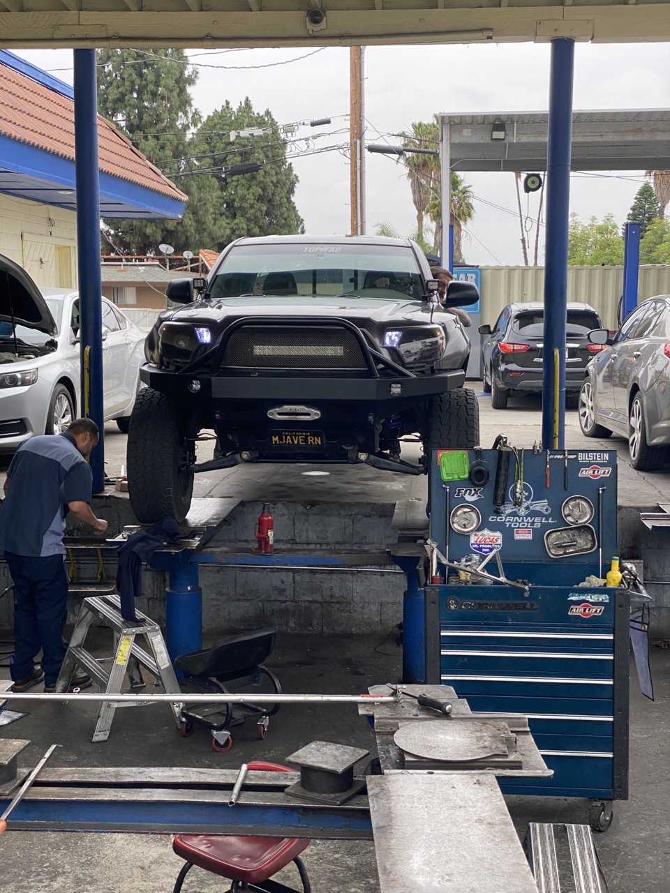

    My previous caster numbers were in the 3.5-4.5....this setup I forgot to ask the guys that did the alignment but i'm in the 6* range right now when I did a quick check. Bear alignment in corona CA where I go does not have the high tech shit..its all old school and done right by guys that know exactly what they are doing. The set bolt is part of the kit. After you get the alignment done you drill it out and put the bolt in place to hold it.

    i have mine set to neutral in front, max caster in rear and then i adjusted for slightly more caster with my upper heims before slipping the bolt in.
    Alignment came back with 5.8* caster and ever so slightly negative camber and then they set my toe. Its perfect.

    They will. May charge a little bit extra though. They charged me a bit over 100 bucks but he had to remove 2 of my LCA bolts to flip the cams over....something almost any other alignment would not ever do.
