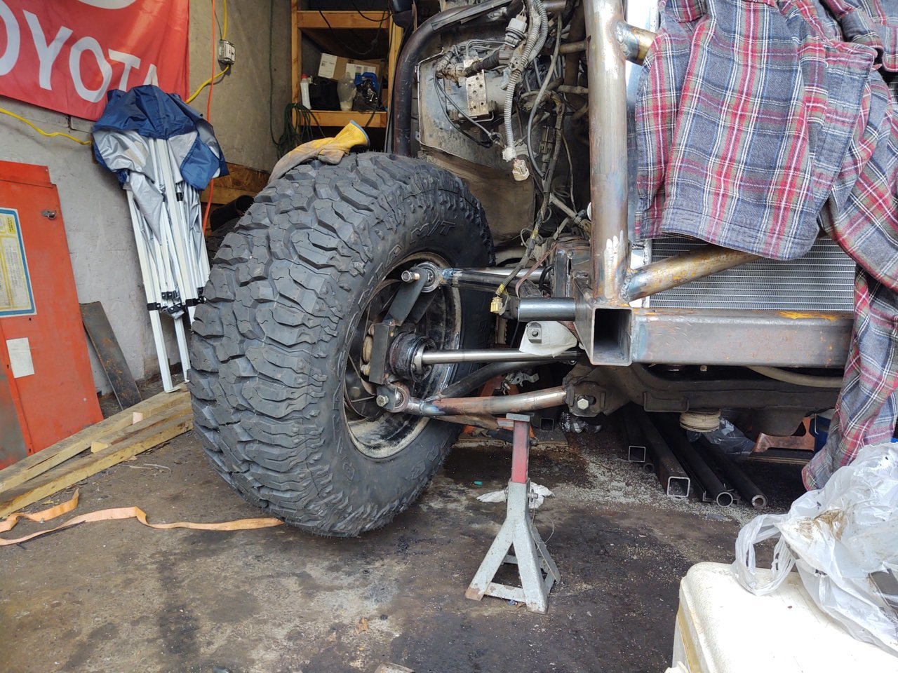

    Only a mock-up, but that's officially long travel.
  9. Sep 15, 2020 at 7:43 AM
    snowsk8air2
    snowsk8air2 how hard can it be?
    Sep 16, 2011
    #63607
    10,537
    Flagstaff, AZ
    Supercharged TX Pro
    2011 S/C and basic mods
    That some sort of reverse j arm for the upper?
  10. Sep 15, 2020 at 7:57 AM
    Arcticelf
    Arcticelf Well-Known Member
    Jul 18, 2015
    #159735
    7,662
    Gladiator
    Got it in one.

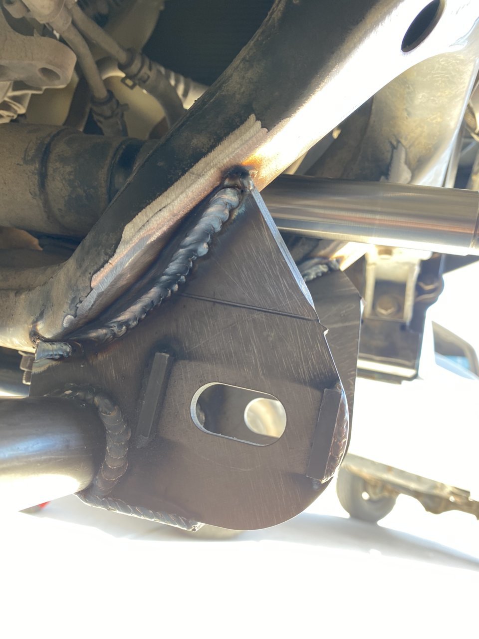

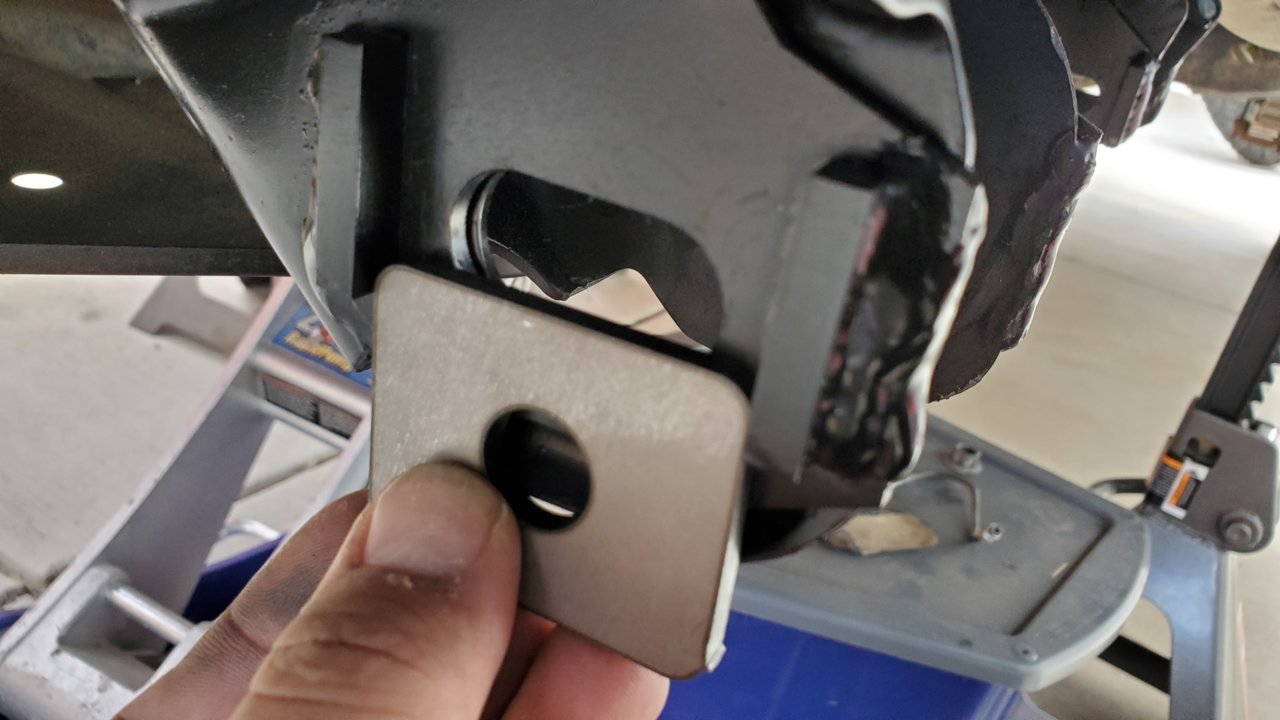

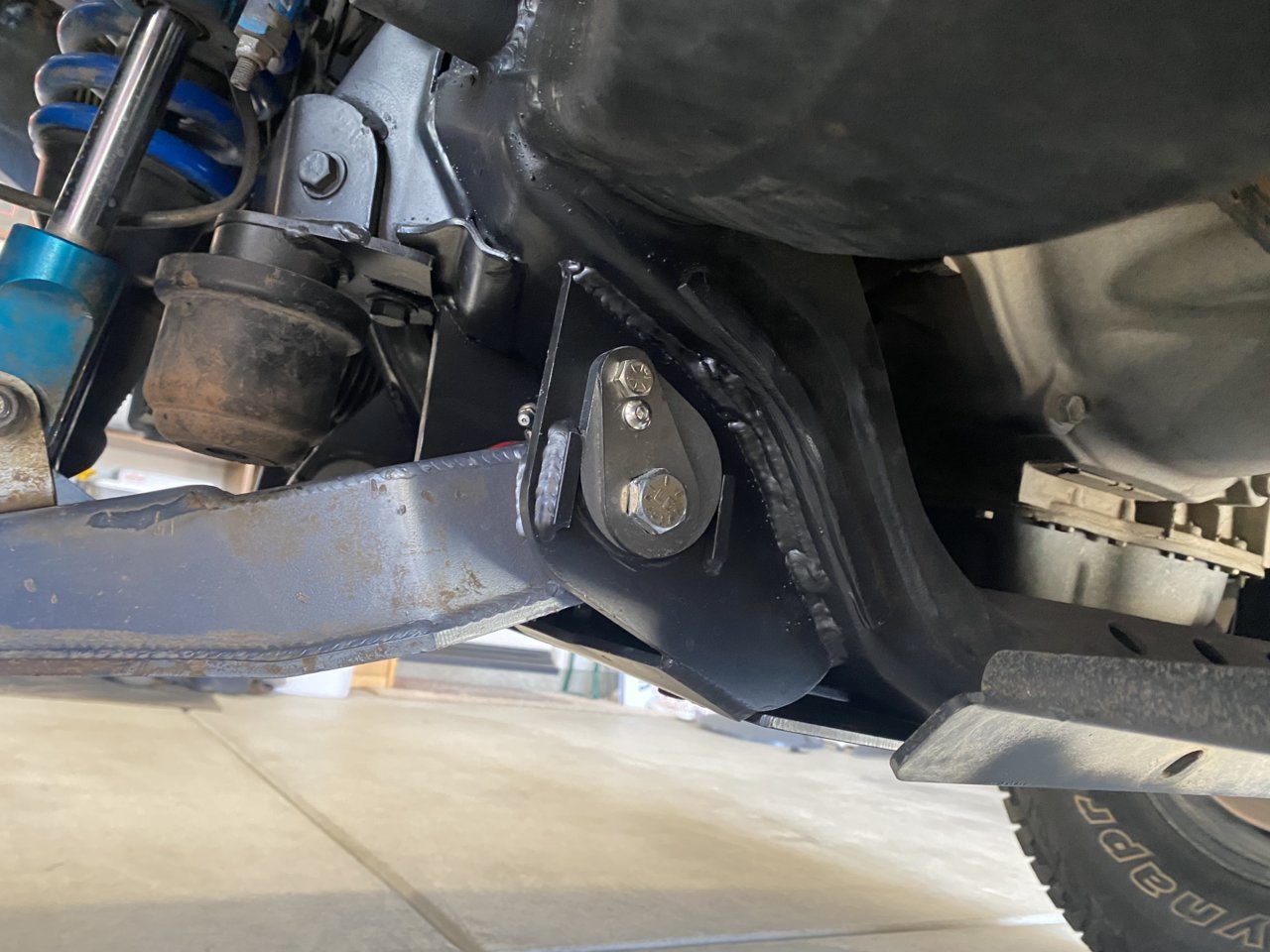

    The great thing about that kit from JD Fab is that you can push the LCA around an 1 1/2” forward to help clear the firewall and cab mount etc. The LCA tabs are spread wider and they supply billet spacers for positioning the LCA between the tabs. If you use that kit along with one of their long travel kits you can push the LCA all the way forward because their UCA has the geometry to account for it. Check out all the info on their website because I’m probably butchering some tech terms lol
    They only have a +2 kit on their site right now (...which if you use their 934 cv’s pulls as much travel as most +3.5 kits @13” ) but they have a +4 kit coming soon...I asked them to build it so I am getting the first one in a couple weeks :D
    They also have a steering slide rack and heim’d double sheer spindle gusset kit and a bunch of other well thought out details so I’m going all in...
    +4 kit
    Steering rack kit
    Custom sec’d bypasses
    LCA tab kit
    Here is their website : https://jdfabrication.com/collections/05-15-6-lug
    @81Trekker ’s thread here on TW : https://www.tacomaworld.com/threads...g-now-adding-long-travel-and-934-cv’s.626274/
    Here are some pics I’ve saved :
    In this pic you can see the sealed uniball lowers and how they are spaced in the LCA tab kit & you’ll notice they use an HD high angle sealed greasable ball joint in the UCA and LCA. Check out the configuration of the bypass tabs on the LCA, no worries about backspacing and the back of you rims hitting the LCA or the tab. The truck they mocked it up with had 5” backspacing rims :
    See how the LCA has that pocket for the CV, allows both more ground clearance and more clearance for the CV at droop, this one of their custom 934 CV’s :
    They offer a few different bushing options but this is their sealed uniball for uppers and lowers :
    Slide rack kit, the clevis is offset so everything lines up properly with the double shear kit at the spindle to prevent bump steer :
    Here is their gusseted spindle w/ the double shear Heim steering set up, spindle is drilled out for a straight bolt for the Heim mis alignments :
    The LCA tab kit :
    As @Airdog showed the lowers end up basically solid mounted after alignment and with the uniball lca’s on the JD Fab LCA’s there is no bushing binding going on :
