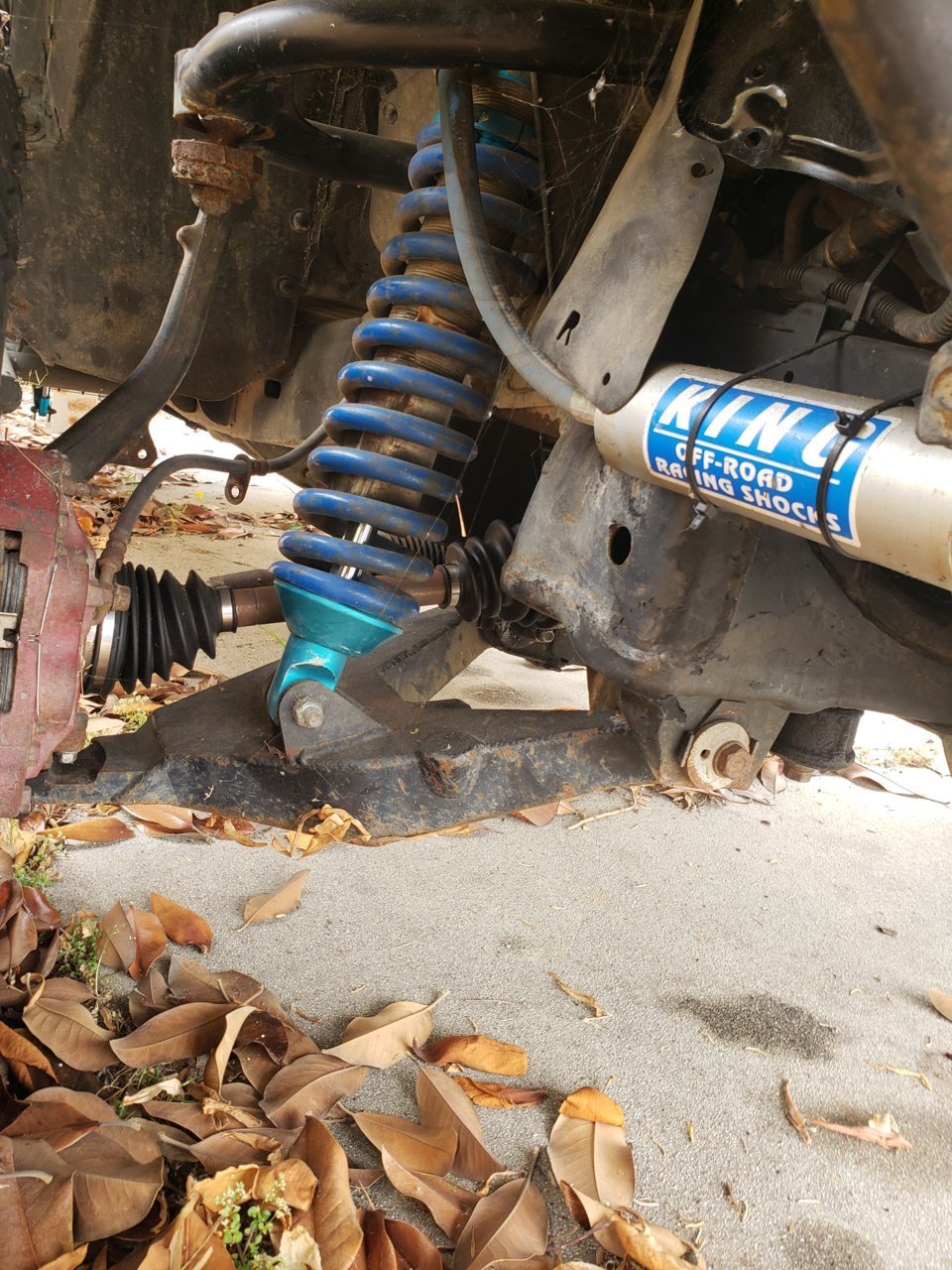

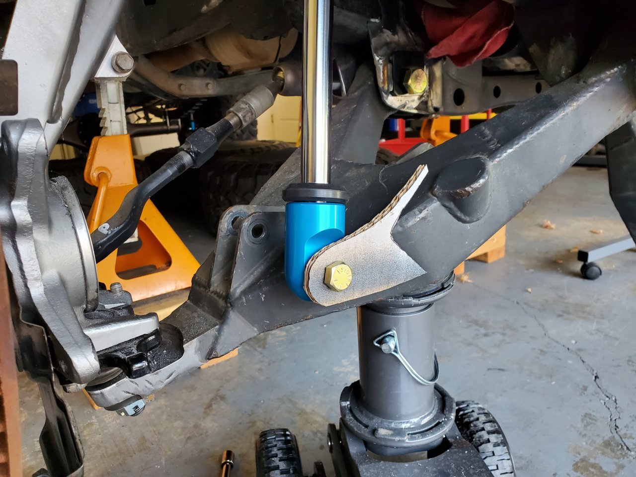

    I'm working on setting up and old 2wd camburg kit on my 4wd 1st gen and need to move the lower shock mounts. The kit hits full droop before the shocks run out of shaft so I'm thinking of moving the shock mounts to allow both the shock and kit to be at full droop at the same time and turn the extra shock travel into more up travel. It just seems kinda odd having the shock hanging off the lca vs the other 1st gen setups I've seen.
    Here's the same kit converted by someone else. I'm not sure how they have the shock mounted more towards the top of the lca and still cycle any sort of travel unless they are short body shocks.

    Is that other kit using the coil buckets - it could have custom shock mounts and it looks like they might be running dual rate coilovers, not a short body 8" from what I can see.
    If you run the lower mount further away from the frame to get more travel out of the shock you'll have to run a lighter spring to achieve ride height if you don't want to have more preload than in the original location. This also potentially limits travel if you're unlucky with how your spring rate / length options aren't optimal in maximizing travel.

    Sounds like I want to keep it as inboard as possible. The kit only cycles 12.5" and that's bottoming out on the inner fender. I think I can jist split the difference to gain some additional up travel but not put the lower mount too far outboard.
    What do you think of it hanging off the front of the lca though? I've never seen that done but it seems like what needs to happen to get the full travel out of it.

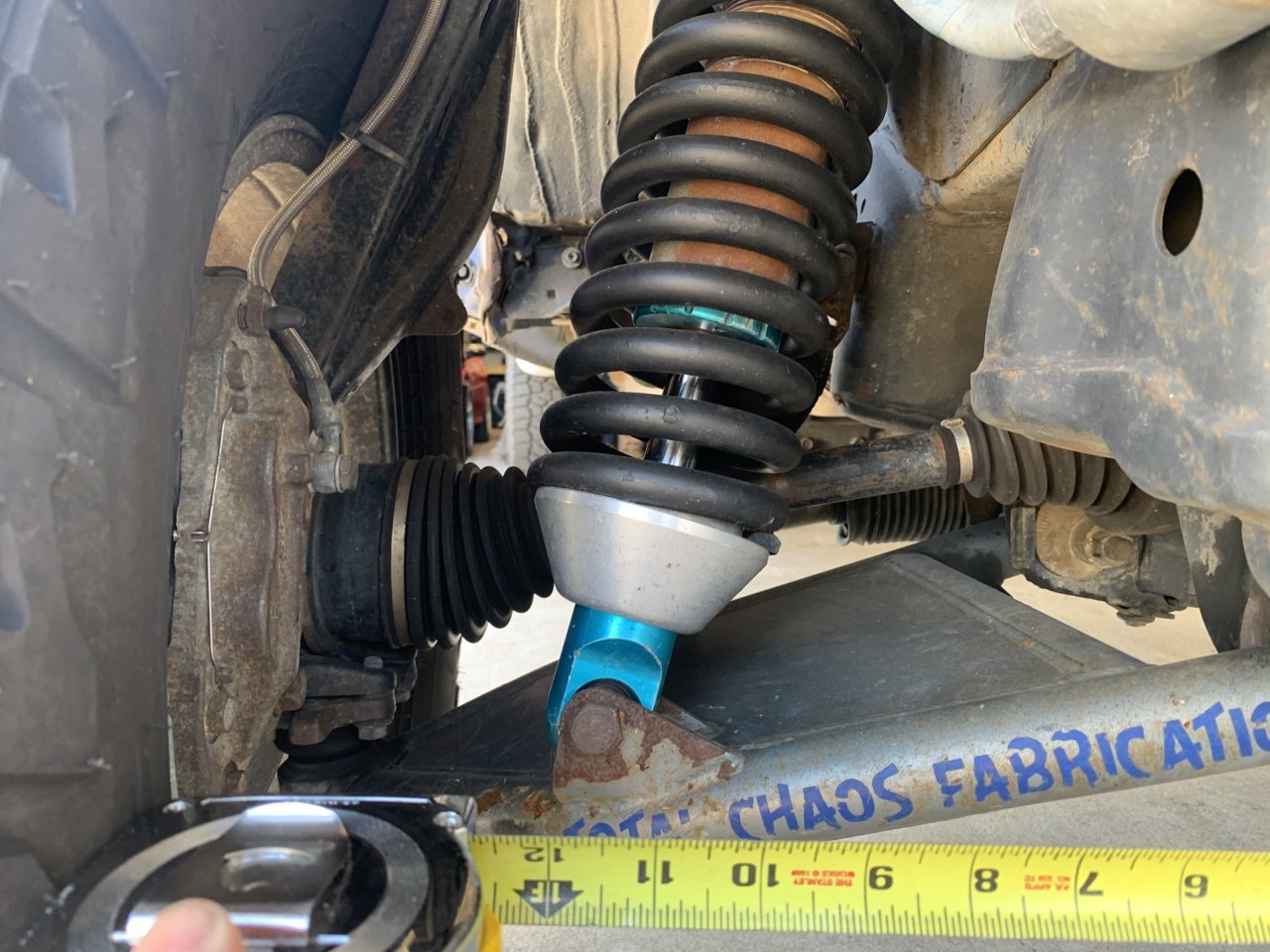

    Slightly different since mines TC but 11.5" from mid cam bolt

    Good to know. I'm looking at probably 12.5"

    Interesting - mine are about 11” but they’re probably higher up too.
    If you box that shock mount in it would be ok.

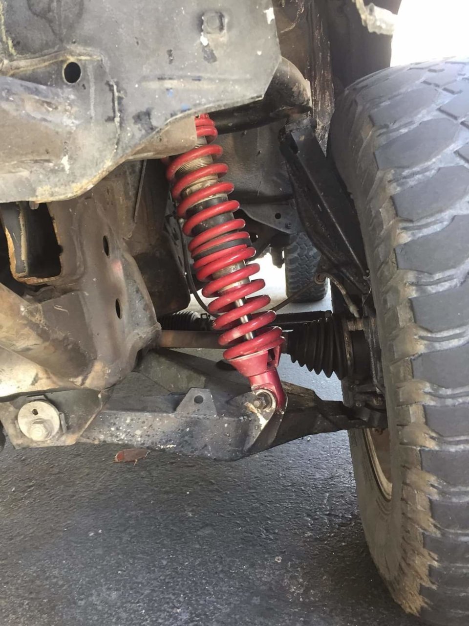

    Yeah that's what I'm going to have to do. I found another kit with the same thing done. I think they were just set up poorly though. He's at ride height but it sure looks like he has no up travel.

    Looks like the 2wd version tapers down earlier, and has more of an "extension" sticking out towards the balljoint. Thinking that may be where the awkward placement is coming from, that 4wd arms are wider than 2wd to accommodate the shock location
