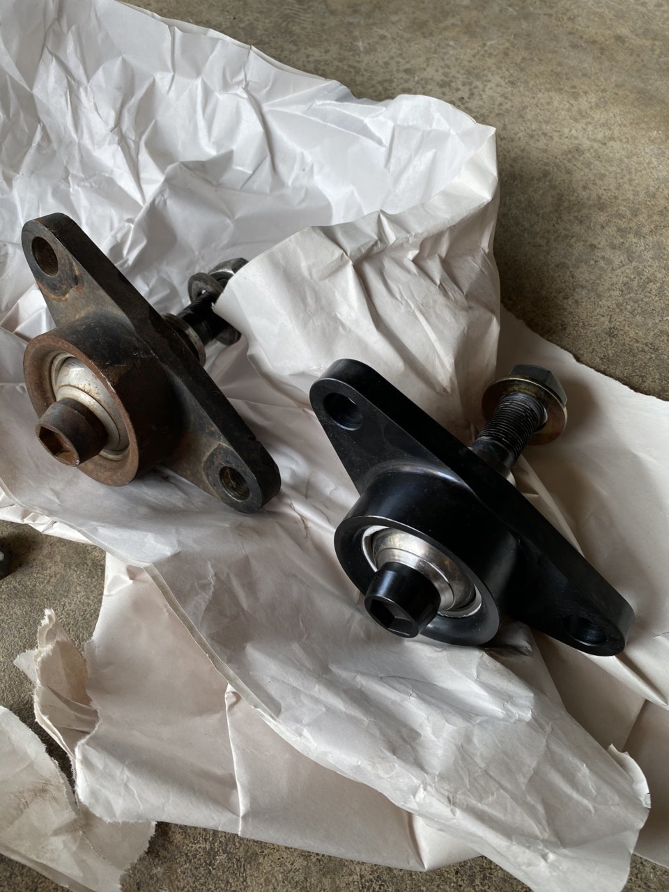

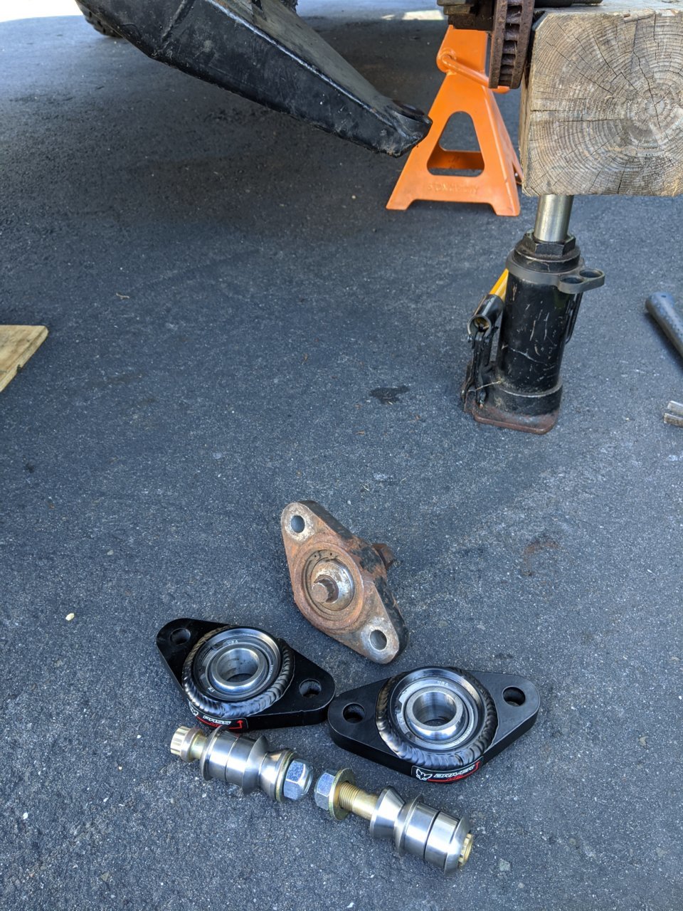

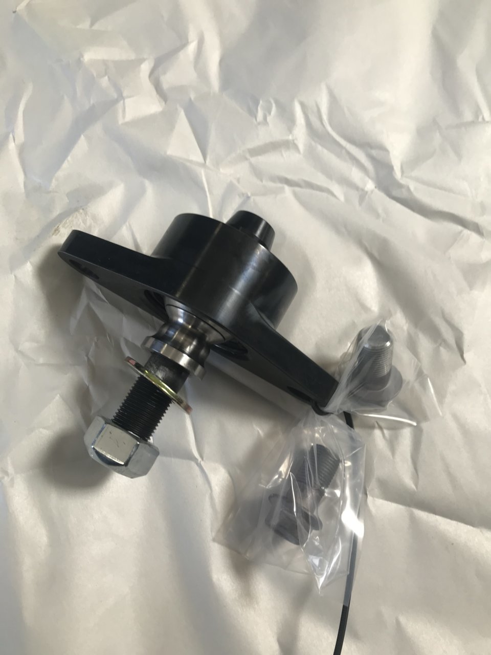

    I was an idiot and installed a part upside down. The weight of the truck was on a snap ring rather than a solid welded ring. Felt only slightly better to find out that Camburg had once made the same mistake on one of their own rigs. That was an expensive 13 miles at Primm after towing from NJ.
    Funny timing -- I'm actually refreshing my whole truck and just replaced the LCA uniballs last weekend.

    when covid hit i did the same
    Figured might as well since they where looking a little rough
    Just wish they where powder coated like the camburg

    yup and now that tool stays in my trucks tool box unless i let one of the local members borrow it for when they need to replace their uniballs

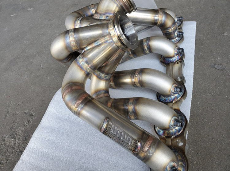

    It would require a great amount of work and skill to be done properly. TIG welding, and then being about to squish & hone the body to make sure it’s round again from the heat distortion. Not something most people can get done correctly.

    He makes turbo manifolds :gossip:

    was not aware of that but that’s also why I didn’t say it wasn’t possible. Just not something your average Joe can do at home.
