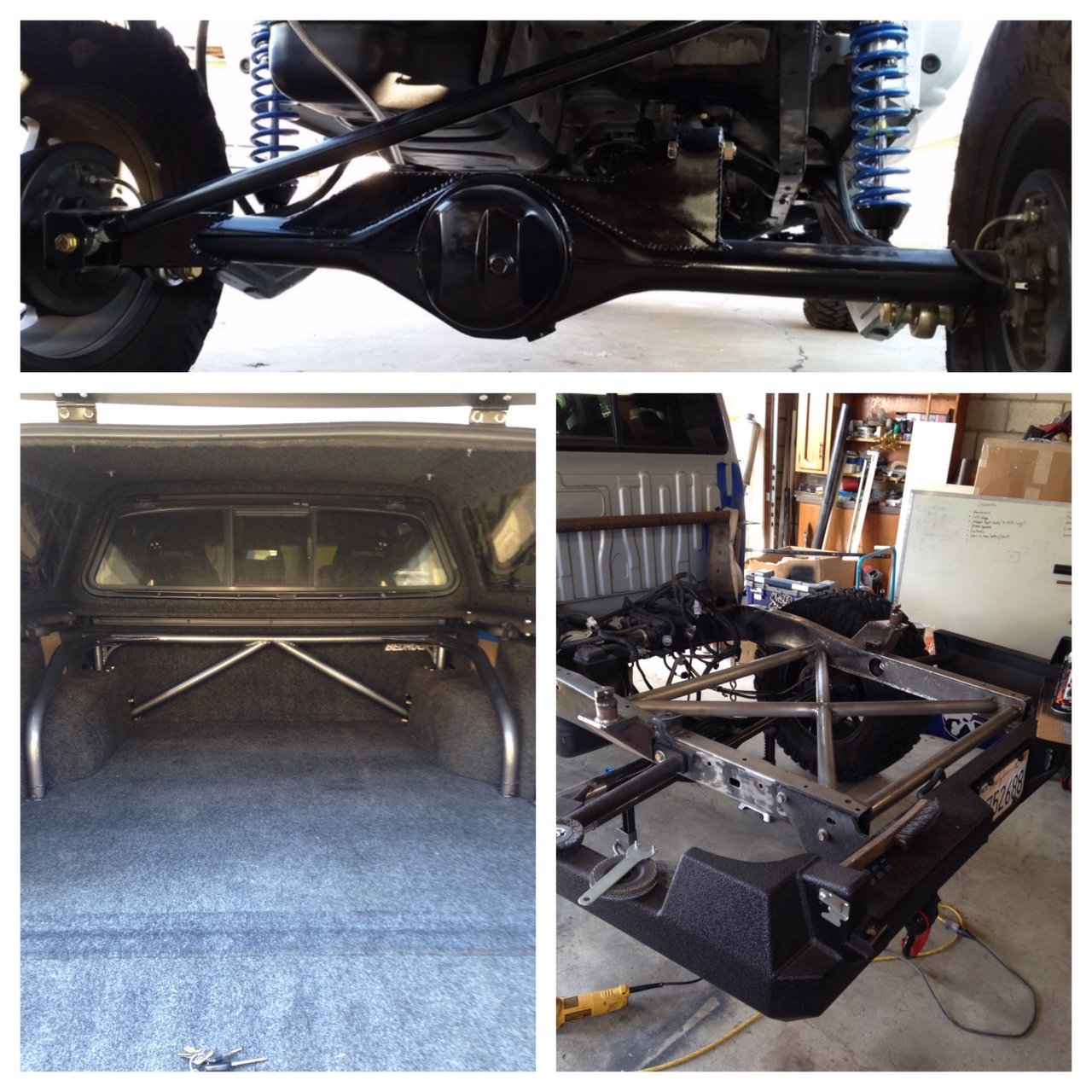

    You don’t have to loose much bed space, here is my 3 link using 12” CO’s with towers that tuck under the bed. bed cage then bolts through the bed in two places for each tower. This nets 20” of travel :
