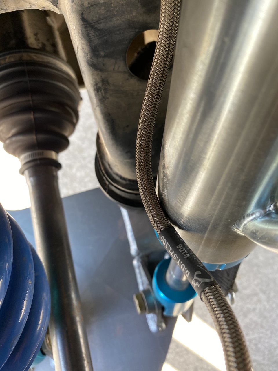

  16. Oct 26, 2020 at 9:10 AM
    LTDSC
    LTDSC 32oz of fun
    Apr 7, 2013
    #101544
    13,385
    Sam
    NorCal
    Get LT they said. Secondaries are fun they said.
    Gotta mess with the frame mounted bracket to bend it away from the shock body.
    Arcticelf and desertjunkie760 like this.
  17. Oct 26, 2020 at 9:55 AM
    Evenflow
    Evenflow Well-Known Member
    Jul 15, 2013
    #108344
    5,767
    Jason
    San Diego, CA
    06' DCSB 4x4
    Yes
    you might want to consider doing what I did amigo, rip out all the oe lines hard and soft from that block on top of the frame all the way to the caliper and get a custom line from crown and route it frame - uca - spindle
    not_nick, Arcticelf and Dalandser like this.
  18. Oct 26, 2020 at 9:56 AM
    LTDSC
    LTDSC 32oz of fun
    Apr 7, 2013
    #101544
    13,385
    Sam
    NorCal
    thats what i might end up doing. I saw on IG someone else did similar and looks a lot better and free from the shock.
    Remember off hand how long you went?

  20. Oct 26, 2020 at 10:04 AM
    LTDSC
    LTDSC 32oz of fun
    Apr 7, 2013
    #101544
    13,385
    Sam
    NorCal
    thanks for holding out on me, jerks!
