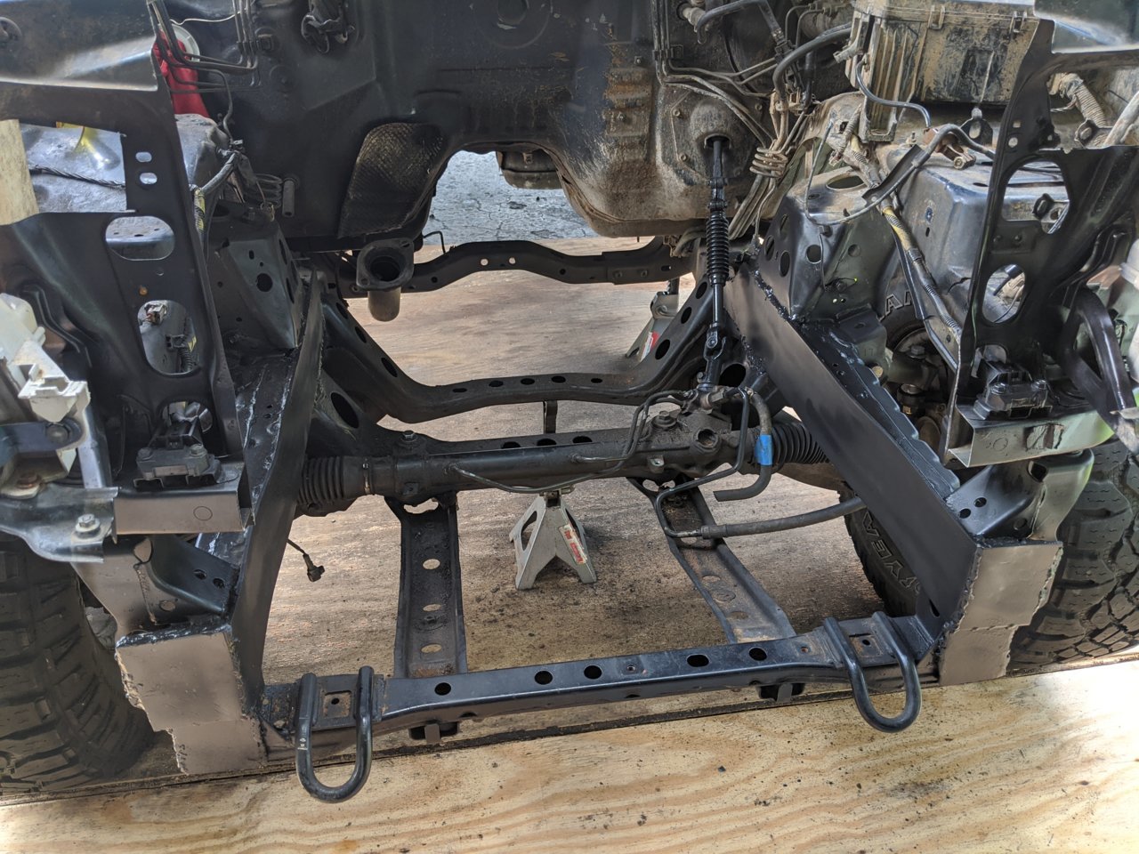

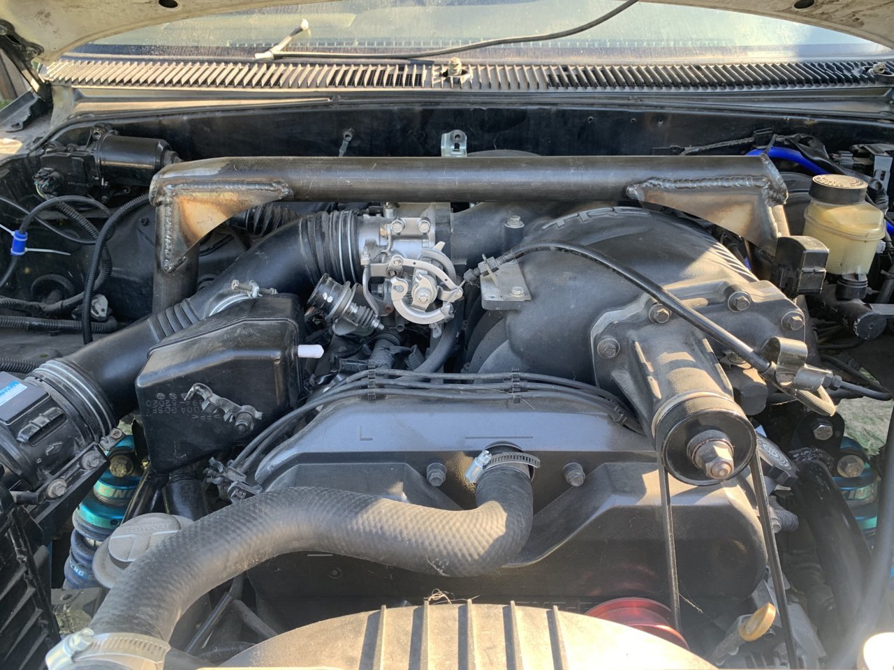

    Strut brace just goes up and over connecting the shock towers. Engine cage usually is tied into a cab cage and provides much more structure and support of the frame as a whole

    Ahh ok so even if I add extra bracing it would still be a strut brace until I add a cage.
    Thanks

    I mean you can call it what you want. The more structure the better it will be. If it “cages” the engine then I’d probably call it an engine cage. It’s just typical from what I’ve seen that when it comes to that point the vehicle has a cab cage to tie it into. The engine swap puts you in a spot where it may be beneficial to do the engine cage now and leave it able to tie into a cab cage at a future date

    Putting something substantial from one coil bucket to the other helps to keep the frame from spreading at the motor mounts if you’re taking big hits - primarily this is what the engine cage is going to do along with creating upper mounts for suspension stuff like coilovers, bypasses etc. and making solid mounting points for accessories such as the fuse box, rad, etc. If you’re not going to jump or take huge bumps going fast or do big rock crawling runs just a coil bucket brace would be a good addition. I don’t have a bender and I added gussets to something my friend made out of .120 1-3/4 to keep it as resistant to flexing as much as I could.
