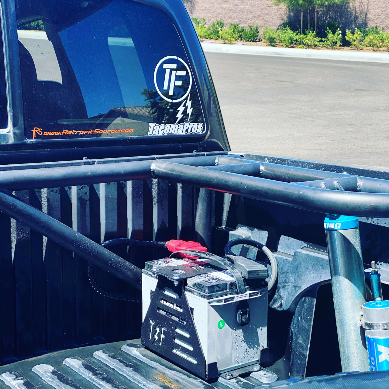

    https://www.tacomaworld.com/threads/airdogs-2012-prerunner-access-cab-slow-build.264263/
    Tacomapros.com. I can send you a list later of the rest of the parts needed to do it D2608A5C-56F8-4E7D-83B6-EB401F8317F6.jpg

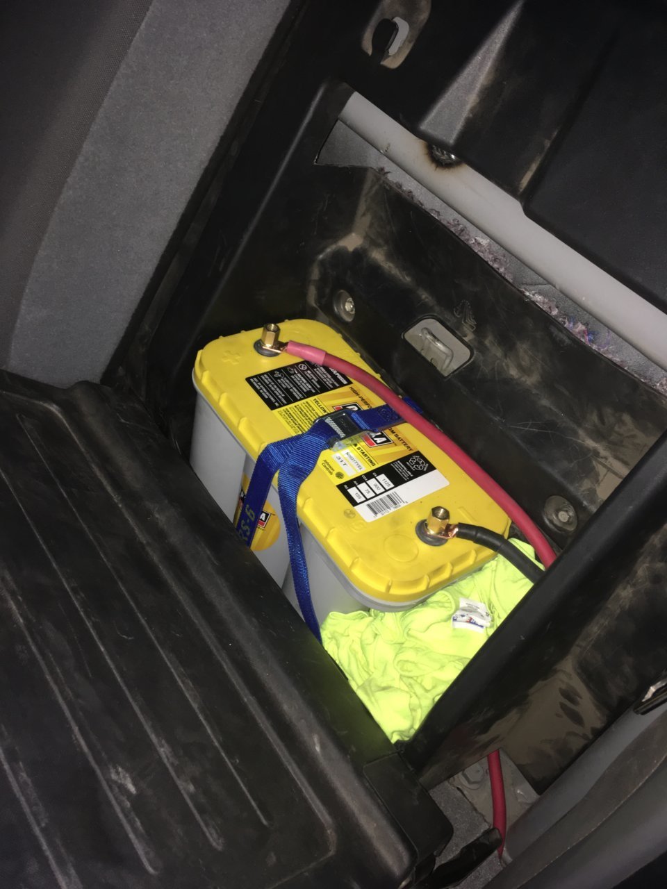

    What type of battery do you have? If it’s an agm like an optima, you can throw it in the cab.
    I thre mine behind the drivers side rear seat. It’s really snug in there and probably doesn’t even need the strap around it. But I threw it in to be safe.
    Otherwise there’s lots of battery box options out there that could bolt in the bed. Just search and make sure it fits the dimensions of your battery.
    For cables I just measured and guesstimated the lengths and had my local Napa make them.
    Summit has this remote terminal kit that I threw in the engine bay to keep easy access for jump starts and what not. https://www.summitracing.com/parts/aww-500931
