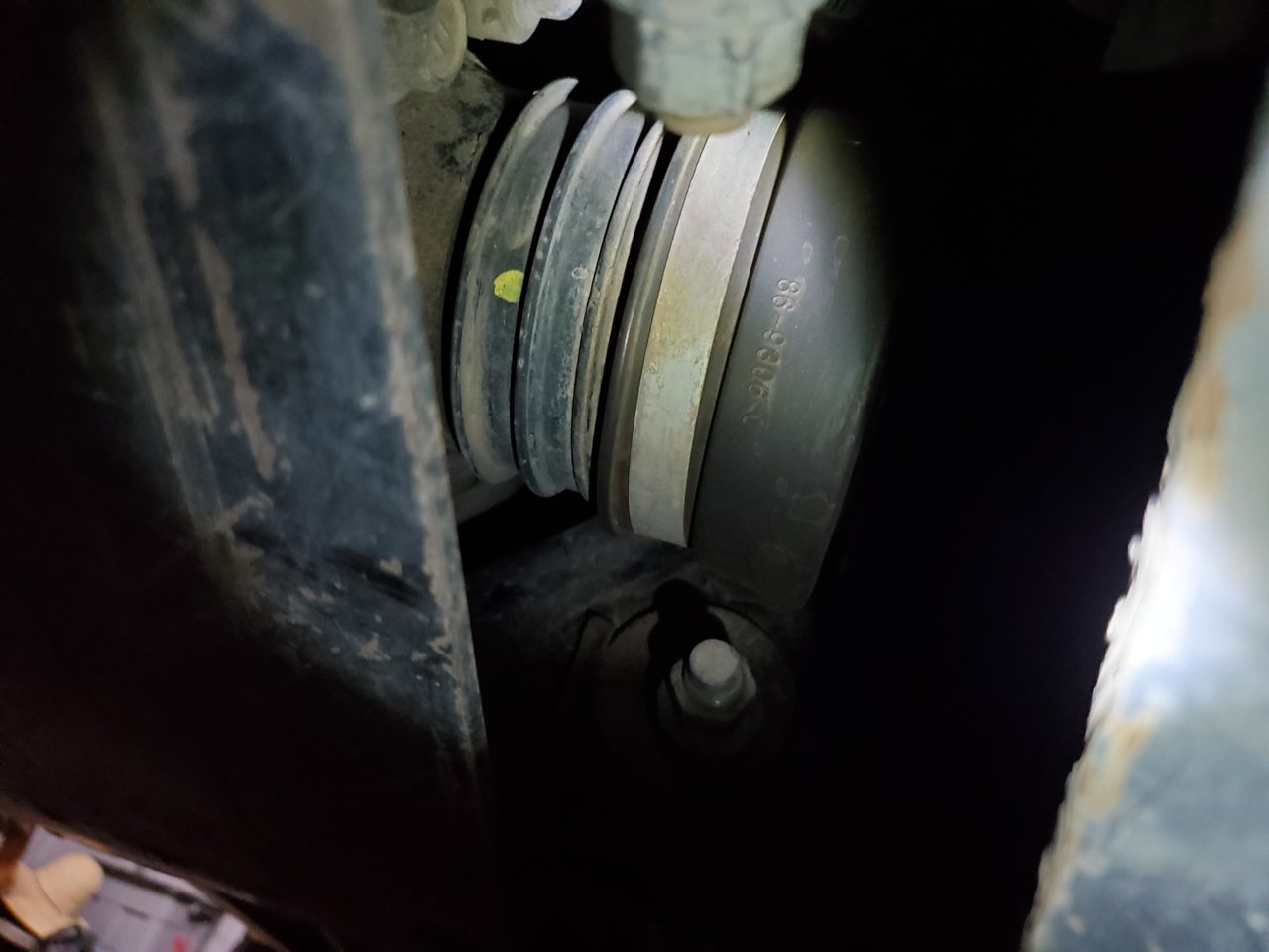

    I have a spare Tundra axle I bought as a spare from the recycling yard. It is not the same as a factory axle (changed out by that vehicles owner unknowingly to me). I can't say where it actually came from, but you definitely need oem axles. I dont remember the exact details visible from the outside but it was obvious once inside. I can take a pic tomorrow if that helps.

    Oem inner. Notice the ribs. I believe the aftermarket replacement had big divots running perpendicular to these (tri pod/worse)
    Also, the inners are very easy to remove and reboot, just a simple c clip you can get at. The outers are more of a pita.

    Looks like you got a tacoma tulip plunge end on your tundra shaft.
    I've gotten a few reman specials that are the opposite.
