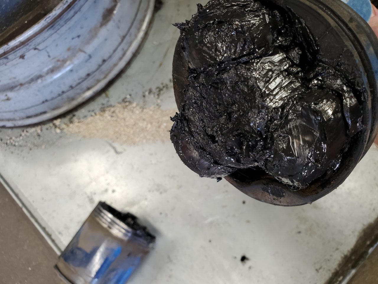

    You are still not cleaning out and inspecting the star and balls. Personally I still would want to completely dismantle it, clean, inspect, and pack it properly with grease prior to re-install.

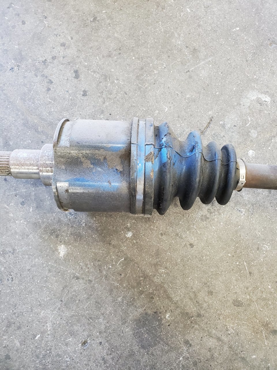

    This is the aftermarket tripod tundra inner. 20201119_100407.jpg 20201119_100901.jpg 20201119_100911.jpg 20201119_100920.jpg

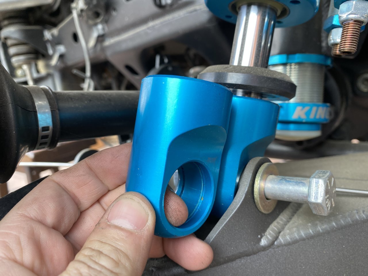

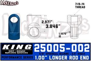

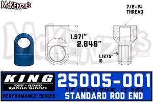

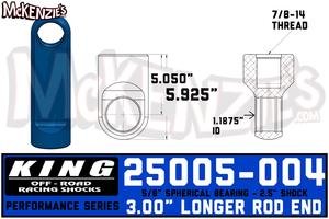

    Can anyone tell me if these are the +3” rod ends?
    Just got my coilovers back from accutune so I can finally start putting my dirt designs kit on and I still have tons of room to go up on the UCA and have 2” to the factory bump mount. I know steve had talked about +1” rod ends but not sure if that’s only gonna take an inch out of these or 2”. 2 seems like too much, also who stocks the rod end I would need? Thanks

    Performance series coilovers?

    that is exactly what I needed thanks! Yeah looking at that mine are +2’a so I need to order some +1’s tomorrow

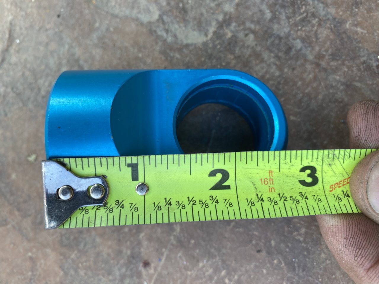

    look like they’re just under 4” to the center of the eyelet.

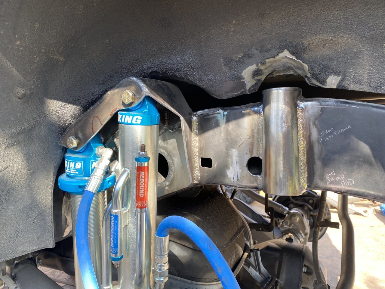

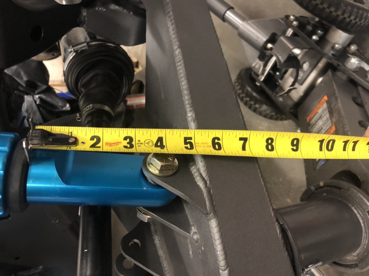

    I’m running standard rod ends on the front bypasses with my dirt designs kit. I just took a set of these standard rod ends off my rear bypasses....you sure you don’t want standard rod ends? Let me know and I’m sure we can work something out. These are new zero miles.

    just some minor clearance work and Some paint prep left on the rear. Progress is finally being made.

    How do you get them to clear the front axles with the spring cup on?

    oh nvm now I see you said it was your bypasses, which I can see would have a ton of room to the axle but for my coilovers It looks like I need the +1’s or the spring cup will hit the axle

    Ahh, yeah. The coilovers use plus ones.
