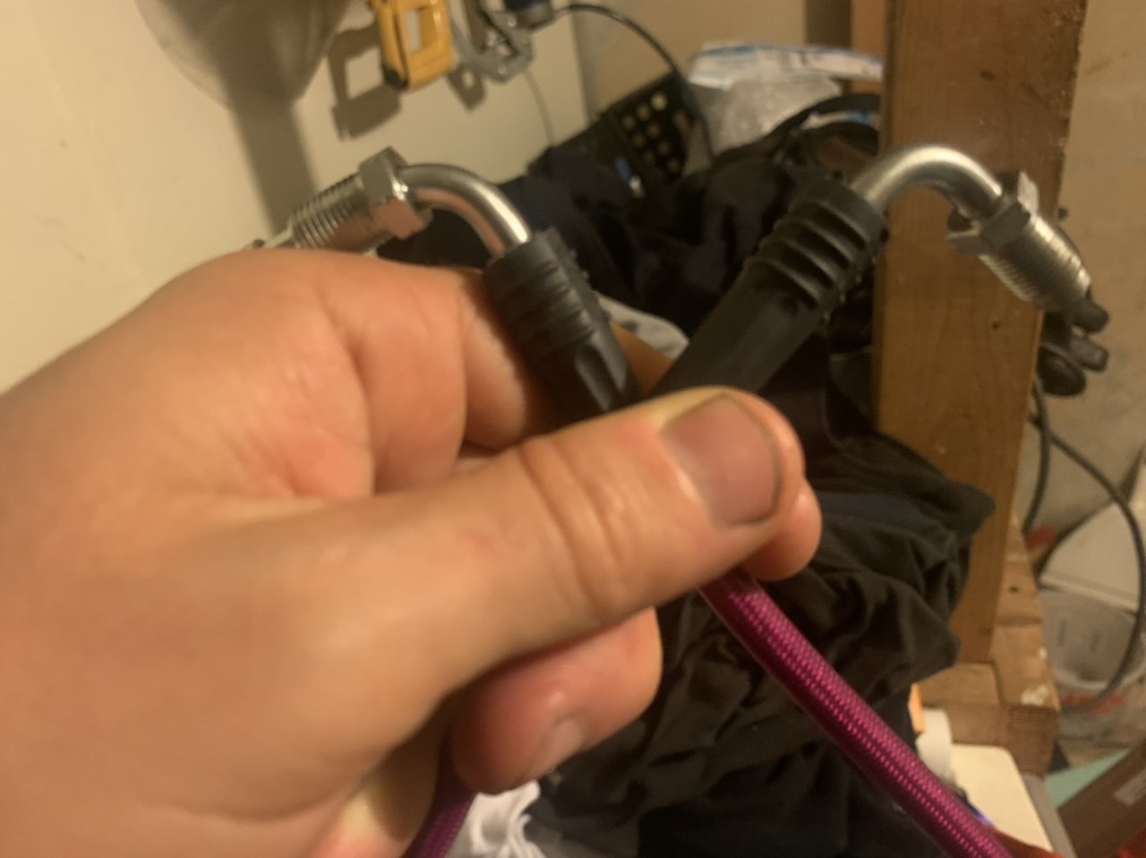

    whos everyone using for custom brake lines? the way i now have to route my lines won't work the factory way anymore so i'm gonna route them along the LCA. Does Crown do -AN ends on their lines or just inverted flare/banjos?

    yeah that’s kind of what I was thinking when you mentioned the xlt kit. I’d put $10k into something new with a V8 and linked since your leafs are probably what’s going to limit it eventually. FWIW @dirt addiction aka the_duhtchman IG ran big tires with the xlt and 8” front and made it work.
    Crown and similar shops make whatever you want - G and J aircraft make inverted flare 10 mm so I can go from the junction block to the caliper. Depends on what brakes you’re using - I’d imagine you have an upgrade for your V8’s extra power. If you’re sticking with Toyota brakes I’d avoid banjo bolts since some remanned calipers don’t accept them in the case of having to get a last minute replacement if one seizes or something.

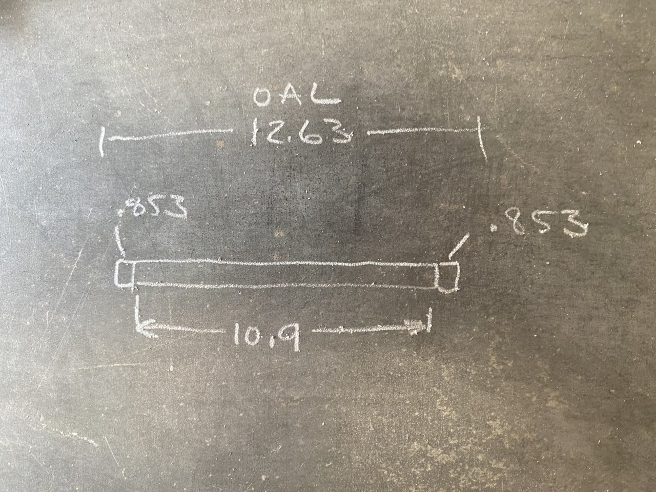

    Hey...what's the length of the rod on your heim tie rods? I just ordered a set from Kartek...just curious. Are you running +3.5"LT?
    Thanks!

    Workbench image. Here’s what I came up with using ballistic fab tube adapters and FK 3/4” rod ends with jam nuts. The overall length is what you would use if you bought threaded tubes. Yes this is for a plus 3.5” LT kit with Camburg inner clevis mounts.

    Awesome! Thanks! I'm running +2LT...have the camburg inner clevis mounts, 3/4 inner and 7/8 outer. Measured and measured...I think I will be good.
    Appreciate your time!

    It’s pretty easy, mock up the heims on the inner and outer. With the hubs pointed straightish and the jam nuts centered in the threads, measure the distance between the nuts. Then measure the passenger’s side. Average the two measurements and that should’ve be your starting point.

    mine are 12.5” from threaded face to threaded face

    I’ve just got 5th gen 4runner brakes for now. Trying to figure out this line Routing thru travel is giving me a headache...lol trying to do it off the lca but having a tough time trying to figure out where to attach it where it won’t run or bind during travel and turn.... not the easiest I will say...
