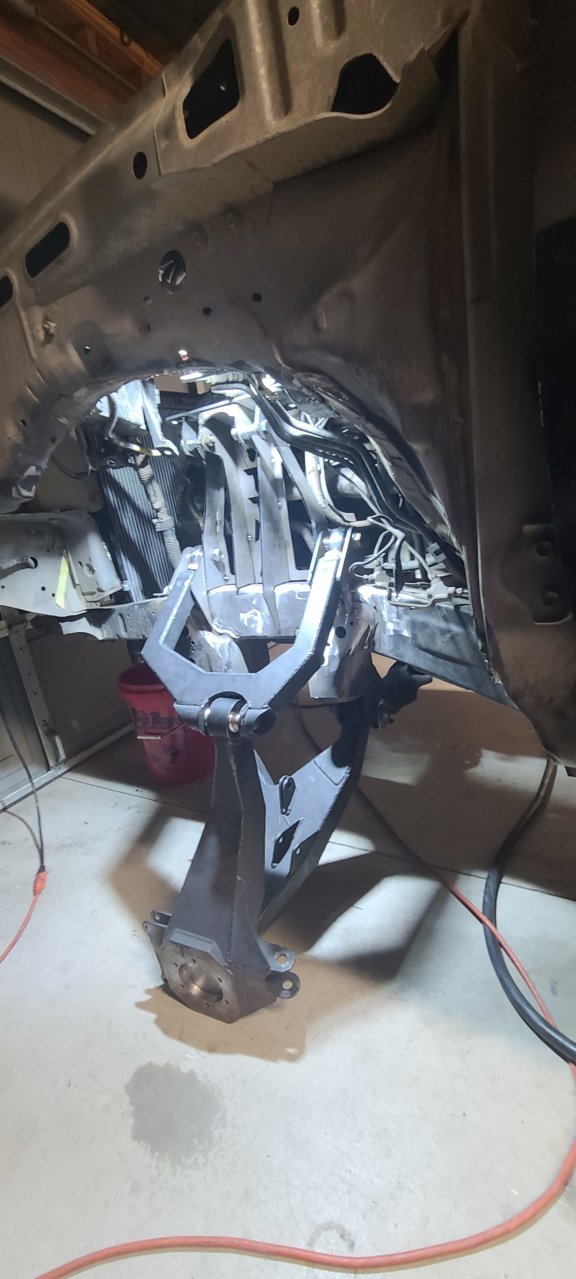

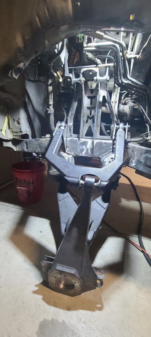

    Yea it was on Tommy's rolled long weenie. Just ordered new shock towers.
    Got the driverside mocked up

    you get the driver lower straightened out?

    The lca went right up with no problems so I set the spindle at 90° and set the uca mounts. The upper mounts are about 1" forward from the reference points Tommy says in his YouTube video.
    Once I get the passenger side mocked up ill be able to see how far off the driver side is. The passenger side was actually difficult to get on when mounted it up to get towed.

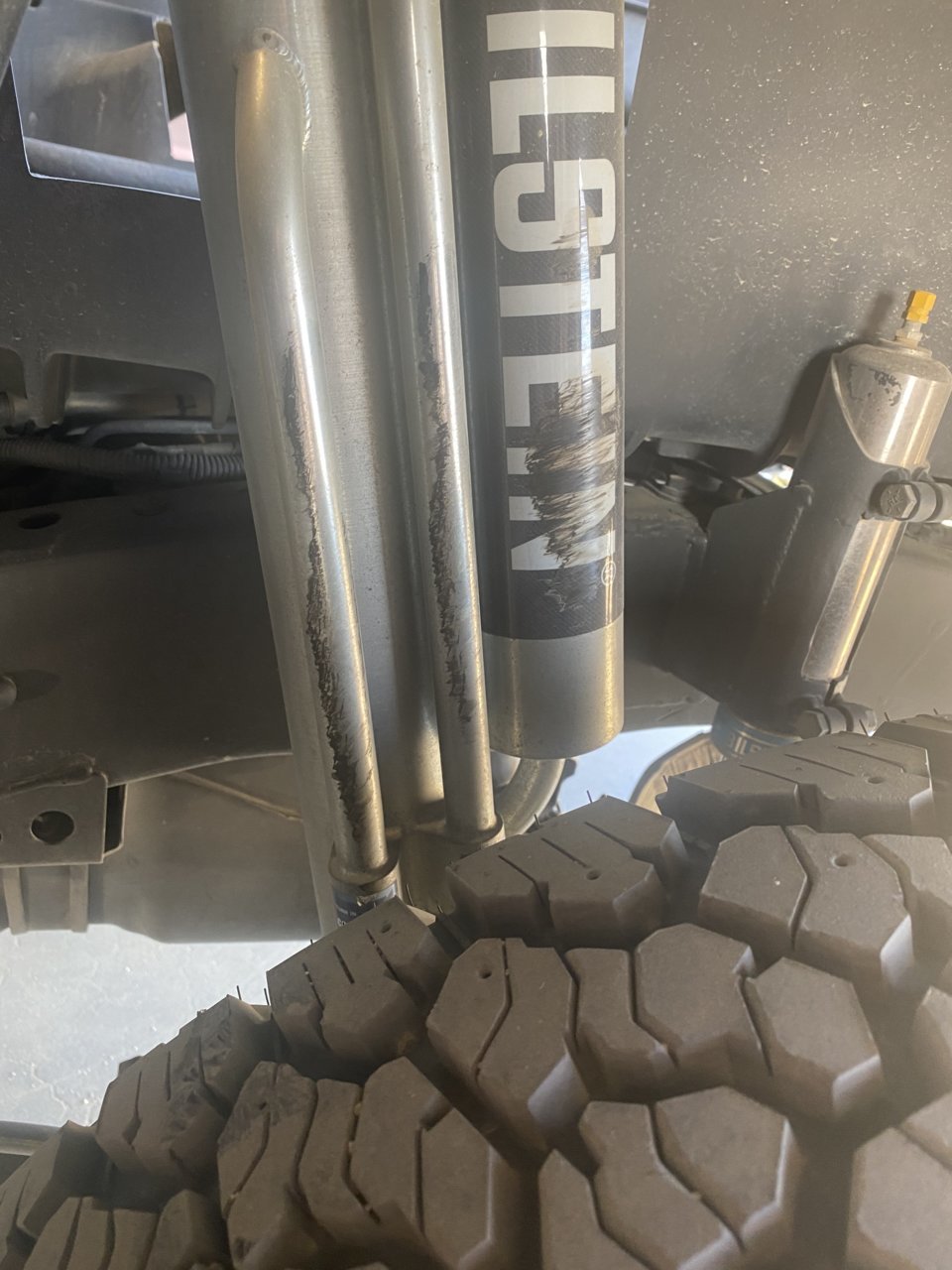

    Anyone else run into the same issue? 33x12.5 hitting the shock body? Already running bora 1.5 wheel spacers. Don’t really want to put 2” wheel spacers on the truck plus can’t move the shock tabs over because it going to hit the frame. Only air down to 20psi going to try 25 psi next time see if it change s anything.

    Most use a custom layout to avoid this. Looks like your tubes are right where they shouldn't be.

    Very common with that tube layout. Tire pressure won’t change things since it’s the top of the tire hitting the shock. Not much you can do other than run wider spacers or wheels with different back spacing. Or get shocks with the bypass tubes on the front and back of the shock vs side.

    No difference running wider spacers. 1/2” of aluminum won’t affect the performance of your truck - hopefully it’ll keep you from rubbing.

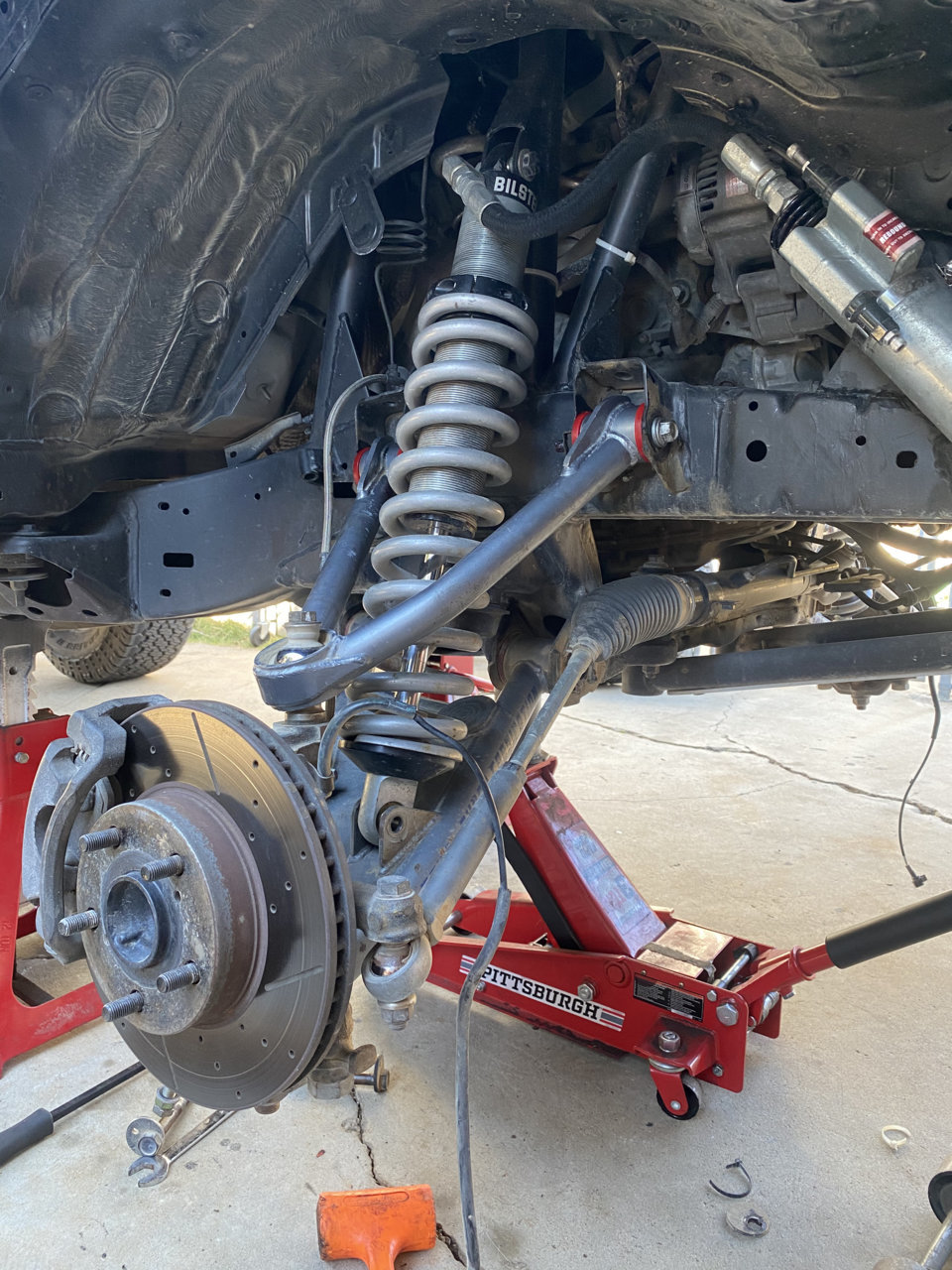

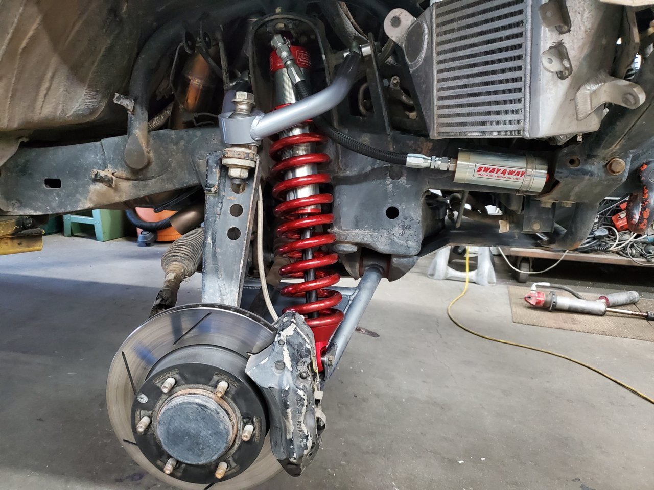

    I finally got around to putting new Saw's on along with heimed uppers. Still need to cut and move the bypass mounts so one of the tubes clears the upper arm. Progress!

    New arms or convert old ones?

    Just ordered new ones, much easier that way.

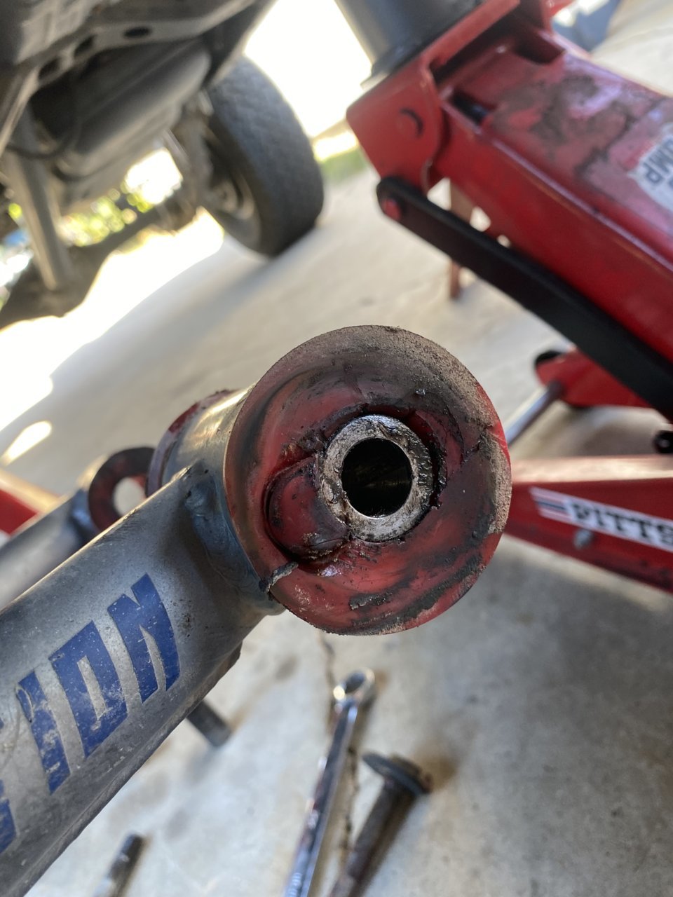

    Installed some new Polyurethane bushings. Definitely need them! Before news years trip.
