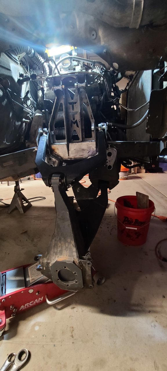

    20201221_182942.jpg passanger side fitted up

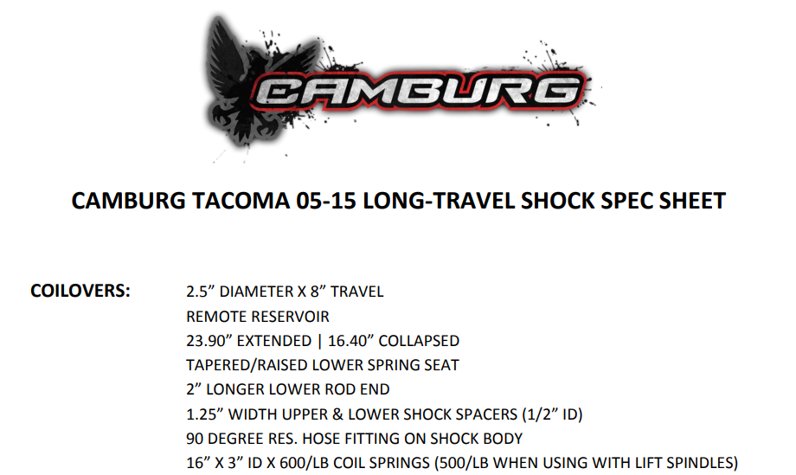

    Did you get anything else when you put the 18” spring on the coilovers?

    Can you please be more specific? Like in terms of damping, height, ride quality, etc.? I am sorry, I don't fully understand your question.

    Did you have to get a flat spring plate to swap out the raised one that comes normally?

    No, my coilover configuration did not change when I swapped springs. No change or addition needed.

    Thanks for that info, I just ordered 18” coils

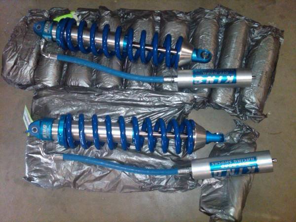

    It you’re ordering for your 01 with a 3.5 kit they won’t necessarily have the same shock package as 2nd gens, they should look like these:
