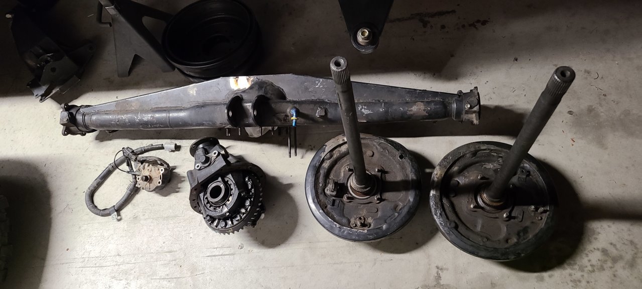

    Anyone heard of Dusty Motorsports?
    I picked this up from a guy off FB n turns out it was a side business he is part of. Had a nice 5 lug he was in the process of doing full cage and 3 link.
    it's 53" wide, truss, 4.10s and Elocker

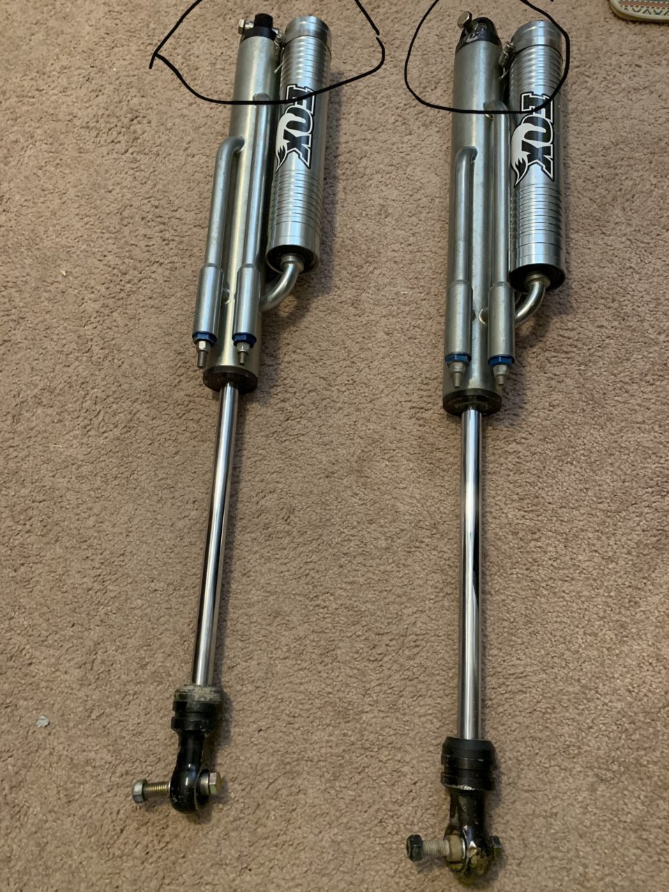

    Anyone rotate fox top caps before? Running into clearance issues and realizing the top cap on one of the bypasses is different from the other causing most my issues as one bypass works on both sides and one doesn’t work on neither.

    Yeah, it's easy. Release the nitrogen pressure from the shock and loosen the allen bolts on the top hat a bit. Might not be a bad idea to throw some blue loctite on them once you have the body cap oriented the way you desire.

    HUH? That's not right. There are no allen bolts holding the top hat on.

    Maybe not on those after looking at how old they are. The newer stuff has a rotatable body cap with allen bolts.

    good deal there, looks fun. What u gonna do with the 6 lug rear after slapping that together?

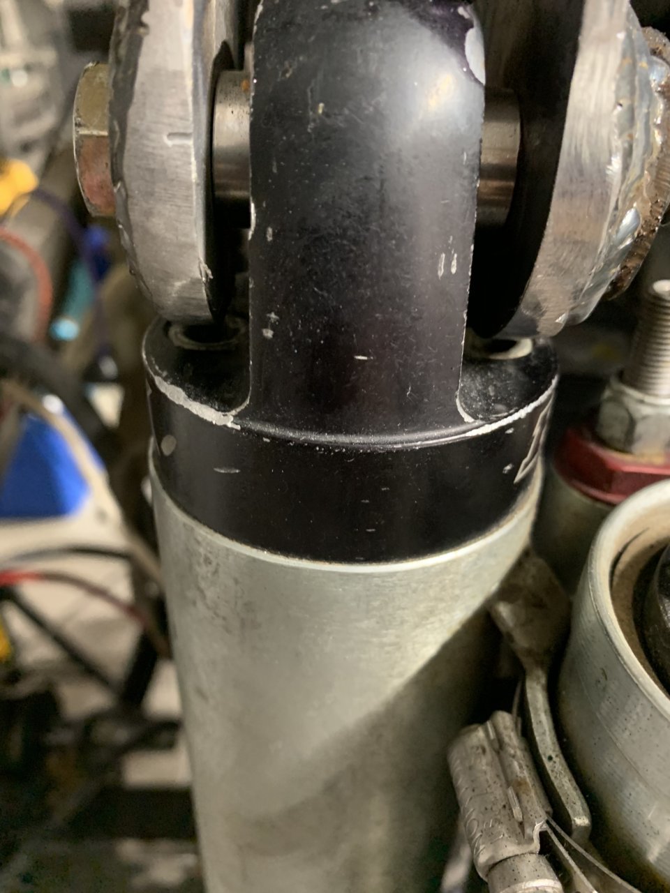

    these do. Two allen head bolts on top.
    Hard to see with the mount btu I’ll post a better picture later.
    thanks. See if I can get them to rotate today.

    Yup, those be them. I've heard people do it without releasing the nitrogen but the shock will be pressurized so it may be difficult. If it were me, I'd probably reduce the nitrogen pressure a bit but not completely to retain the seal. Keep us posted! :thumbsup:

    Already let the nitrogen out so I could set them and cycle suspension so no big deal
