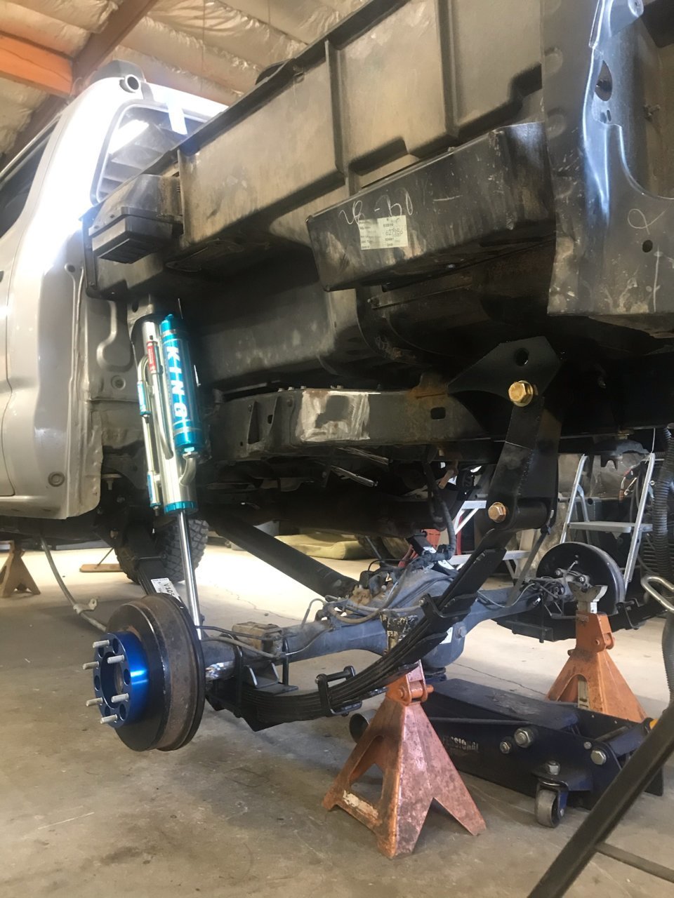

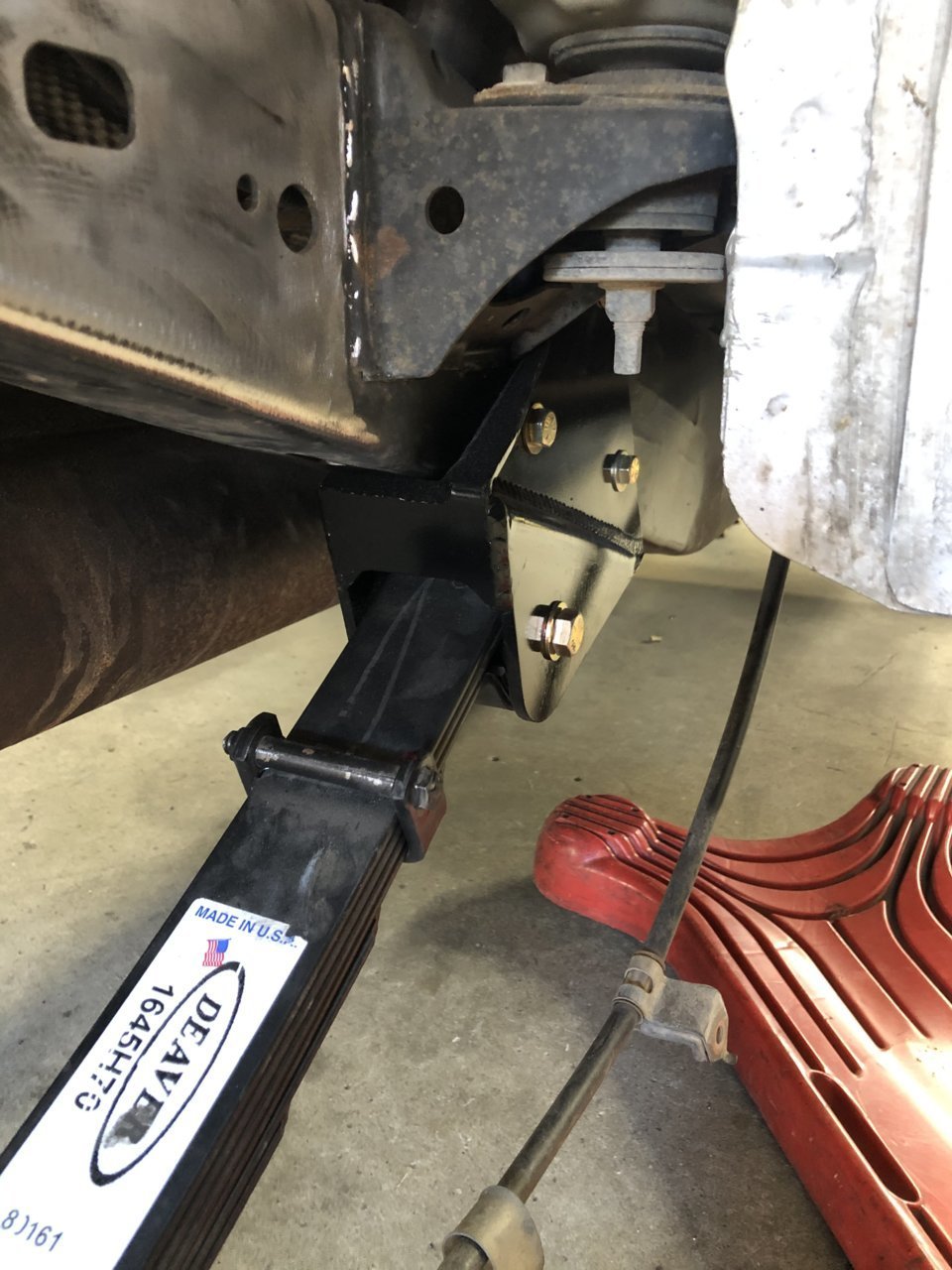

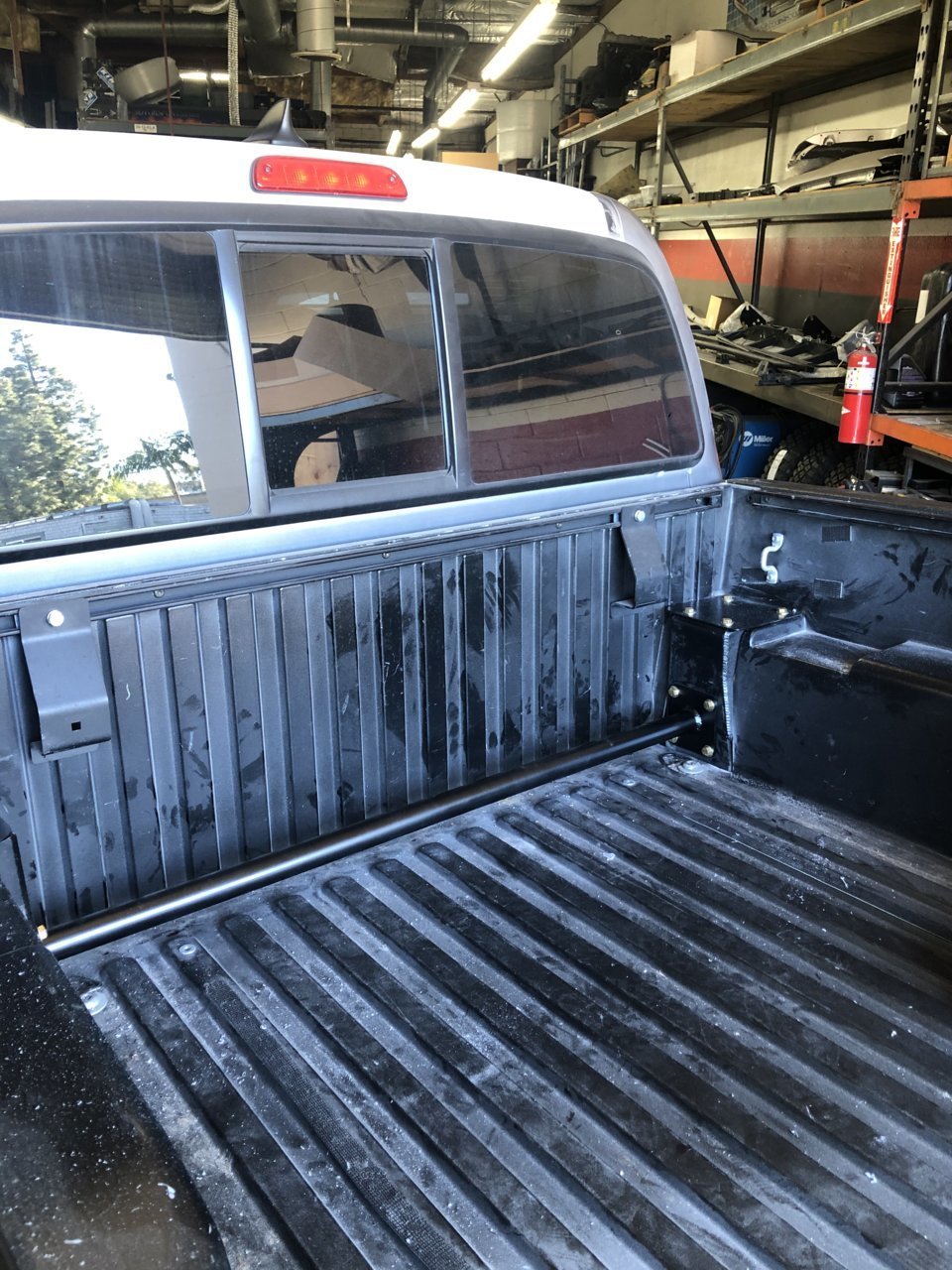

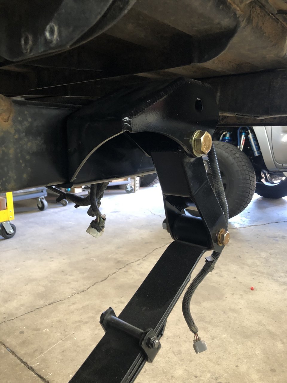

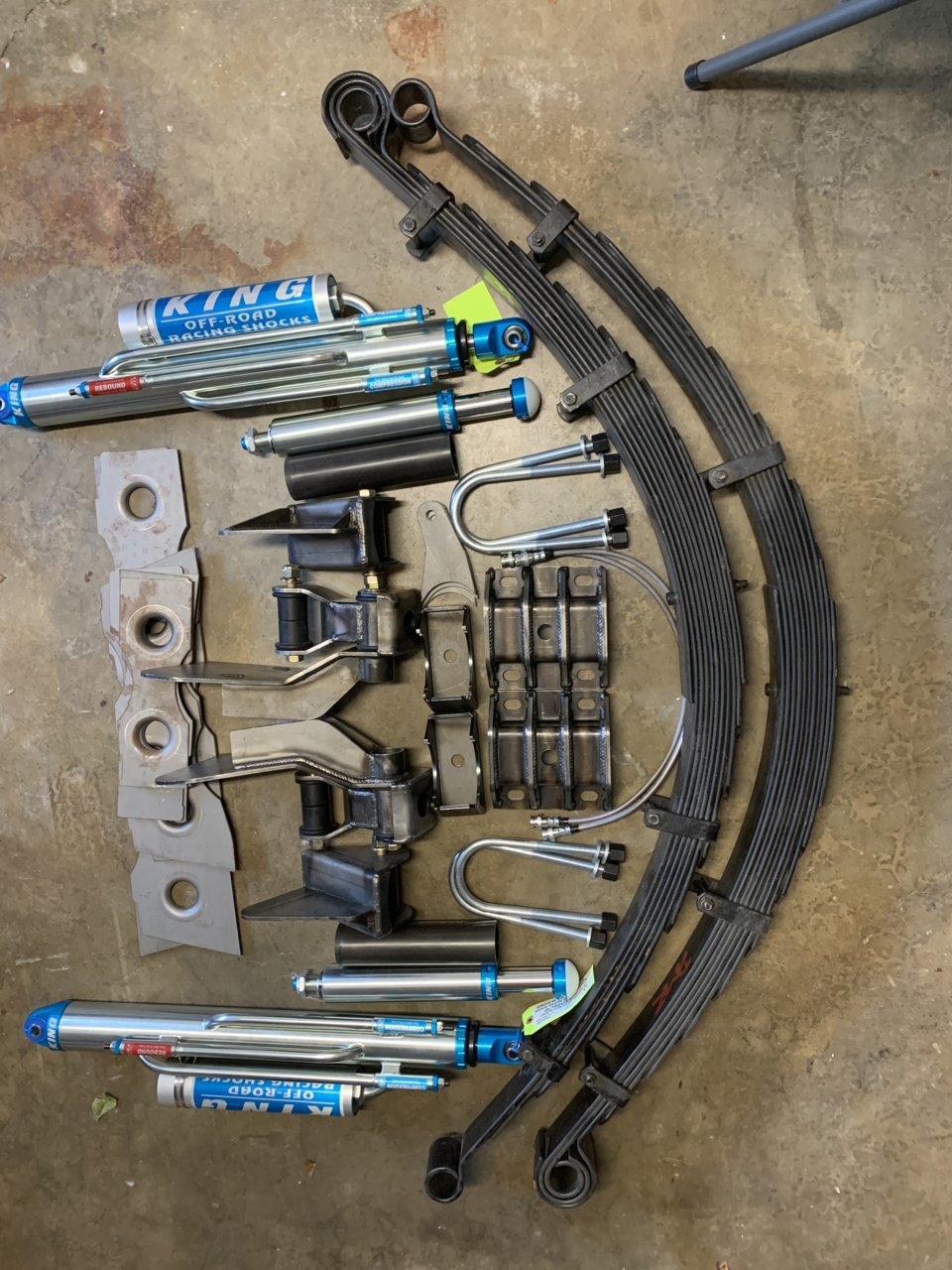

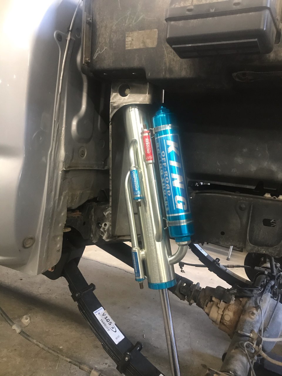

    I’m getting JD fab’s kit. It’s 17”-19” of travel depending on if you notch the frame and every thing is bolt on except the shock mounts and the spring perch. It also is adjustable with ride height and spring rate. I ordered same shocks in the picture king 3.0 triple bypasses with anodized reservoirs.
    F97C0B99-E991-452B-AD8B-C4278B215F1D.jpgF0DF80A4-A65A-4DC4-AEC6-6901963D19C1.jpg05414D77-76F5-4220-BA06-3E904279E9D9.jpgDF7D146A-4D99-4053-8E7B-BEB00659DC38.jpgE03EFFDF-3B05-44A0-B58D-4A0158A4A28C.jpg
