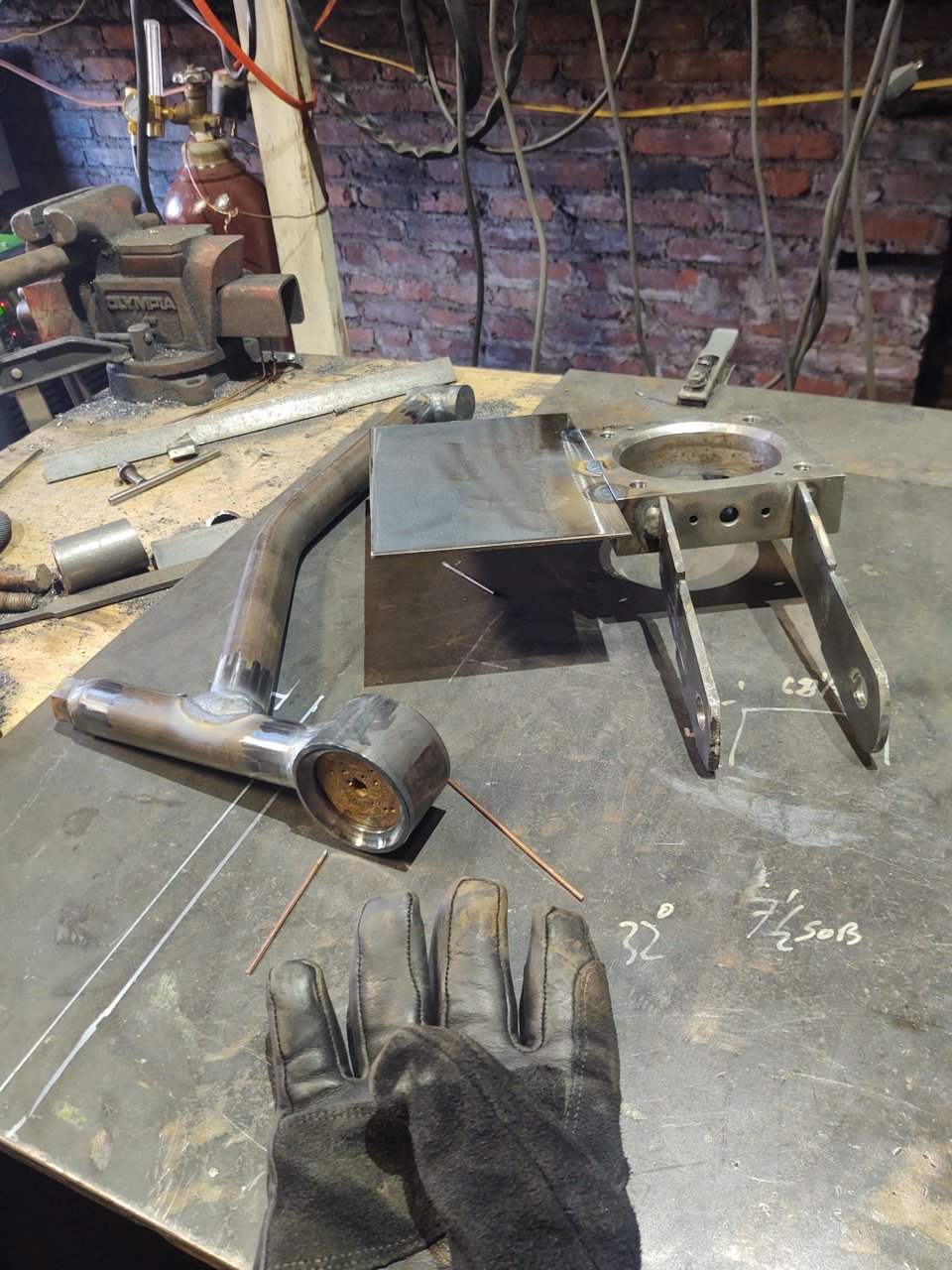

    More progress pics of my +4 kit from @81Trekker at JD Fab :
    In this pic you can see the new bypass hoops, new double shear kit, LCA tab kit and as an added touch they are grinding off the OE Dana chassis welds in a couple of spots and correcting them. In addition to chopping off the low hanging front bumper cross member he is strengthening the entire front of the frame to properly support winching. First step was to plate the front crumple zone :
    Here you can see that the whole lower portion of the CBI bumper has been chopped off to match the front frame chop. It will be re plated to match and integrate with the new skid plate that ties into the JD Fab LCA tab kit :
    Here you can see the strengthening plate, next the OE bumper mounts will be chopped off and a new front crossmember will be installed so that the bumper will have double the mounting points as the OE set up and all with grade 8 hardware. You can also see where he has strengthened the core support mount :

    Looks to be all quality. Kudos to them for going the extra mile to design these parts, and the execution is looking great on your truck!
