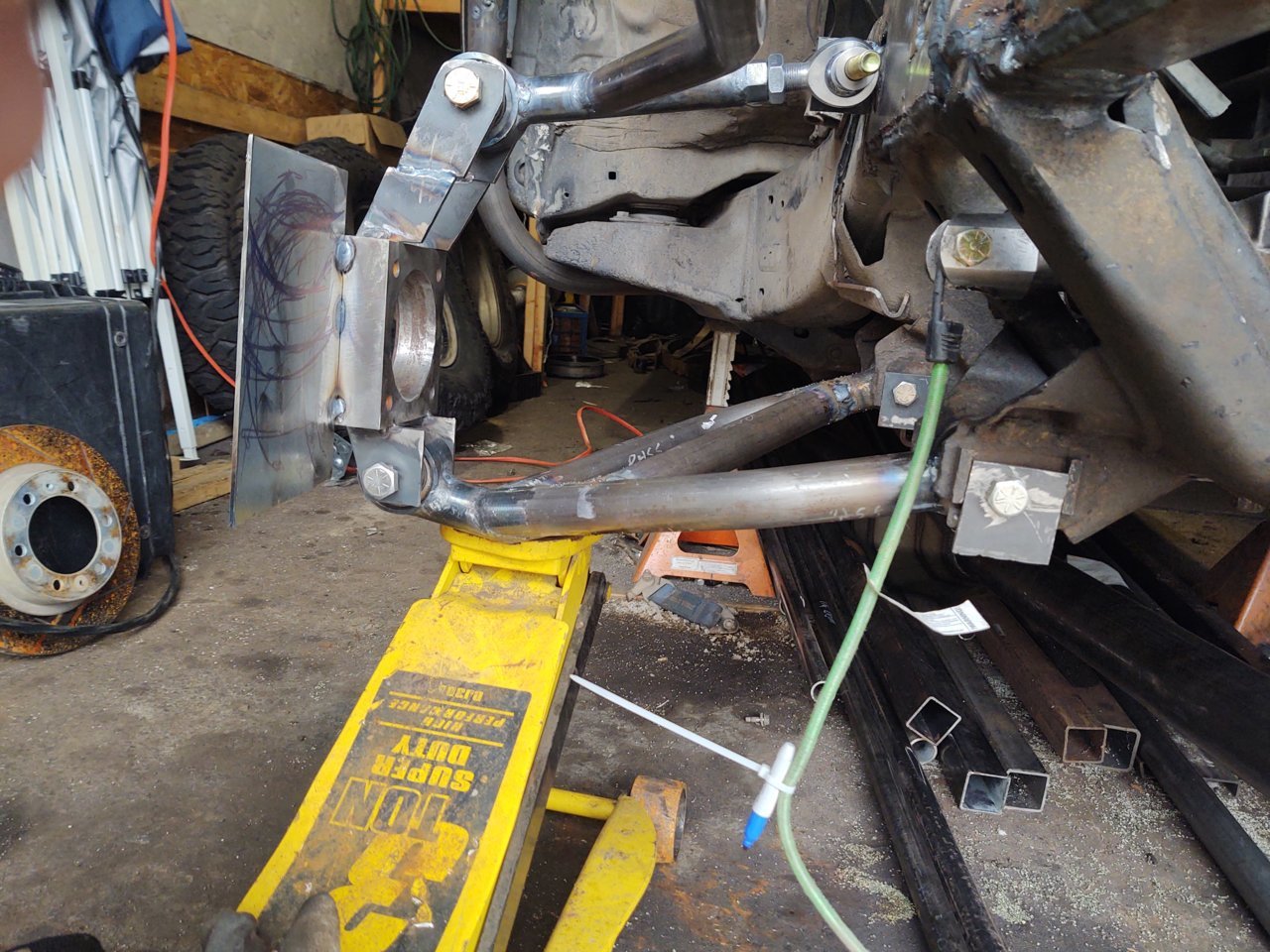

    @snowsk8air2 it was @Basikbiker who had the trick I was thinking of.
  2. Jan 29, 2021 at 6:38 AM
    Arcticelf
    Arcticelf Well-Known Member
    Jul 18, 2015
    #159735
    7,662
    Gladiator
    Yup, that's phase 2, so I can maximize the turning radius at the same time.
    My last custom knuckle I traded too much turning radius for lower steering effort, and ended up with a turning circle similar to an Aircraft carrier.

    Put a steering box on that thing already and throw the rack in the trash where it belongs. If you ditch the AC compressor a Saginaw box fits perfect. Then you can reduce the steering effort through the pitman arm with keeping the spindle steering arms short and strong
    ovrlndkull and Arcticelf[QUOTED] like this.

    Next time the rack fails that's the plan. I've already upgraded it to a tundra rack, but it's still not enough.

    I'm pretty sure I bent the frame a little when I blew all the seals out of my trundra rack. I know I fucked up the LCA mounts on the frame pretty good with that hit.
    Given how my initial attempt at measuring for steering pickups on this setup went maybe I'm doing a steering box sooner than later.

    Mount that upper on top of the frame and you will have a lot less camber change as it cycles

    I played with that, but the Instant Center goes crazy, and the scrub radius ends up sucking (because of the packaging constraints on the wheel driving the spindle geometry).
    There's a bunch of reasons no one makes a short-arm long-travel setup for these trucks, and I'm learning many of them. Going +4 and just accepting that I won't fit on some trails would definitely have been easier.

    So that plate with the scribbles...turn it 90 and draw your arcs on it

    Does it matter how close the plate is to the actual centerline of the steering pivot (distance forward of the axle)?

    Realistically no
