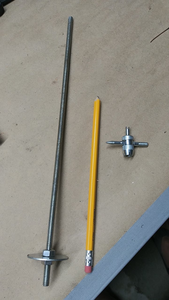

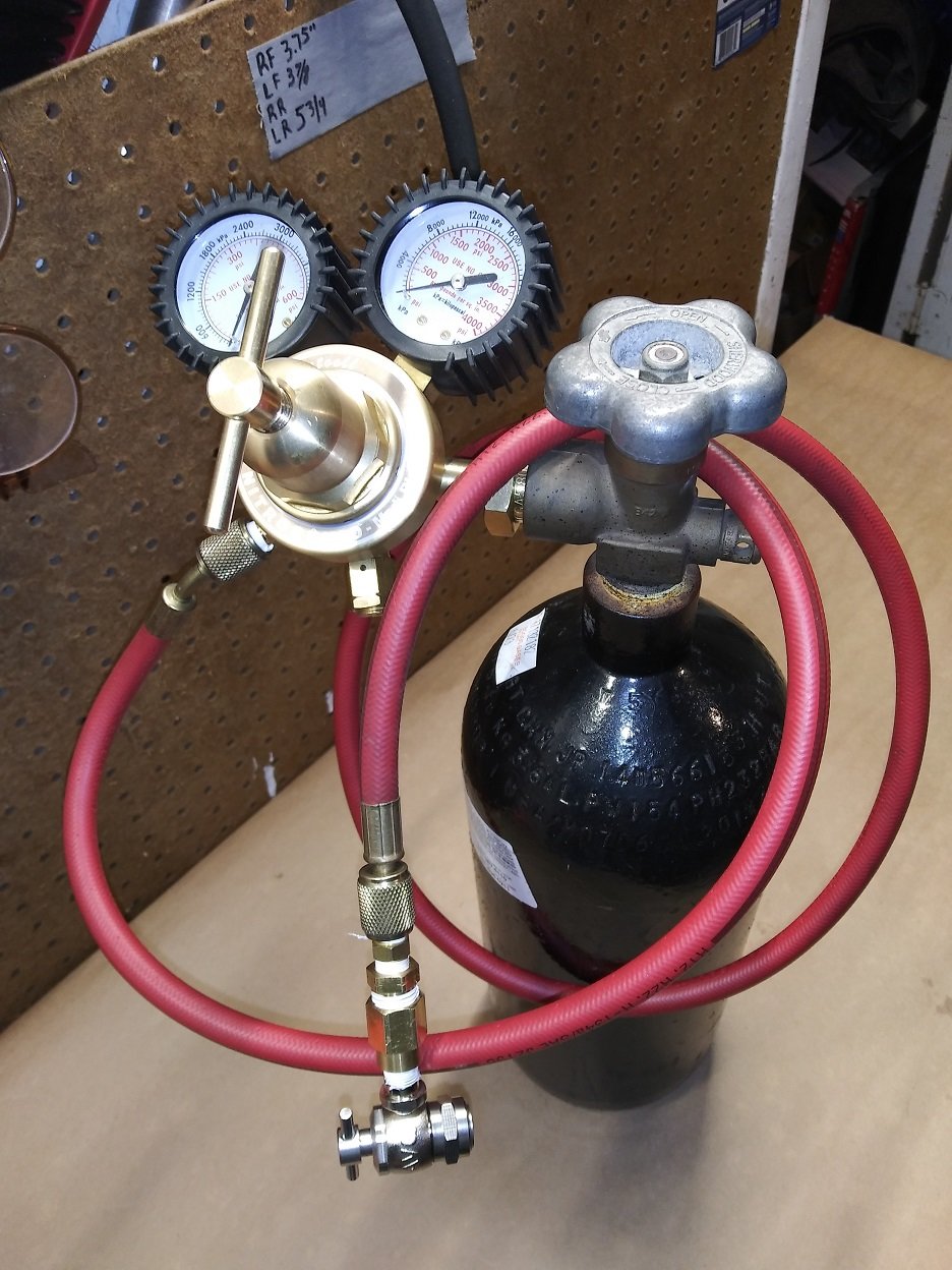

    I put together an all-thread tool for pushing/pulling the IFP when bleeding air out of the res. Also bought a cheap schrader valve tool. Then built a Nitrogen rig with a "no loss chuck", instead of buying one of the more expensive ones on line. With the small bottle I can extend the shocks to full droop while still on the truck and check my pressures periodically.

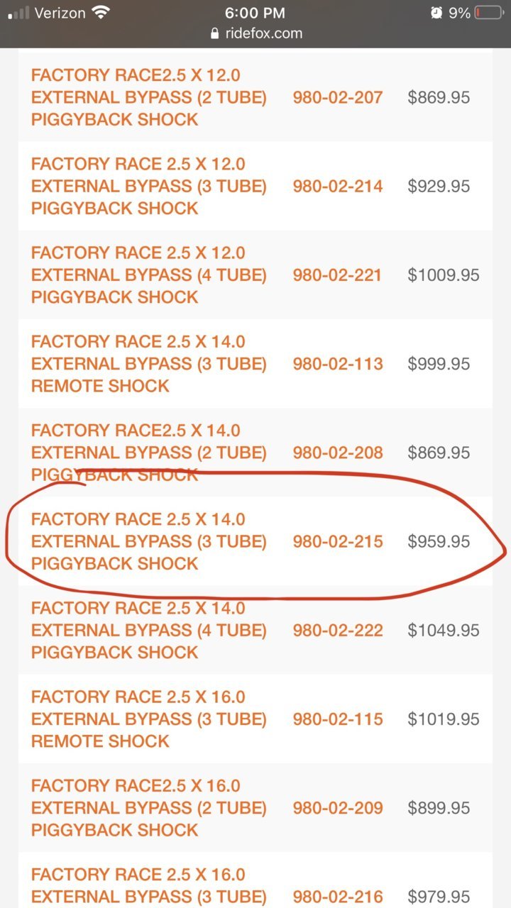

    what’s the length? Do you have a picture? My guess is it’s a standard length Fox eyelet. Part #: 213-01-235-A

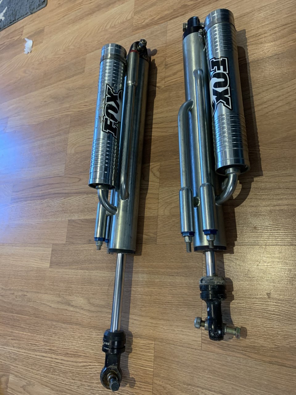

    Part numbers don’t return to foxes website cause they’re older. 2.5x14 triples though. 28AB9D79-B3E4-4277-A361-420C28D1AE30.jpg

    The eyelet part # I gave you is correct. They’re 2.95” from eyelet center to top of the eyelet where the shaft enters. Their are different lengths if you need to change your ext/collapsed though. Why are you changing the eyelets?
    The shock part # is 980-02-215. Doesn’t matter the age. You’re bearing cap probably has XXX-215-A on it I’m assuming?
