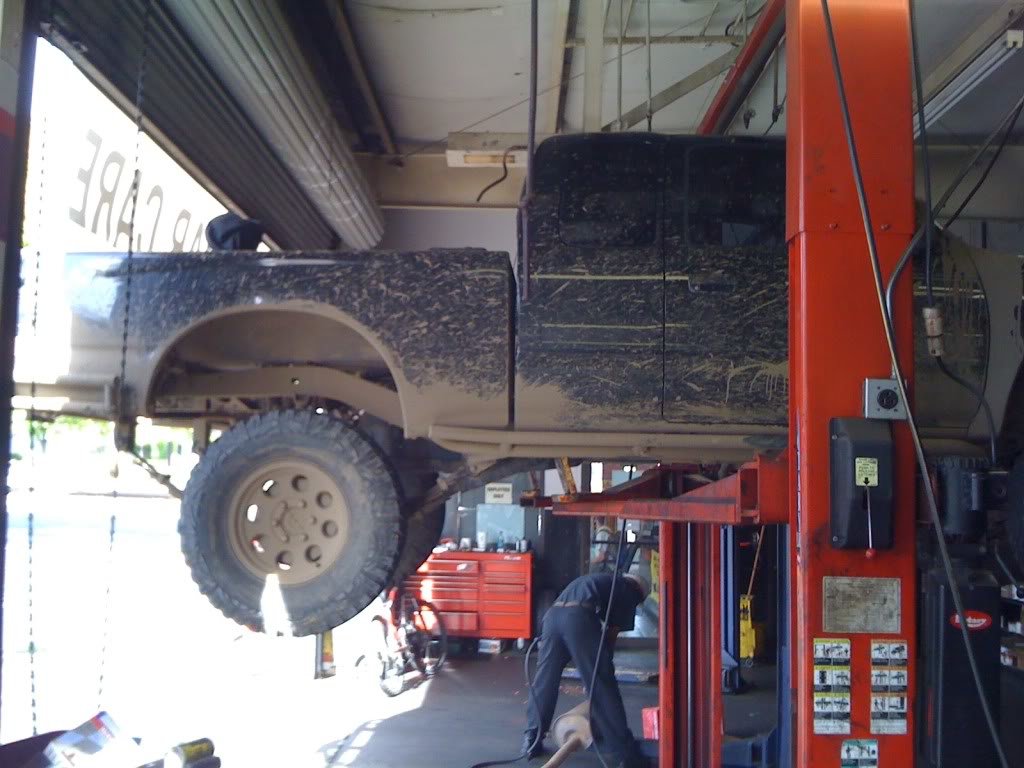

    Alright now I'm really confused. I measured center of the bolt of the hanger mount to the center of the bolt on the shackle mount, strait line, and it's at 56.5" :eek:
    Giant did the entire rear of this truck. I actually have the invoice from the previous owner.
    On a separate note, does anyone know what the spring hanger and shackle bolts should be torqued to?
  6. Nov 17, 2011 at 5:58 PM
    #8326
    Cr250jumper
    Cr250jumper Señor member
    Dec 2, 2010
    #47033
    11,968
    The moon
    50 shades of tan©
    Tacoma with some stuff melted to it
    Just realized when you said this, that is why you dont need limit straps. If the mounts are farther apart the springs cant droop as much. What does your shackle look like at full droop?

    It's almost perfectly verticle. Maybe 1-2* shy of verticle.
    EDIT: pic
  8. Nov 17, 2011 at 6:07 PM
    #8328
    Cr250jumper
    Dec 2, 2010
    #47033
    11,968
    The moon
    50 shades of tan©
    Angled to the back or the front? Are you sure you dont have the bigger leaf pack? the 64's is it??

    Slightly angled to the back of the truck. And yes I'm sure it's the 62", it has the f67 sticker on it still. :D
