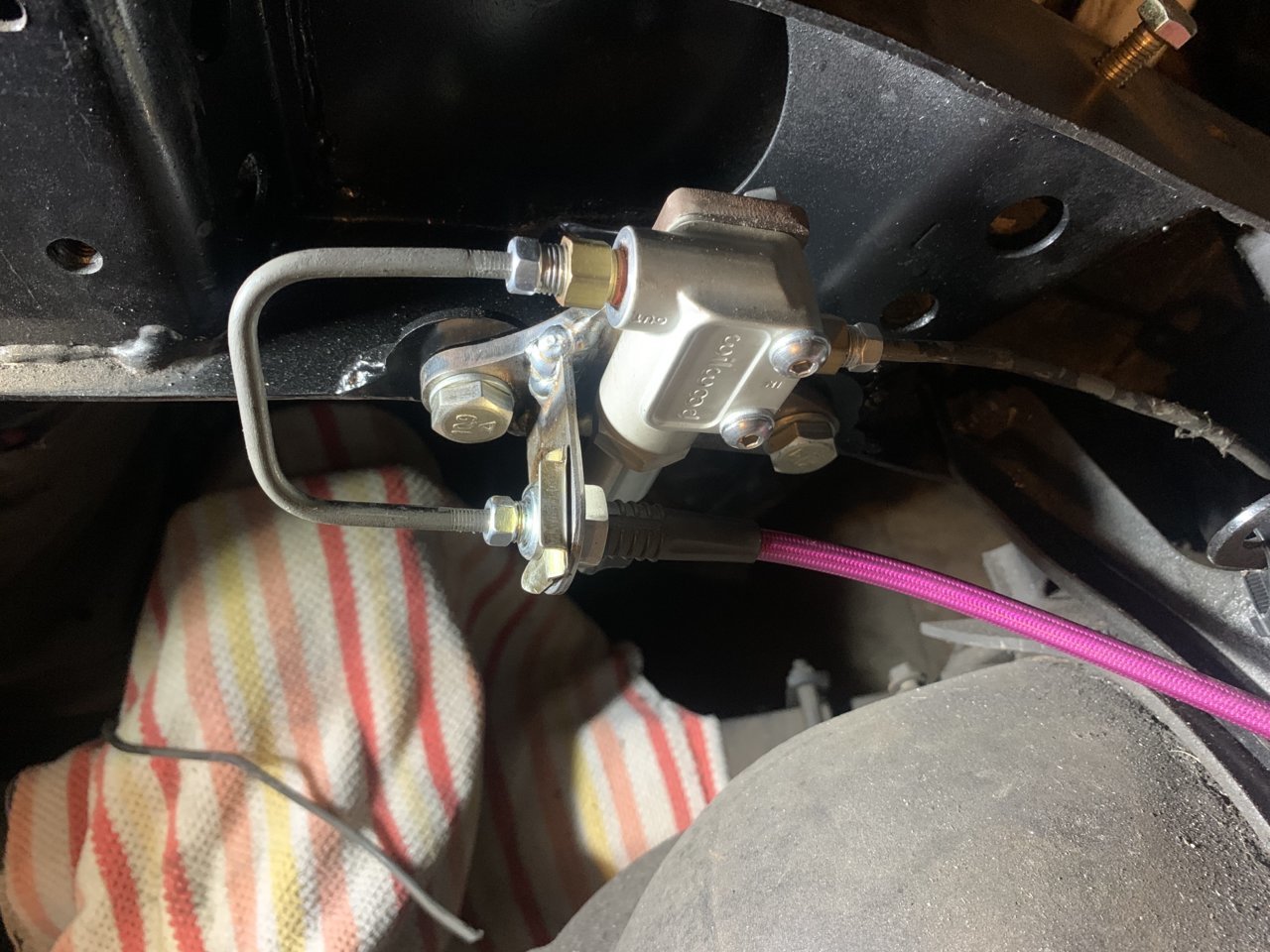

    Hey guys so my taco is finally getting close... can you guys give me a link or some info on what rear brake proportioning valve you guys run on the 1st gens? Need one ASAP!

    I have one of the ones with the knob style valve:
    https://www.wilwood.com/mastercylinders/MasterCylinderValves
    I put it next to the filler neck under the bed but I may relocate it to under the hood. You’ll need to reflare the hardlines with a 3/8 fitting like I did (had to do a bunch of hard lines in that size so I didn’t mind). They make another one with 10mm x 1mm that fits your stock line fittings.
