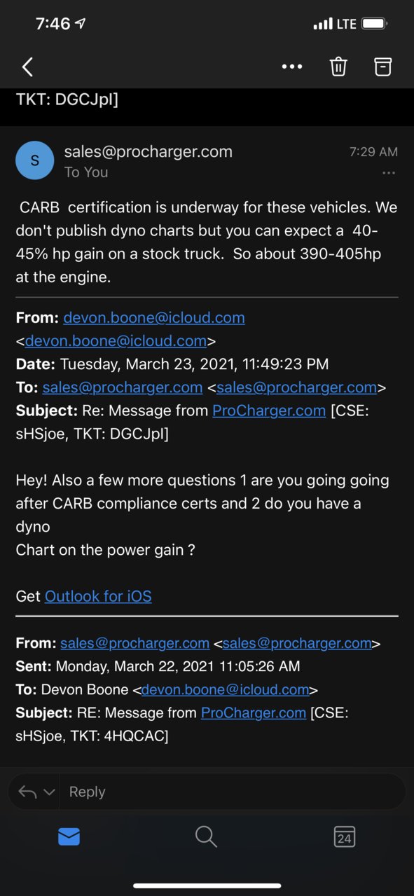

    So they’re saying 40-45% over stock but don’t wanna show dyno charts. That’s like me saying my Tacoma is 450hp to the wheel and not showing dyno proof :thumbsup:

    That's like getting married to someone that had risky behaviors and won't take a STD test.

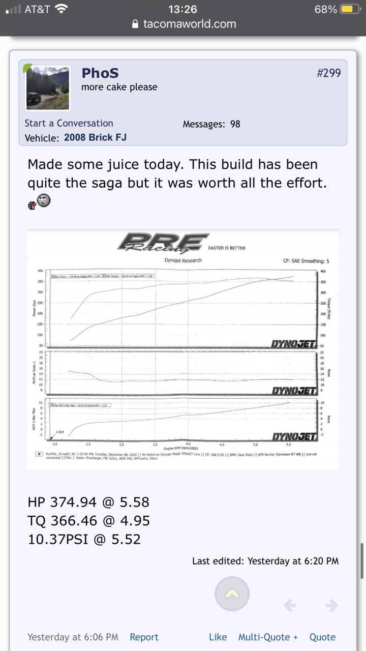

    @PhoS made these numbers a bit ago with the pro charger, not sure what all he has done to the engine though.

    yeah 375 on a stock motor with just the charger would be impressive but probably not reliable...lol

    Besides supporting mods just headers/exhaust.
    Why not? Plenty of people have been pushing 10psi for years.
