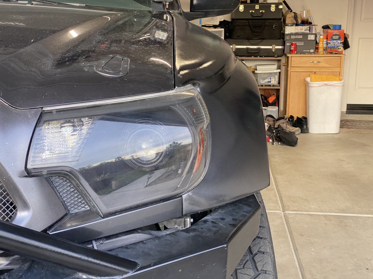

    What was the method you used to put the hole in the hood?

    Hole saw

    I just printed out the aerocatch installation instructions and it they provide a nice template that prints out to scale with the center points marked for a 1 1/4" and 1 3/4" hole saw
    edit - @Airdog posted that pic while I was typing this
